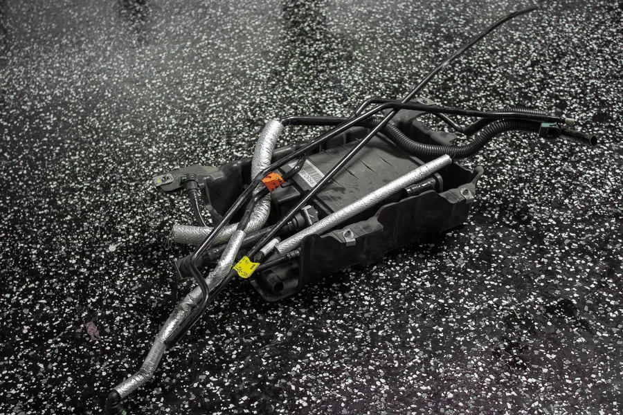

There's a vacuum line that runs down the length of the car on teh drivers side to the fuel tank/charcoal canister. Wonder if you pinched that?
I didn't take any pics of mine during my EVAP delete, but follow the black tube from this thin behind the diff. Those long black tubes that I cut in half are the vacuum tubes running from the engine.
