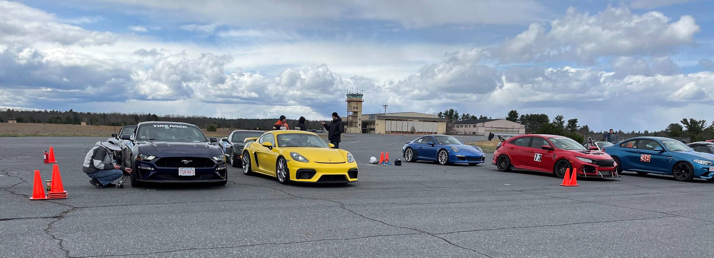

Well, I had my first autocross since graduating to CAM. I ended up about 1.1 seconds back from FTD on a 60 second course. It was actually SNOWING at times, anyone not on Yokos had no chance of success including sticker A7s.
Here is one of my runs where the snow starts to pick up after ~30 seconds:
220220417 BMWCCA Sleet Autocross - YouTube
Something I have never experienced before and hope to never experience again.
And my fastest afternoon run:
220220417 BMWCCA Dana Fastest Afternoon - YouTube
I'm running 18x11 apex wheels, 275 yokos, GT350R springs, -4 front, -2 rear camber, a 35mm BMR front bar on full stiff and the Strano rear bar on full soft. The setup works, and I look forward to wider tires and reasonable temperatures to form a stronger opinion on the setup and consider any fine-tuning. I doubt it can catch AS in a fair fight, but it's a heck of a lot more satisfying to drive than the FS setup.
Random candid photo of me being very, very cold. I should have packed my ski clothes.:

Very nice. You look much smoother than me! The course sure seemed grippier than I would expect at that temp.
One thing I noticed, your throttle gauge (Or whatever you want to call it) only ever showed 89%. It might just be a minor calibration issue, or, you could have 11% more to give!

It looked like a lot easier & more fun to drive than your previous Street setup.

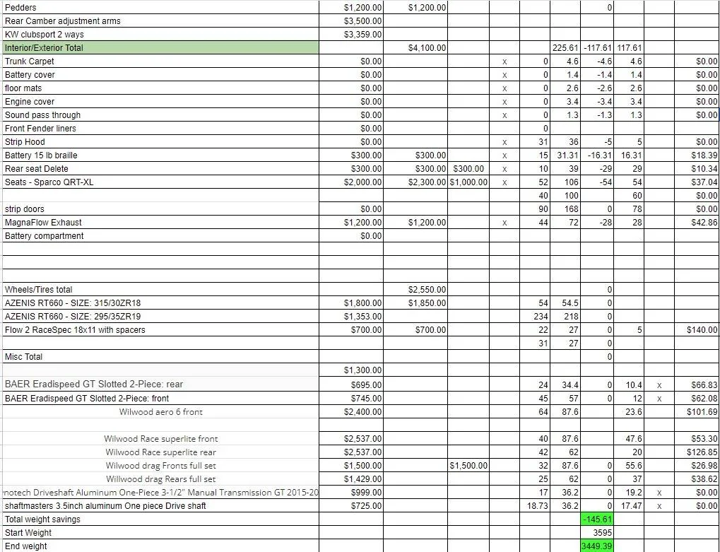

My spreadsheet looks like after the seats, I'll be at about 145lbs off. The sheet is kind of a mess right now. The rows I have an x in is what I've actually done and the calculation is applied. Forgot to finish applying the #'s for the fender liners which were 6 lbs. That puts it at 3443. Ballpark, as I've not added weight for the heavier parts I've added, which are likely, just the sway bars. I doubt the pedders weigh more, and quite likely weigh less, at least on the front.
The Wilwoods, are going to be too tantalizing at that much weight off. Just waiting for my deposit back from the place I just moved out of. Then, I think it's just working on the nut behind the wheel until the Pedders fall apart.
https://www.wilwood.com/BrakeKits/B...e=Ford&model=Mustang&option=GT+(except+GT350)
I'd get the Vented set, I imagine. That would put me into the 3300's. $1385 at Lethal Performance.
Although, you can get the calipers in custom colors if you get them from Wilwood. (Competition Orange calipers... sigh.)
I realize that those weights probably don't include the pads on that, unless they are included in the caliper weight.

3450 is nothing to sneeze at. If you can get there, you're doing good. The next 150# to get to CAM-C minimum is another matter. That would take a concerted effort.
You're not autocrossing, though, right?

I am. Had my first test and tune a couple weeks ago with NightmareMoon. We're in the same club. Have an event this weekend, and am signed up for the South Texas tour. I've been out since Nats in 2015, so I'm keeping my expectations low.
It looks like, if I throw another $1500 at it, I can get to 3390. The next 90, would get progressively more difficult, I think, but remember, I started with a base. I haven't had time to look at any of the ABS stuff people are talking about. I'm lazy, so easy things first. I have to change pads anyway, so that makes me lean towards doing the front brakes. Requires new braided lines as well.

May have missed it earlier - but have you weighed your car on an accurate scale ? Getting down to 33xx lb seems hard to believe with GT without some extreme measures. My car with almost same mods, lighter battery and fender liners still is barely under 3700 lb.

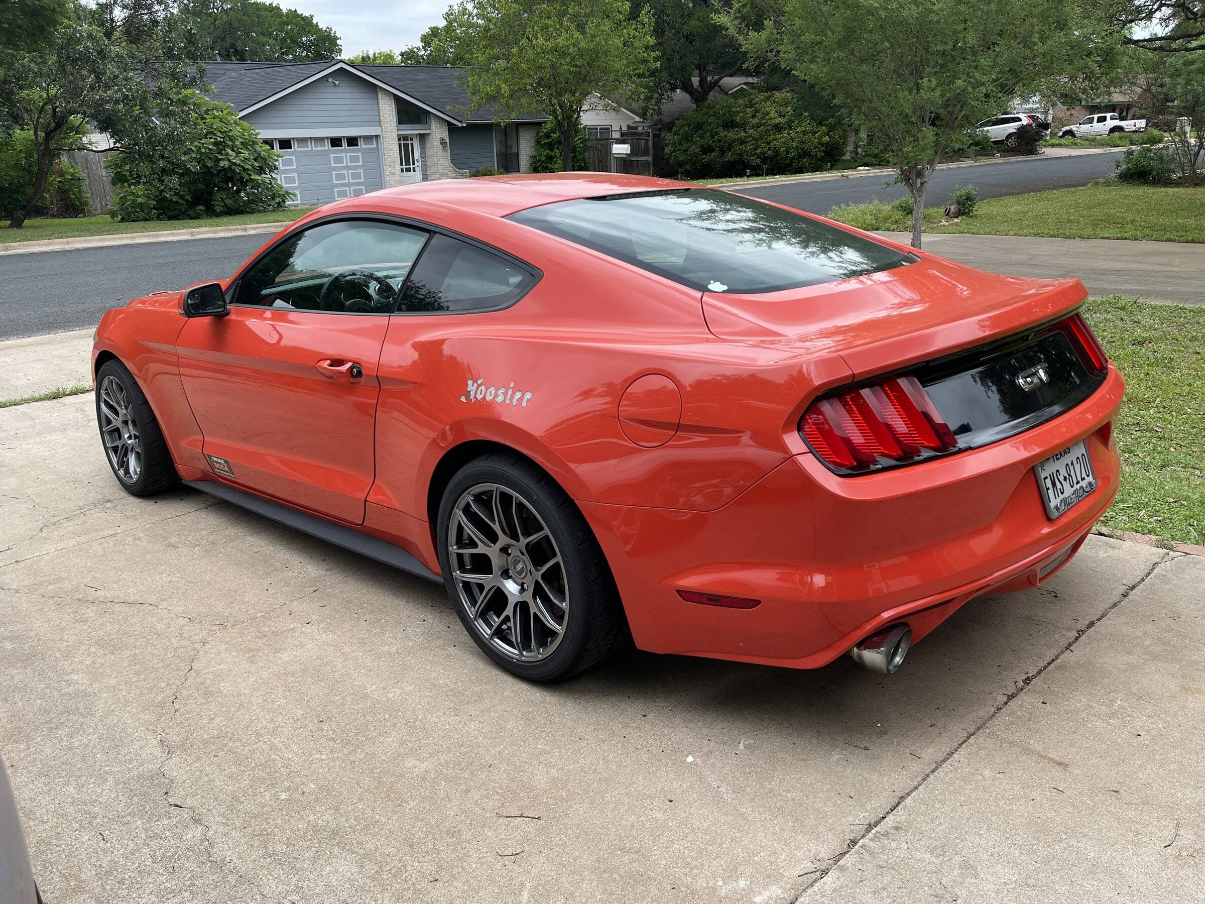

lol, don't mean to be an azz, but I've mentioned several times, this car started as a 2015 base, and was 3595 bone stock(Terry Fair's shop Intercomps). That's how... Youse guys and all your doo dads... lol. Hey, I have to squint at the rear camera. That sucks.
This is my car(note paper plates), and garage, for that matter, Terry had just bought my 99' 328i for a shop WRL racecar and hauled the Magnaflow to me and took the bimmer:
https://photos.smugmug.com/Projects...-S550/i-HMPrJsV/0/23ceb627/X3/IMG_0528-X3.jpg
looks a little different, but pretty much the same now...
In that case, I'd be careful about putting drag brakes on the car. I don't think the 6-piston calipers are necessarily required, because the base GT brakes are pretty good. But, I don't think drag brakes would be a positive. I could be wrong...I've never tried them...but you should be aware that it's a gamble.
