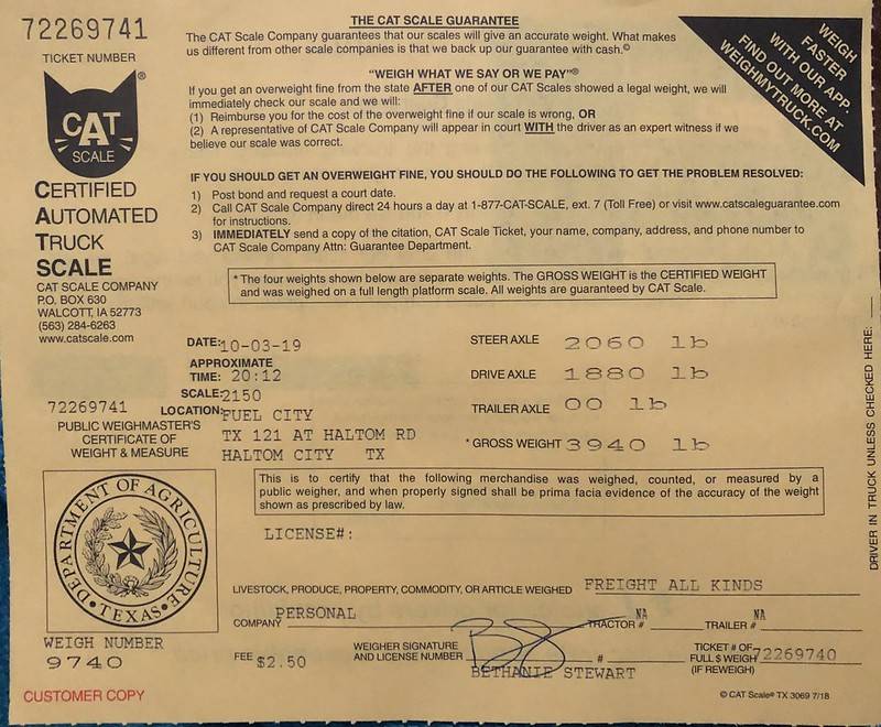

I weighed my '18 Premium EBPP before I replaced the intercooler - 3,940# with a full tank of gas (100#) and 215# of me in the car... so 3,715# wet. Weight distribution F/R (with me) was 52.3/48.7.
2018_Mustang_Weight-Full by clair_davis, on Flickr

Those numbers are about what I've assumed. ~3650# dry is a fairly real Eco number. I've dropped some weight, but I've put stuff on the car, too (like the intercooler). I'm maybe 3575-3600# dry with my car in its lightest form. Pulling 300# off of that isn't going to happen any time soon. Just getting sub-3500# would be a minor victory.
