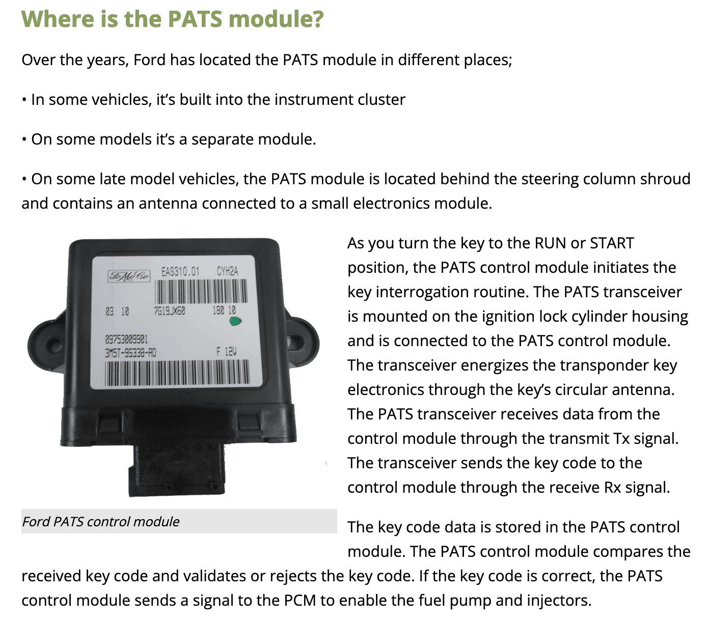

I don't know if this helps, but...
https://ricksfreeautorepairadvice.com/ford-pats-antitheft-system/

stripped everything and didn't find this module behind the steering wheel shroud
