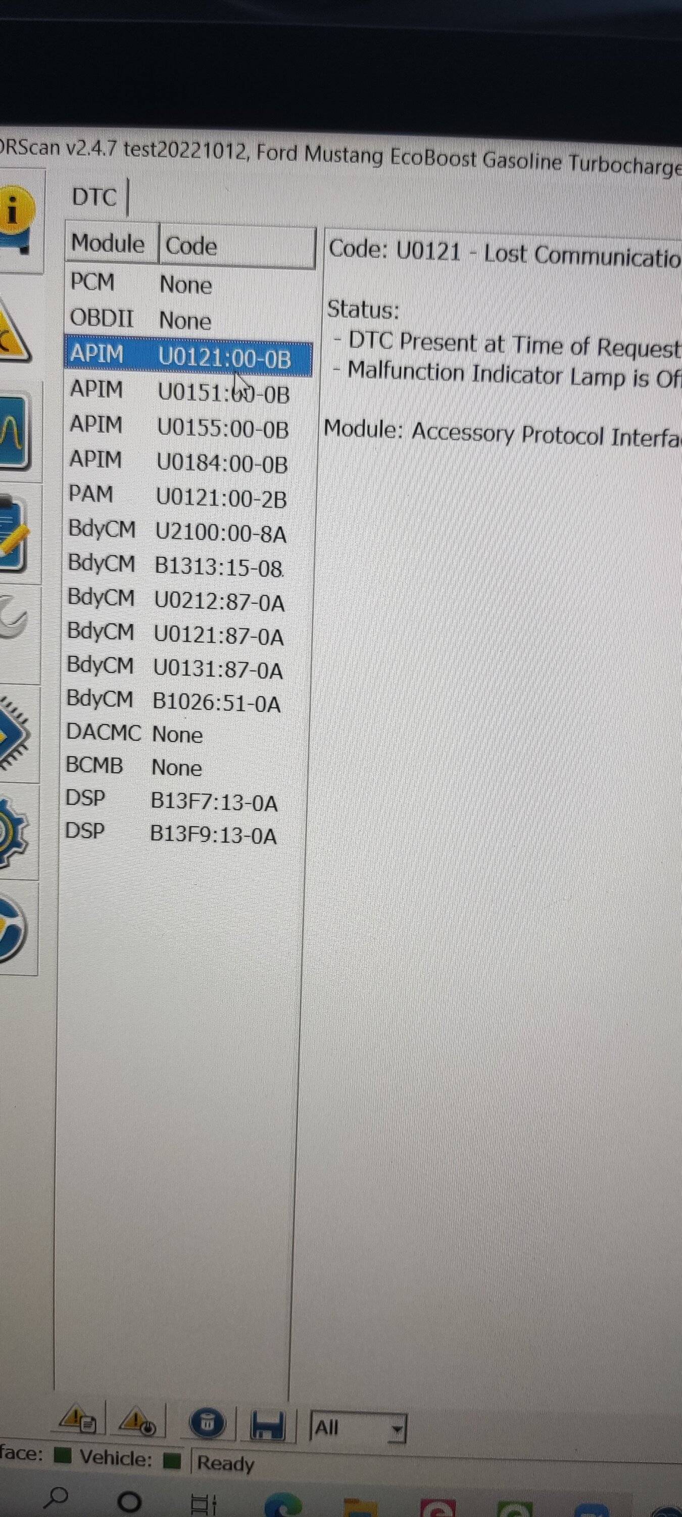

hi guys, i thought everything was fine, so i was putting the interior plastic back on, when i go to start the car, car wouldn't start, no crank, nothing, then i scan my car and these codes pop out, what should i be looking at? mostly are lost communication with abs, power steering

Those U codes are generally either when two modules lose communication or when the an unexpected response/communication between modules exists. Such as modules with mismatched programmed vin’s or wiring issues. Might be firmware programming mismatches too.
However those codes would not prevent it from starting. It’s something else. Check fuel pump and PATS PID’s and see what they look like. Look for pats_enabl PID in the pcm. If it’s ENABLED then PATS is triggered and interrupting the start sequence. It will also prevent the fuel pump from running.
