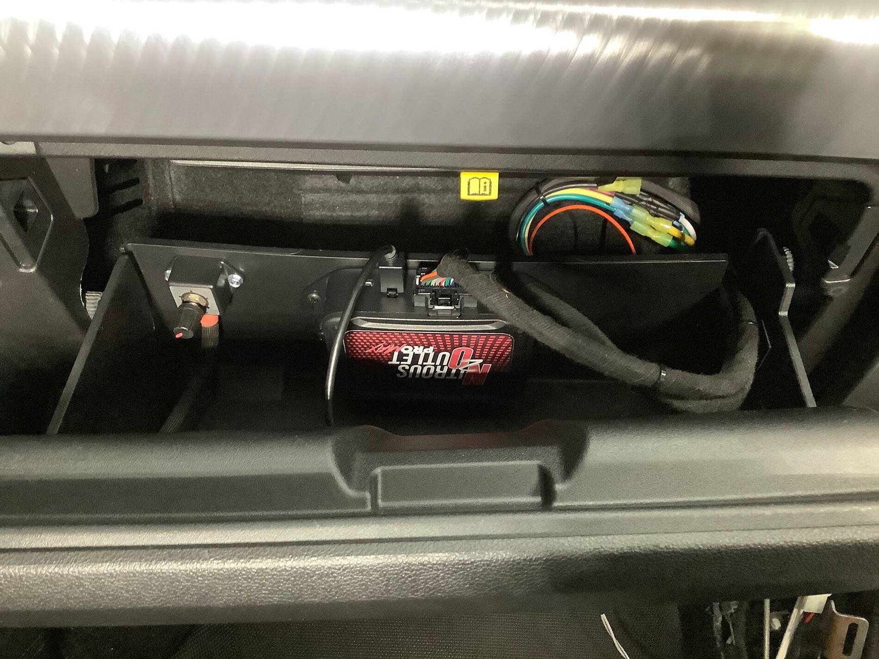

I have the knob with my JMS BAP. It’s in the glove compartment. No one goes in there but me. It’s been a while since I’ve made any adjustments to the BAP, but I believe you can even lock the setting.
