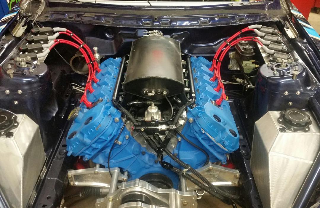

the 2015 we run one of our fore triple pump setups
our 2011 is a race car build with a 2 gallon fuel cell up front, we run a weldong pump.
the entire fuel system is in the engine bay, the only thing left in the rear of the car are the 2 16v batteries.
