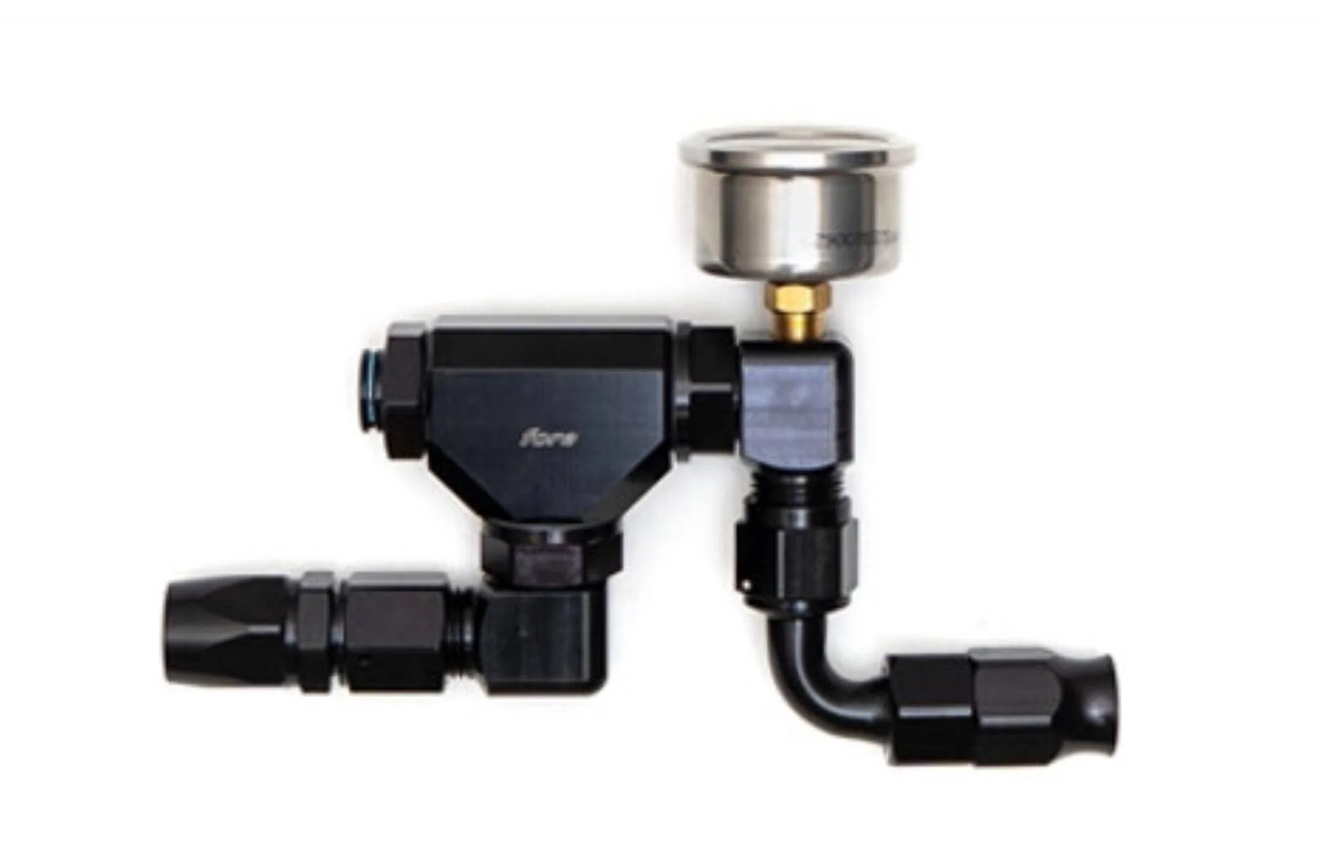

I just ordered their fuel tee for the Di and right afterward heard they are slow to ship orders. Hopefully I don’t have to wait too long to receive it.
My kit took about 6 to 8 weeks or so to ship even after paying for expedited shipping (the dealer got that fee reimbursed)
