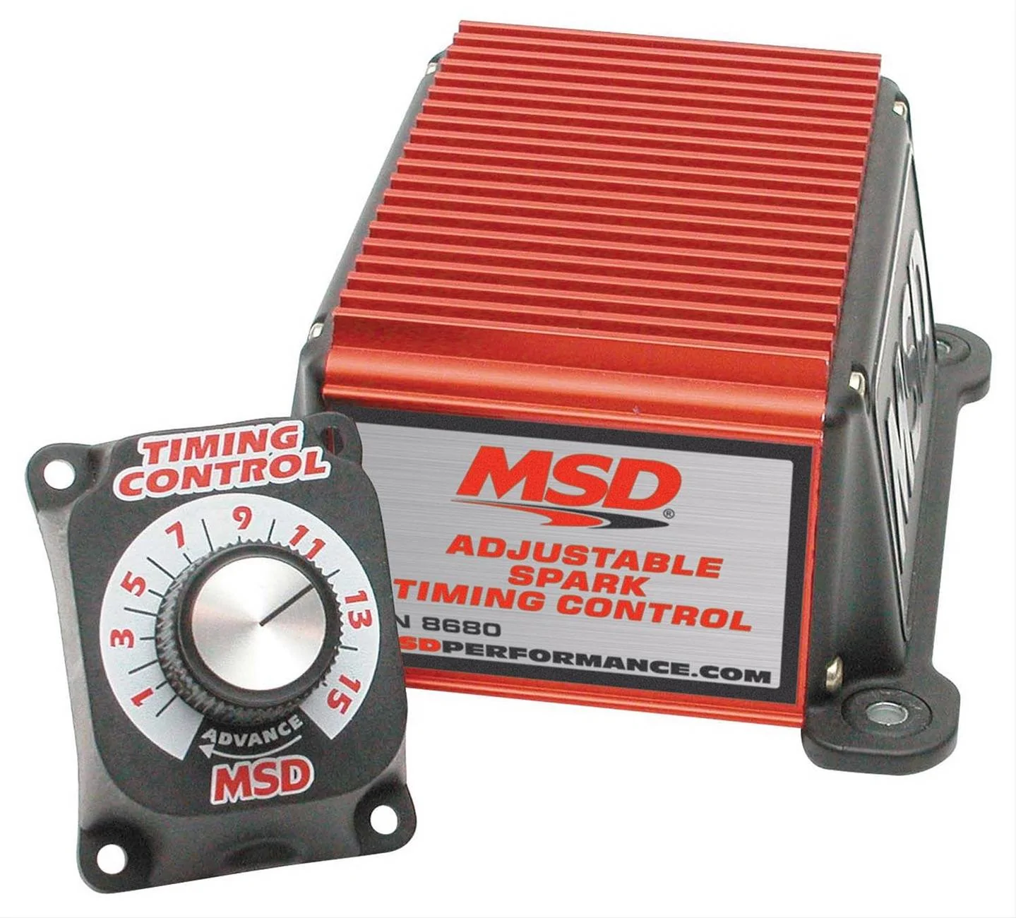

Here's my issue with a BAP. The little control knob (if equipped).
That little can break, get brushed away, turned, etc. Heck someone at a car show could fuck with it if they wanted to.
Had the same thing happen a very long time ago on a Fox body, MSD timing knob and it basically got turned off and cost me a motor.
Some of the units seem to have a little dial in the BAP itself like a stereo amp gain knob. That seems better, less likely to be misadjusted.

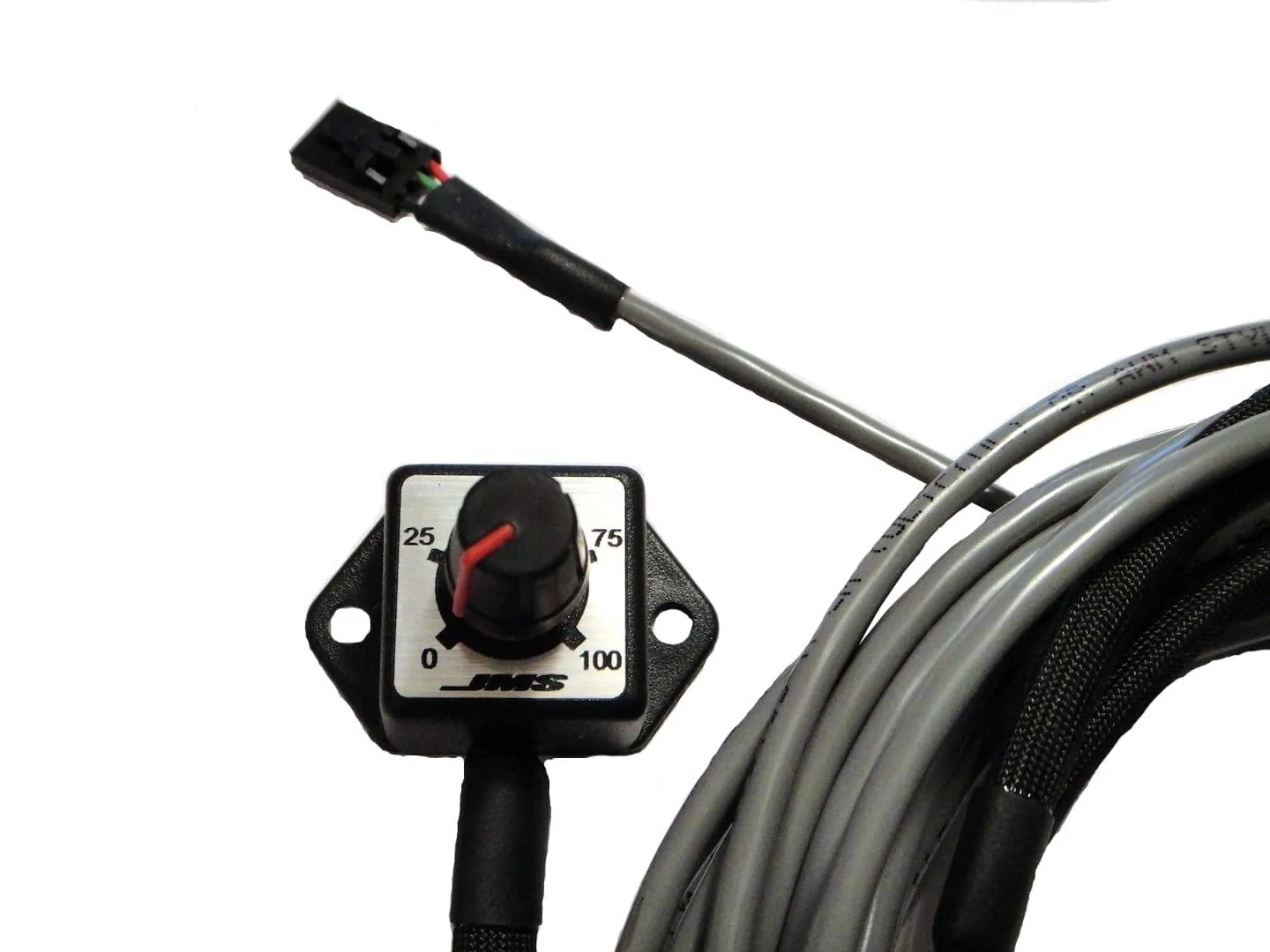

Lol yeah... A knob seems dumb now days. Looks like some old technology. My JMS runs off throttle position. 50% it ramps on.

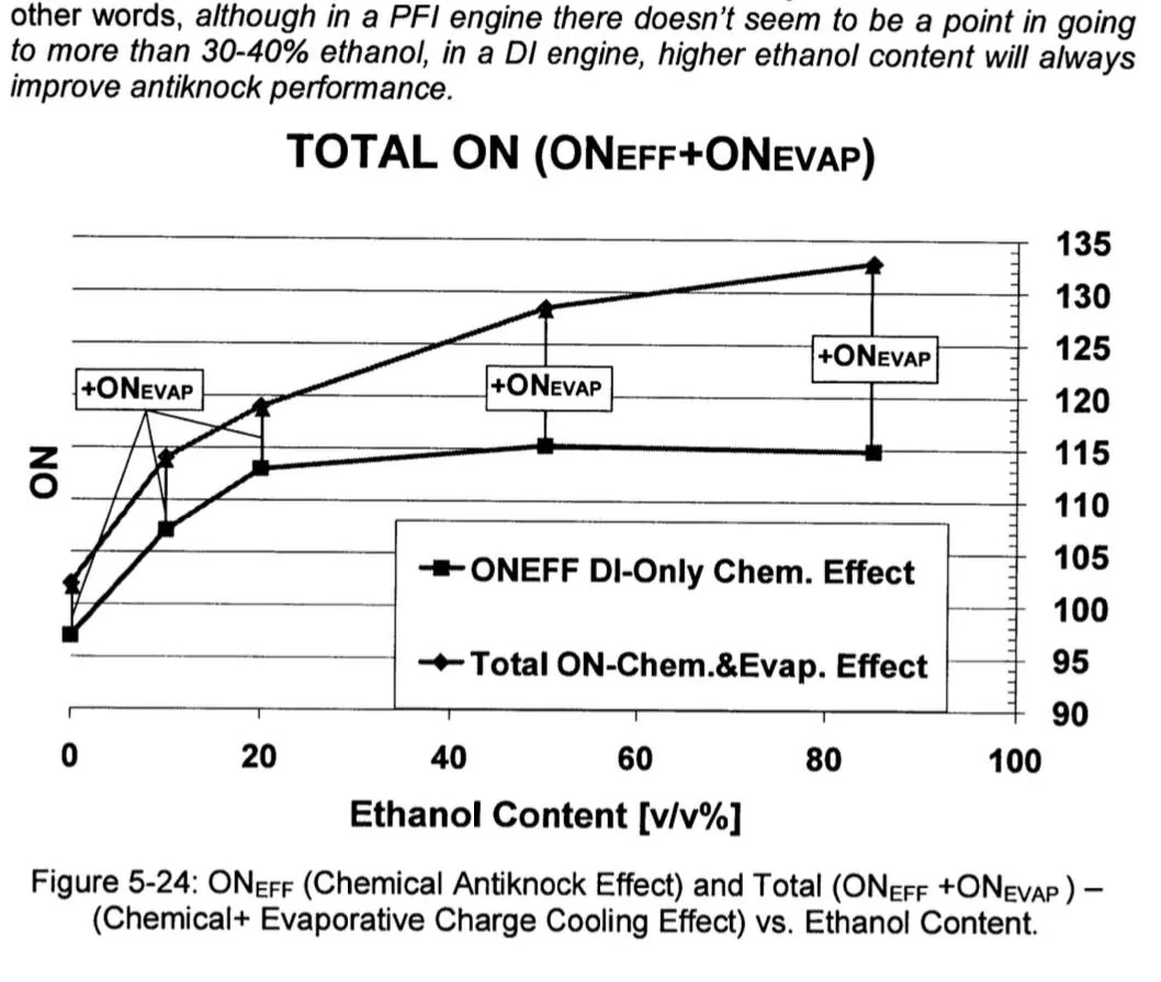

wonder what kind of power E70 would give.
All else being equal, 70-80 HP ish, but also the cooling and knock protection that gasoline will never provide, which includes race gas. 100 octane gasoline is great for suppressing knock, but it still doesn't have the cooling properties that alcohol does and costs 5x as much

Where do the ethanol benefits start to max out? E30? E50?

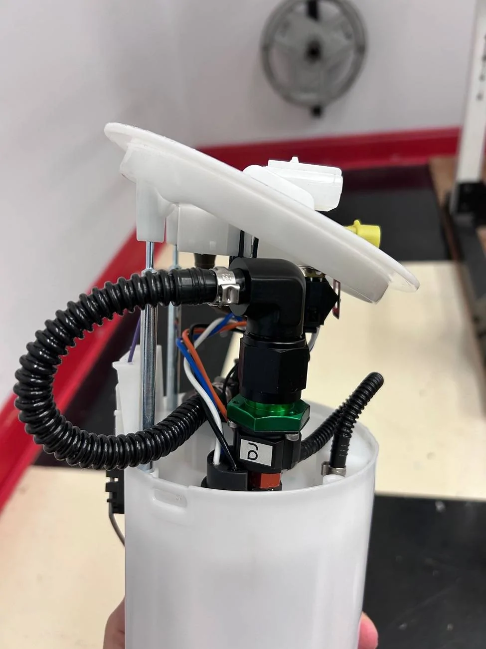

I had Fore Innovations lvl 2 kit with dual 274 pumps installed in November 24'. I shopped around and got a decent deal on the kit with install.
I believe the total cost was around $3600 everything including installation.
Be aware lots of other mods are done on the car including FIC 1000's.
The point being the car runs amazing. Never throws a code, not issues with the fuel baskets or fuel running low.
I always keep the fuel above 1/4 tank for sure, but again, no issues and the car runs far, far better than when it was stock.
