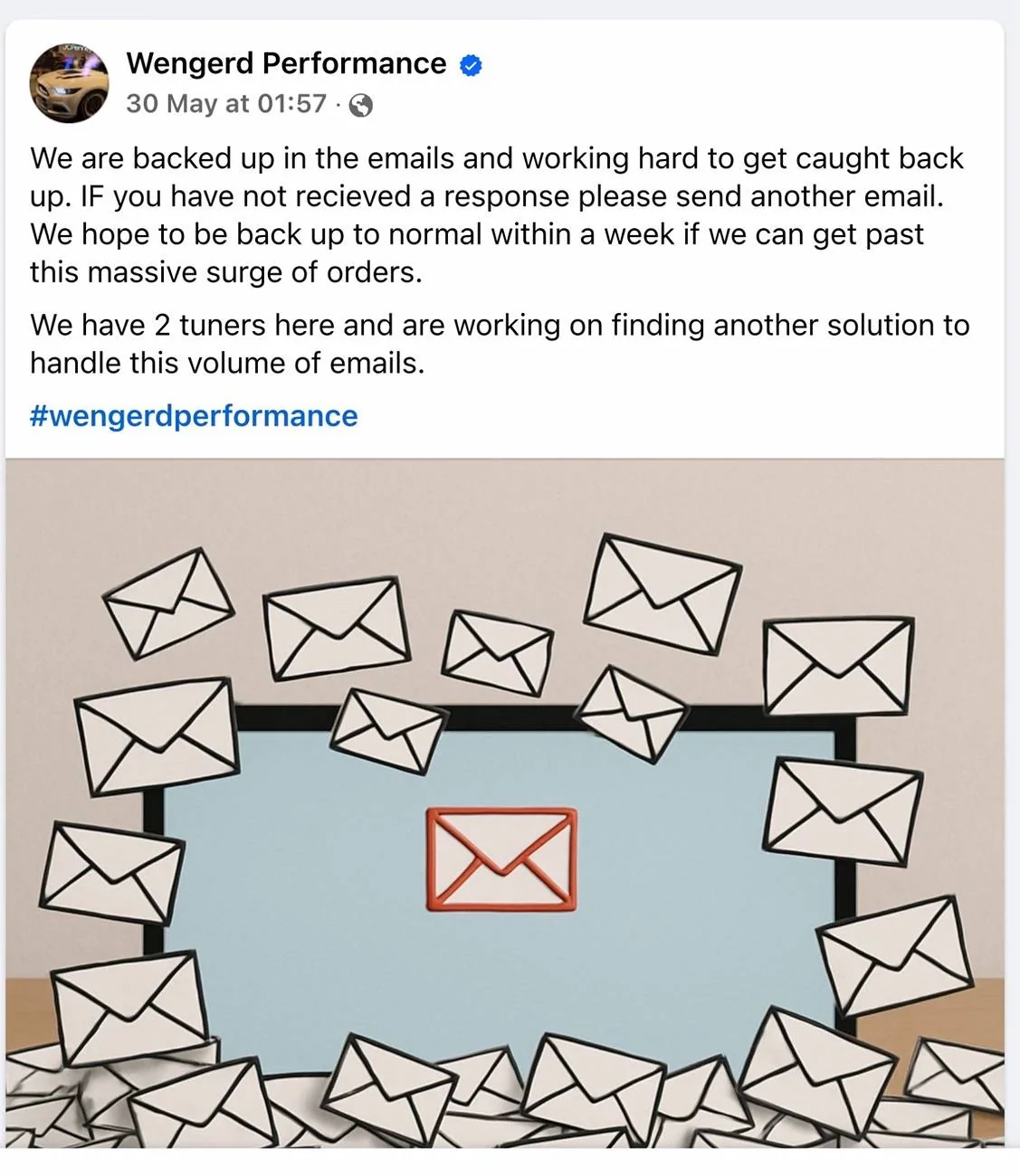

Quick soap box - apparently these days it’s acceptable human behavior to ignore a question if the answer is going to be uncomfortable. Wengerd did the same with me asking about returnless, people at work do it all the time, etc. Drives me INSANE. 30 years ago if someone asked you a question, you gave an answer. Now it’s cool to just let people twist in the wind. Of course, a LOT of stuff was better 30 years ago.
OK rant over. Back to wishing I could afford to run E85.
What do you mean??? I thought werngard was the end all solution to ever s550 owner's tuning needs?
he is a product of his own success ATM…. With email problems.

I can say the same thing about my AOL email I made 25 years ago LOL
