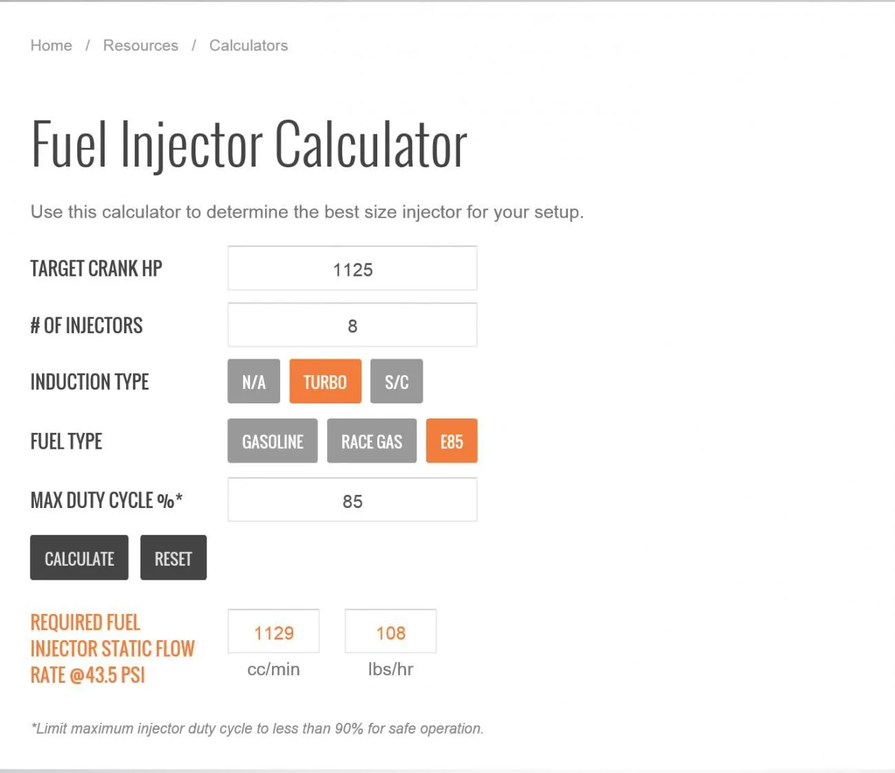

this is what your parameters would be for your application
