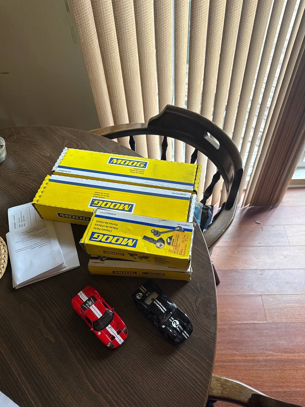

After playing with suspension setups, I’ve decided to swap to the Ford Performance Track Handling Pack.
Currently I have ordered,
The track handling pack (PN: MFR3AM8A)
The fastener kit (PN: MFR3FASTENA)
MOOG Front Endlinks (PN: K750798)
MOOG Rear Endlinks (PN: K750744)
Do I need anything else for this kit for install to go smoothly?
I’m assuming I don’t need the sway bar bushing kit (PN: M-5490-BKD) as they come with new bushings already.
I’m assuming I don’t need the Ford Performance camber plates as it’s only a 1 inch drop.
Anything you guys can think of please let me know because I’m tired of spending money and just want to do this once :crying:
