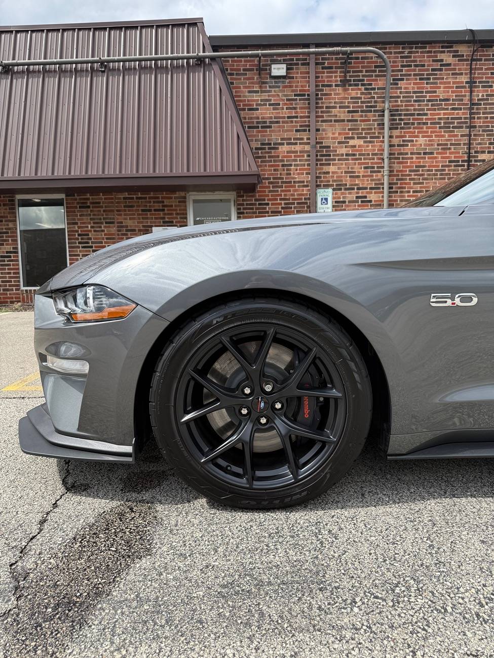

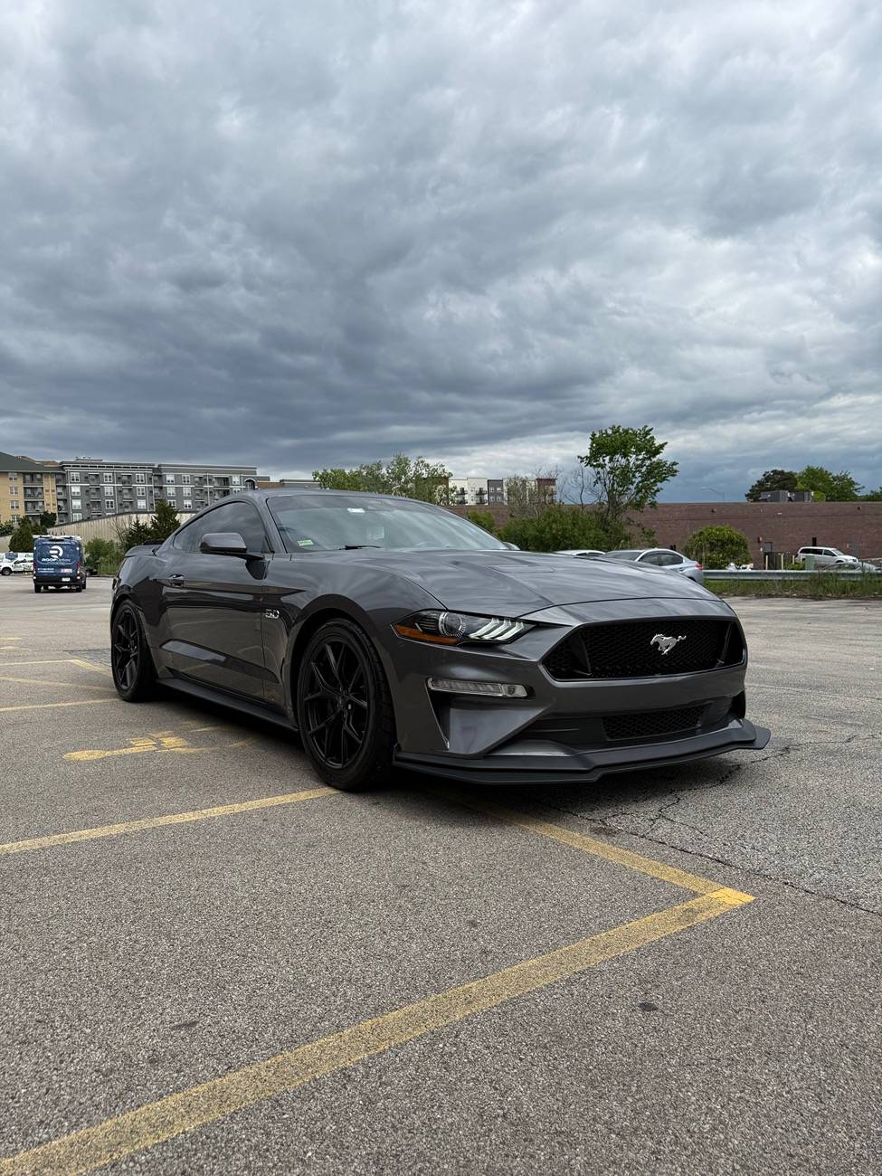

Do you have any pictures of how your car currently sits on the steeda springs?
Yessir I got a few and can take more if needed, measure for you etc.
Thanks. I’ll keep an eye on this thread and hopefully you will post some pictures of the new ford track kit when you get it installed. And also would like your opinion on how it drives.
