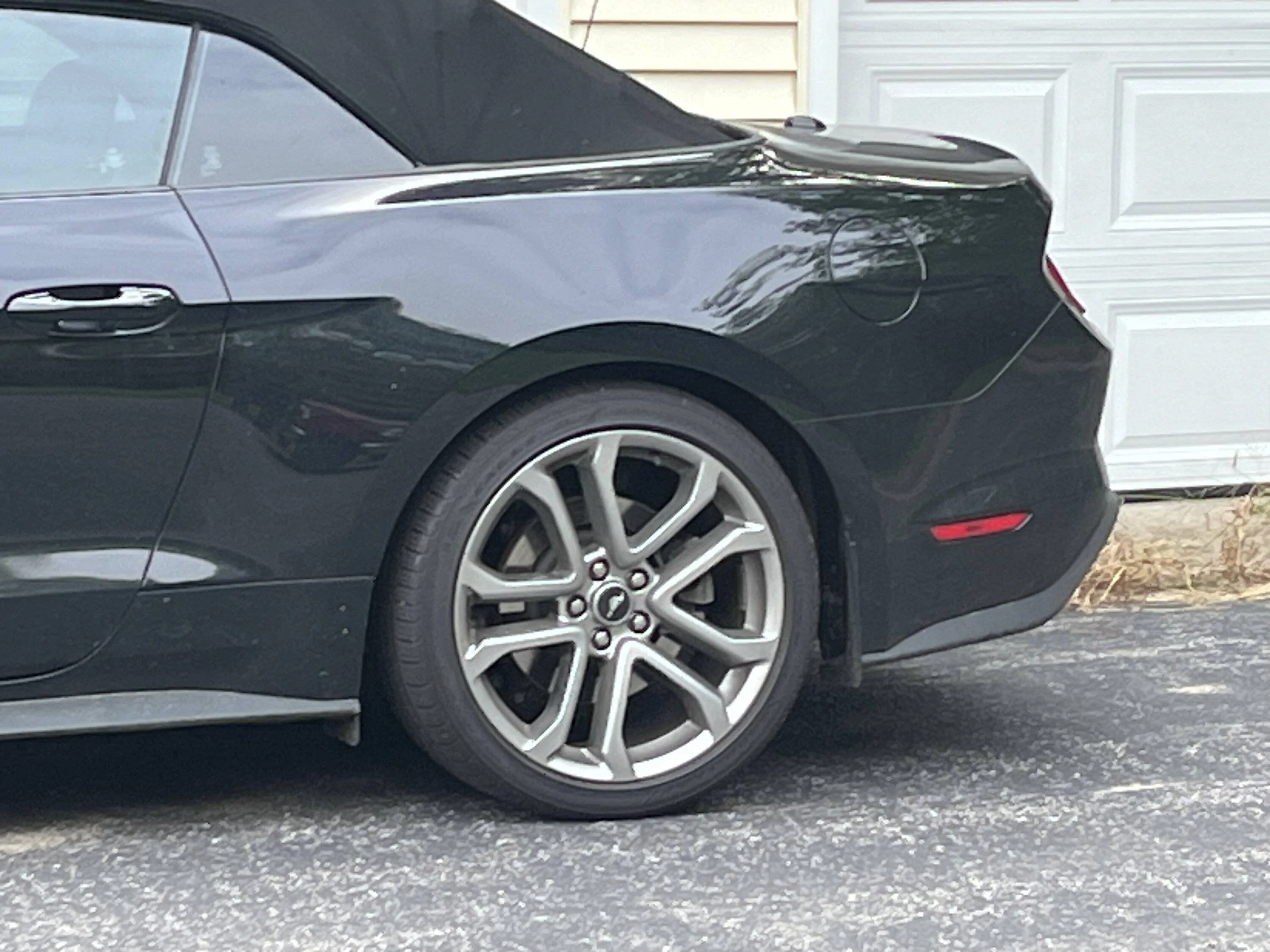

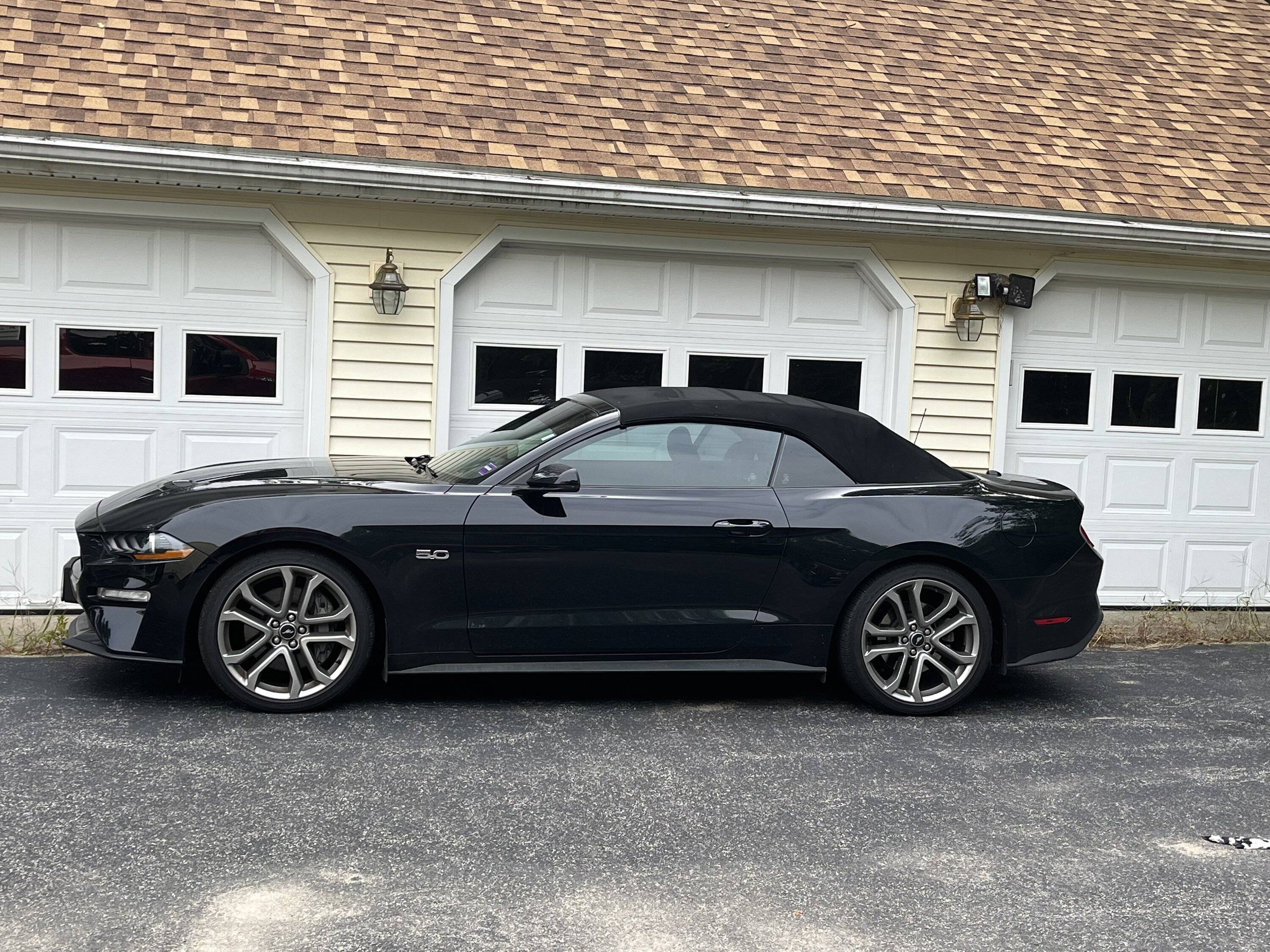

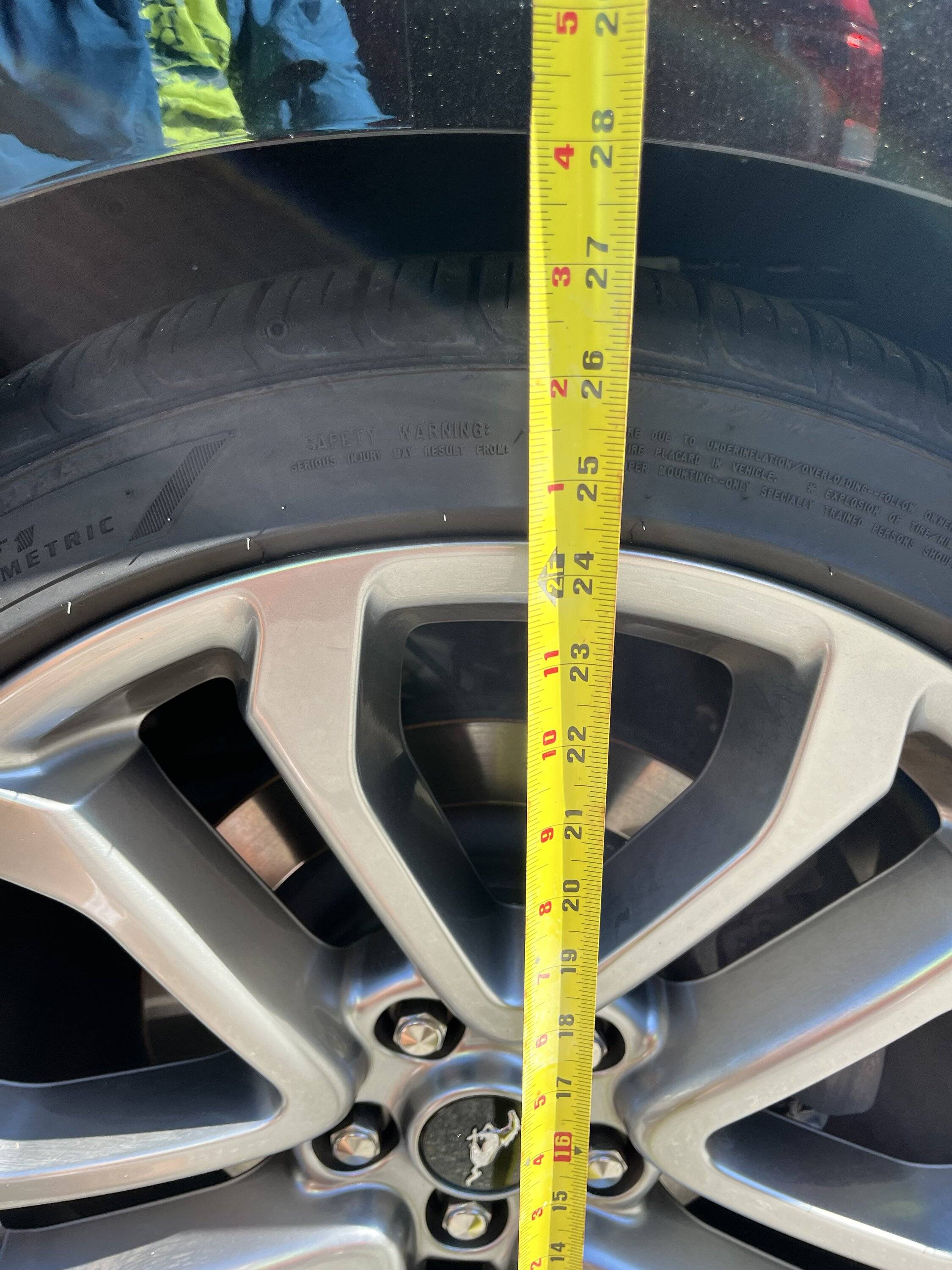

So after ordering the track handling pack in January, waiting till late August for it to become available, i am finally getting my track pack installed tomorrow. I know Steeda and others make high quality suspension enhancements, but since my car has 2 years left on the factory warranty, i wanted to keep everything oem. I am having it installed at the ford dealer, its been there 2 days, just awaiting an alignment. Ill get the car tomorrow.
i have to say, i am super excited to see how it handles, looks lowered and rides.
is there anything to check regarding the installation? Id heard it takes a day or two for things to settle?
i hope there is a noticeable difference in handling. I do not plan to track the car, just opted for the tightest handling options…

Just picked up my car.. 1400$ for the dealer install, first impression - super tight- i thought the steering was messed up, it’s like driving a little go cart. Took an exit ramp at about. 50 (too much traffic to do more) and it hugged the road like nothing. Can’t wait to drive it home on the backroads, it’s a little stiffer - a lot stiffer but ride is still good. Bumps are fine, it looks nice lower - frikken black paint though, its dirty lol
very happy purchase so far. Ima put some miles on it this weekend, all maine and nh backroards so that will be a good test…
