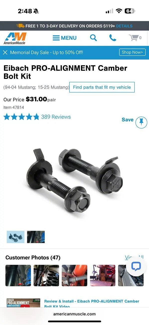

Perfect thank you for the feedback, I actually just got off the phone with Deans Performance, I’m sure you’ve heard of them as they’re local to us lol, and he said to grab these.
I’ve not taken my car to Dean’s but have heard nothing but good things about them from people in our area. He won’t steer you wrong, so you should be good with the camber bolts 👍

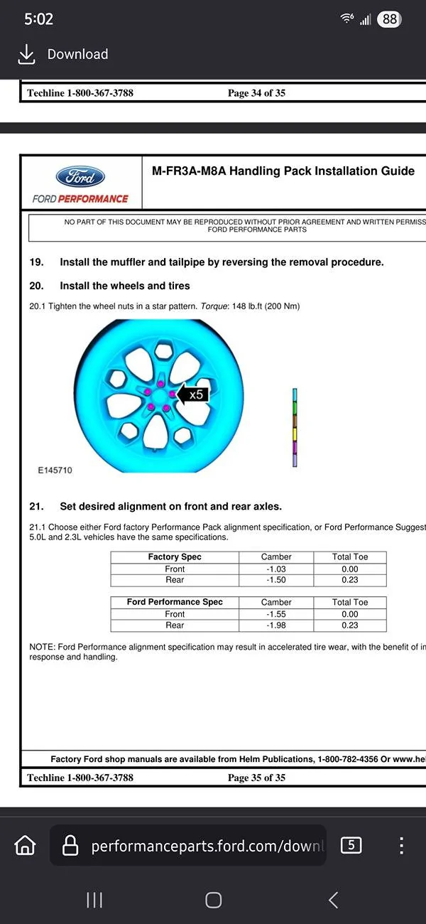

Camber spec on these cars is up to -1.7 on the front, and something like -1.5 on the rear. A good shop can get those in on mild drop springs that are less than an inch like the Steeda and BMR minimum drop. I don’t know about the Ford lowering springs, but it’ll be close.
