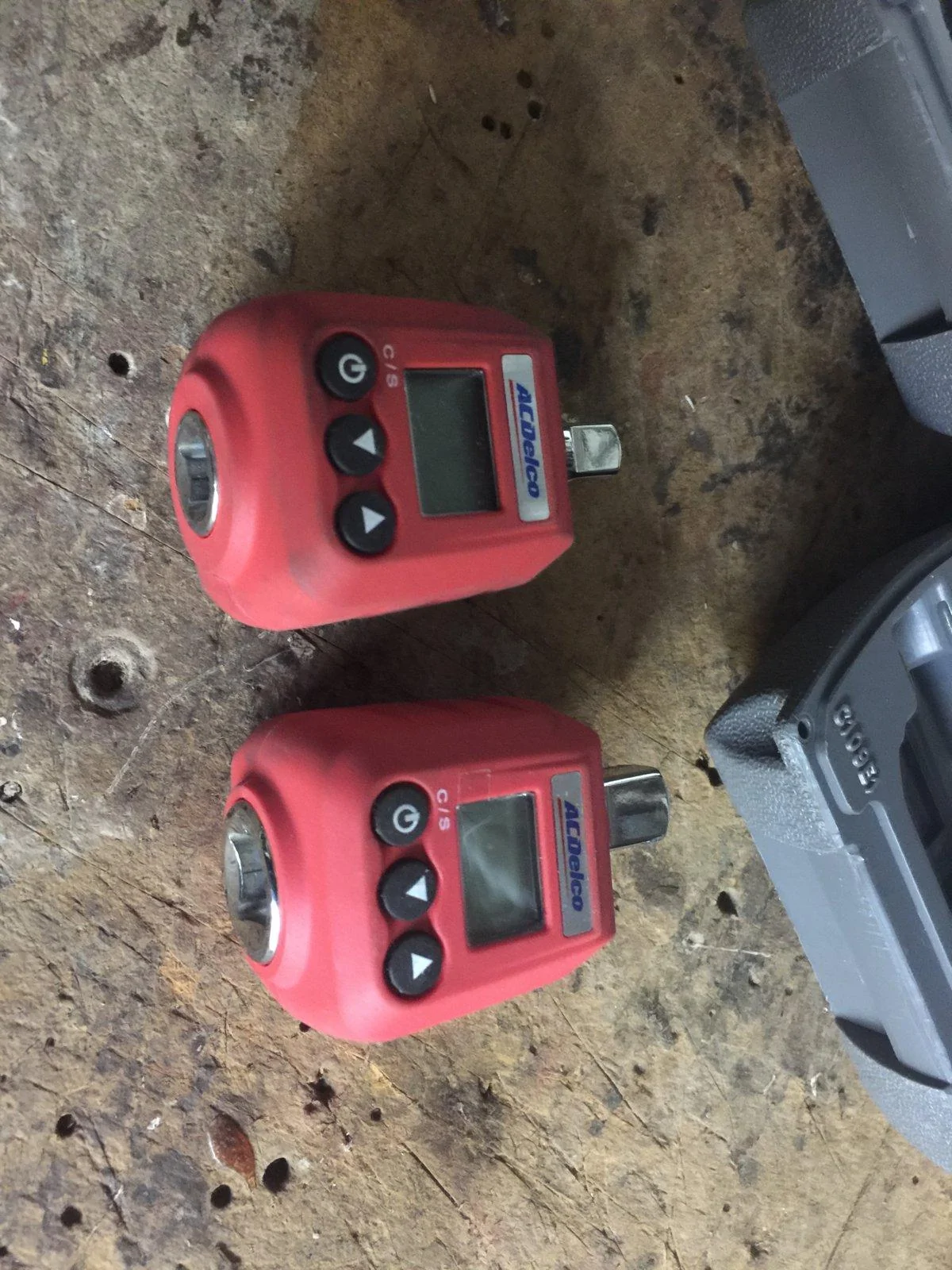

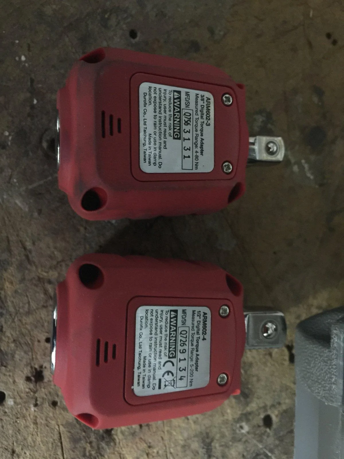

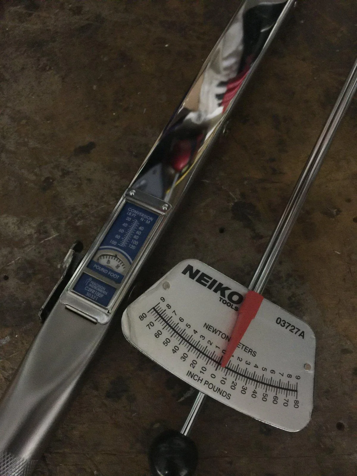

I have compared using the precision internal split beam w just practicing with an angle end wrench on a torque load cell. You can get very close.
The ACDelco torque cells (Amazon) are great for calibration and you can also add an extension either side and chuck it in the vice or something to hold it. Then add a socket with a phat nut half way in socket with some expose to put a wrench on, or a lug socket that might have wrenching flats, etc etc.
practice w the length of wrench you need. You will get to +\- 15% with ease.
That precision split beam pictured has an angle head and you can use that with something called a claw foot which combines torque wrench w open end box wrench head.

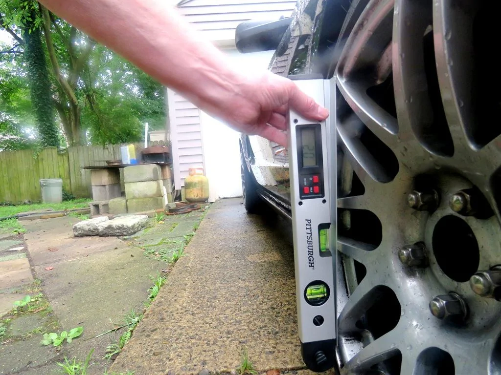

You can check actual camber pretty accurately yourself with a digital angle finder (most from Harbor Freight and others are ±0.1°) and a reasonably flat setup area.

You can check for runout by jacking the tire clear of the ground and spinning it. Localized damage can be avoided if seen, and checking between two different pairs of circumferential locations can also identify a suspect wheel. You can roll the car a foot or so and re-measure, or you can mount wheels known to be good.
I've been doing all of my own alignments since about 1980 using digital angle finders (similar methods before they became available) and never ended up with a bad job. Even made my own camber gauge that uses a dial indicator, but the angle finder is easier and faster.
FWIW, within 0.1° is at least as good as you can get with shim-aligned SLA suspensions.

That's an excellent idea using the angle finder! I may give that a try.
