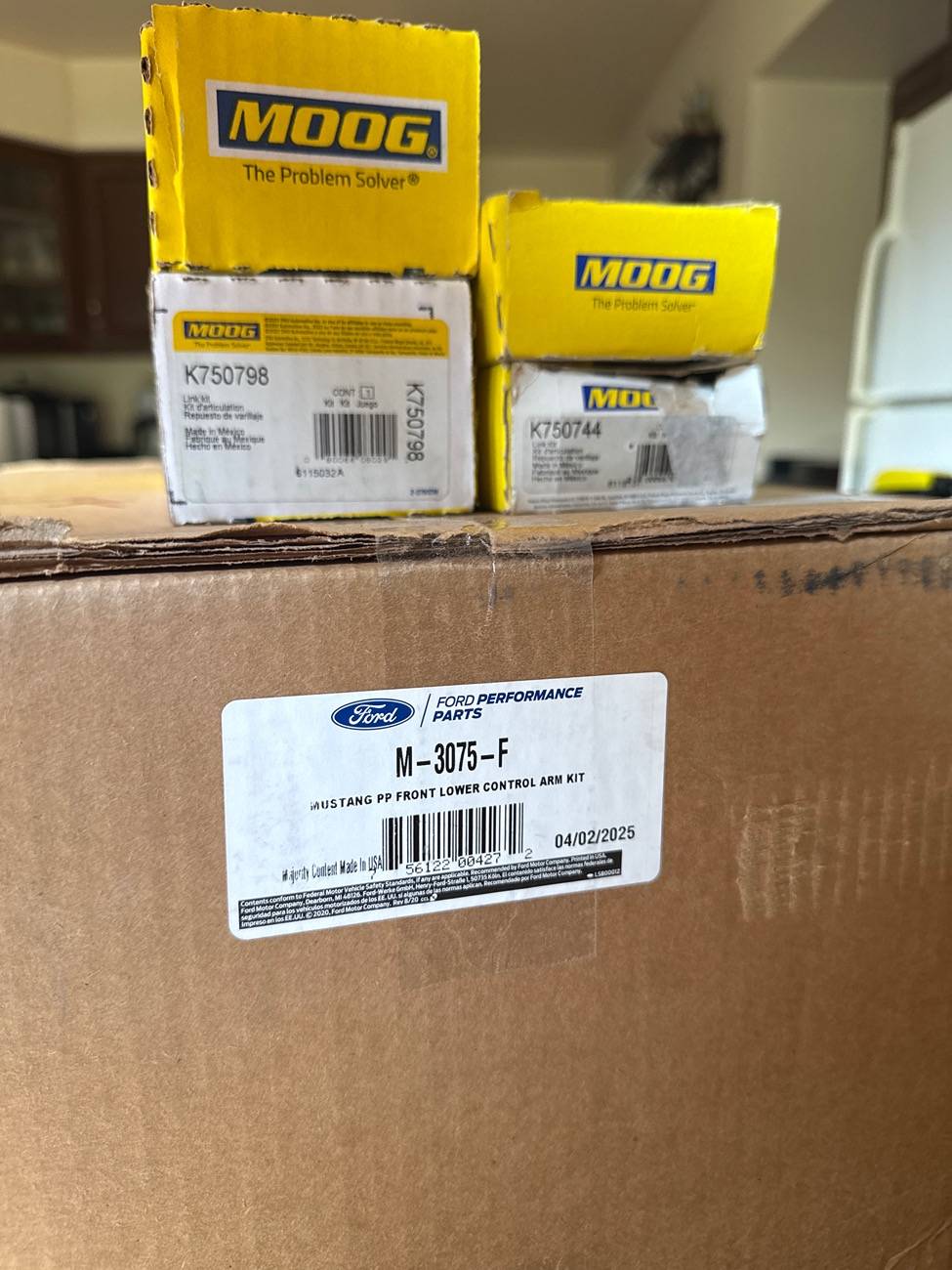

Hardware kit is in transit to dealer…

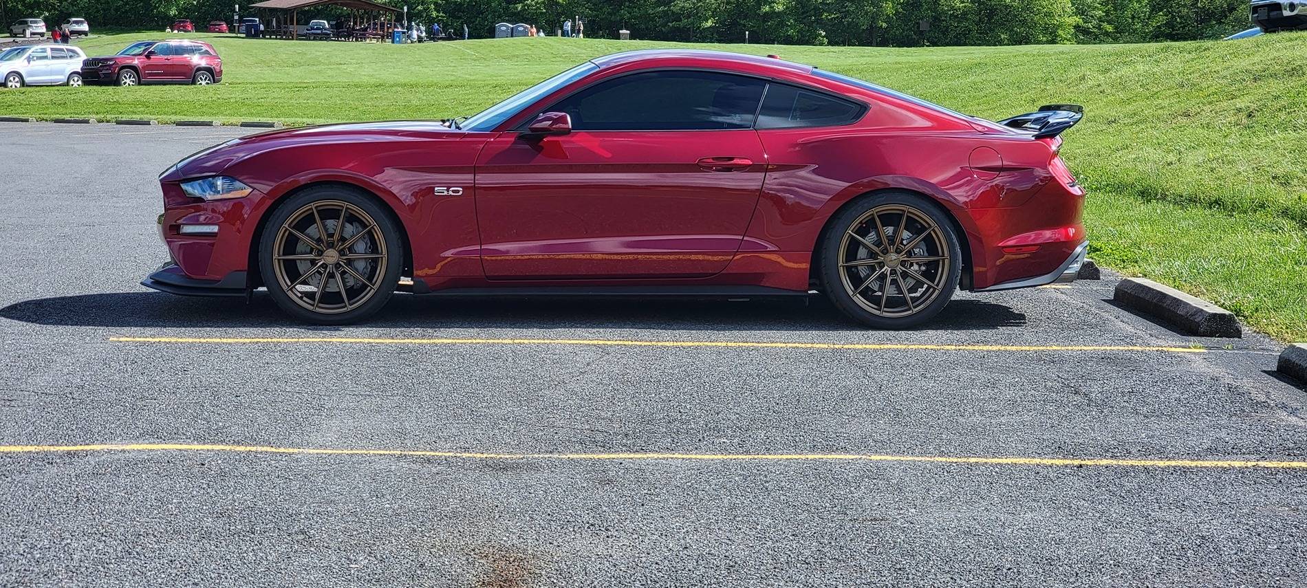

Camber spec on these cars is up to -1.7 on the front, and something like -1.5 on the rear. A good shop can get those in on mild drop springs that are less than an inch like the Steeda and BMR minimum drop. I don’t know about the Ford lowering springs, but it’ll be close.
Exactly why I went with steeda build your own with the pro actions and minimum drop springs. Anything lower than 0.5 drop you'll have out of spec camber in front and will need plates. When I called around only 1 shop was willing to adjust camber plates so that influenced my decision as well. Heard of people going with the track struts from Ford performance with the minimum drop springs from steeda and being happy with it. I almost went that route.

Post some pictures so we can see the stance on those steeda springs.

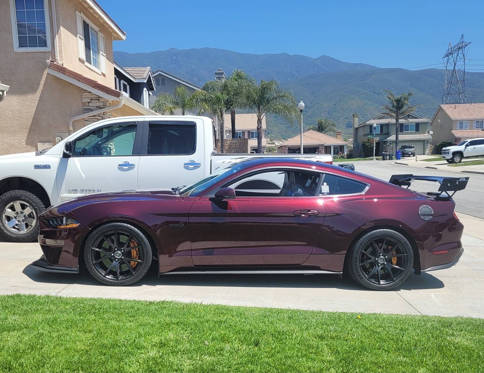

Why is it lower in the rear?
Maybe ever so slightly. It'll be fine once it's broken in and I get an alignment done. We'll find out after I go to the Tail of the dragon in a few weeks.
