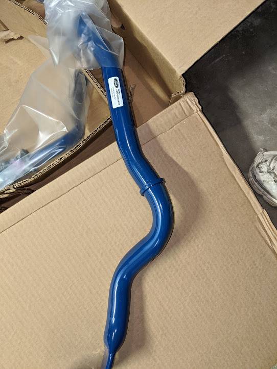

    I just got the FP Track Suspension kit. I can confirm that the front sway bar now has the bushing stops built into it, so no need to buy separate locks or use hose clamps, etc. Stang front sway.jpg
