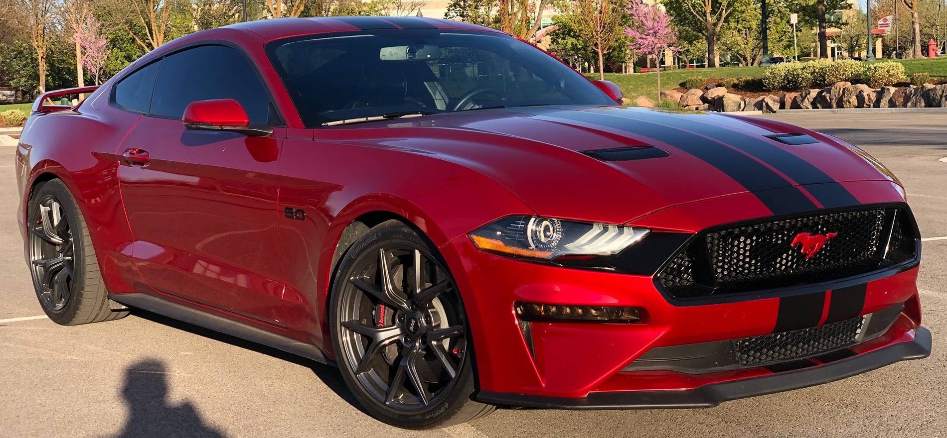

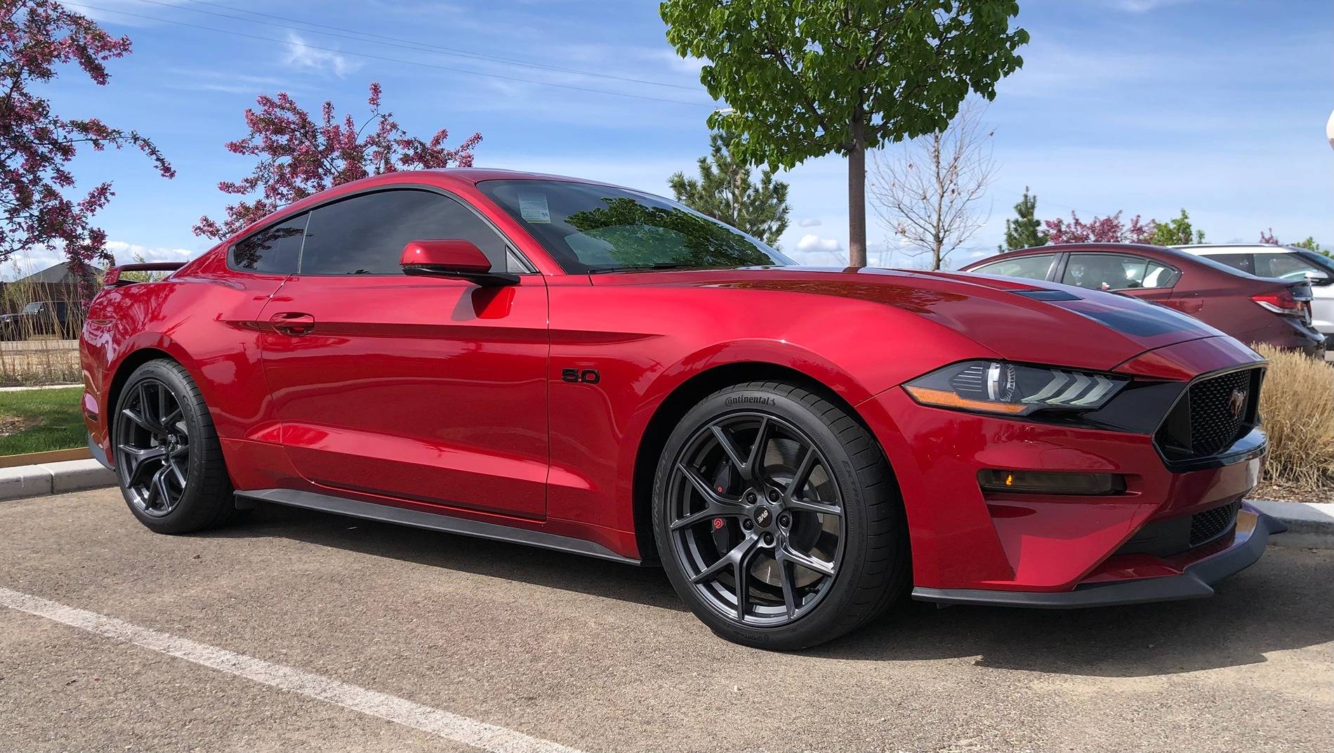

Before: (PP1)
After, although not at exactly the same angle:

Before: (PP1)

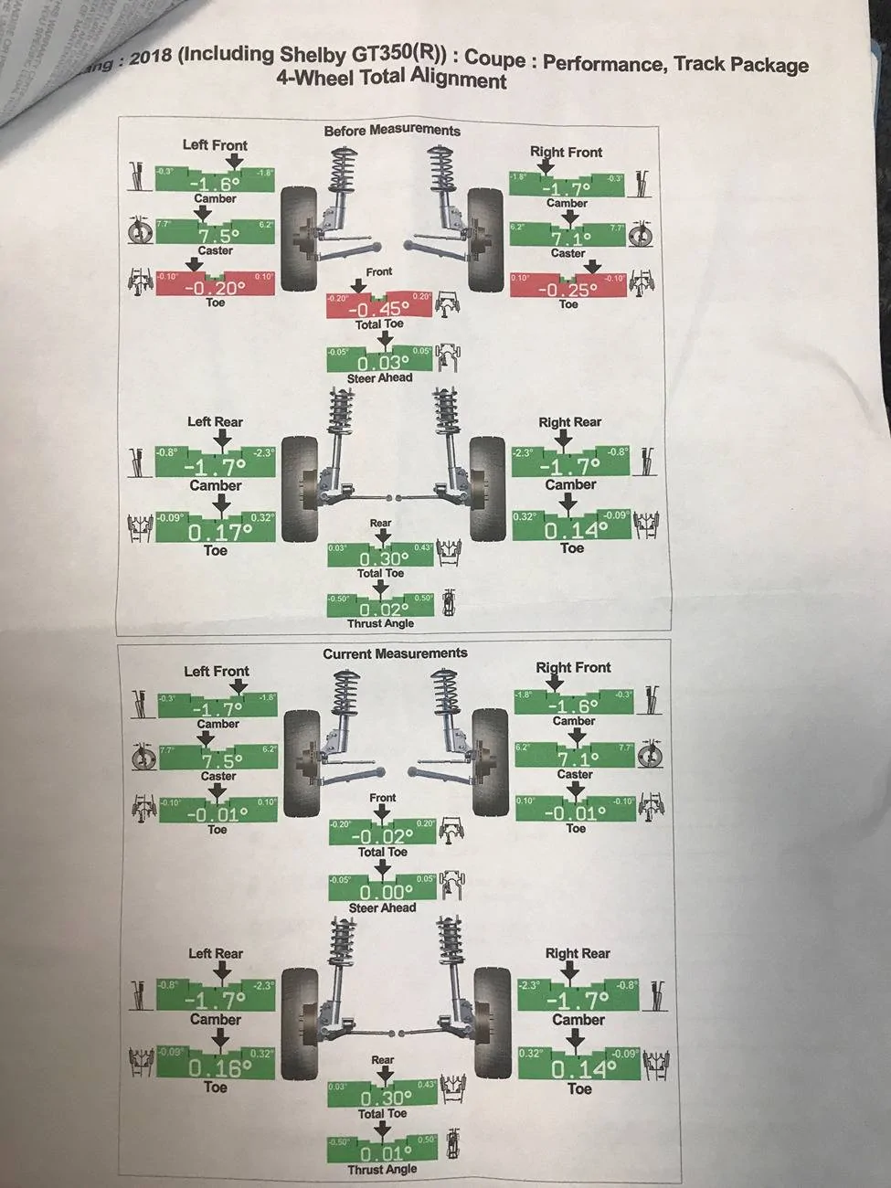

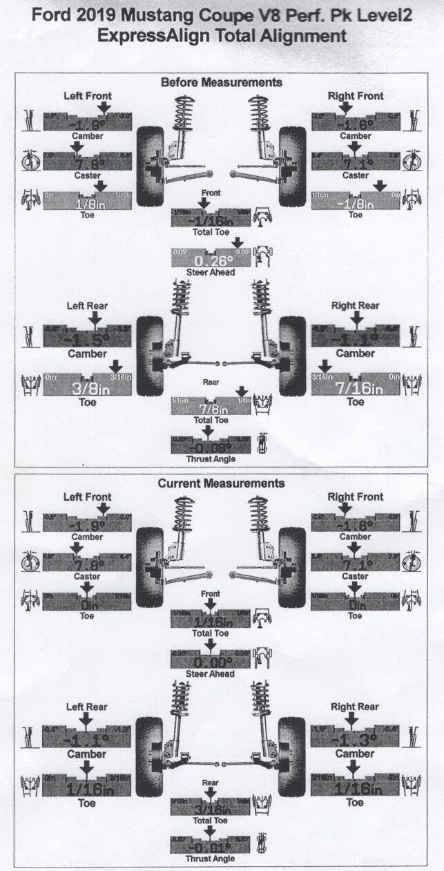

While mine was a base GT and had the Track Shocks/Struts + Steeda Minimum Drop Springs. I had alignment done back then on 19x9 (255/40/19) and shop did Track Pack specs. However I just got the FP front control arm kit installed today, but also had other updates since then such as going to 19x10 (275/40/19) and Oil Pan replacement which they probably dropped the K-member (said no need for alignment) After the control arms, they did PP2 specs instead. Not sure if the alignment is good for street? car drives fine and does not tram line and stays straight. Tires have been on car for 2 years and no tire wear reported and last rotation was the week before the upgrade kit.
Original alignment before 19x10 wheels and front control arm kit.
New alignment with 19x10 and front control arm kit.
Wonder if PP2 is ok setting for those who have the FP track suspension package even if only street driven?

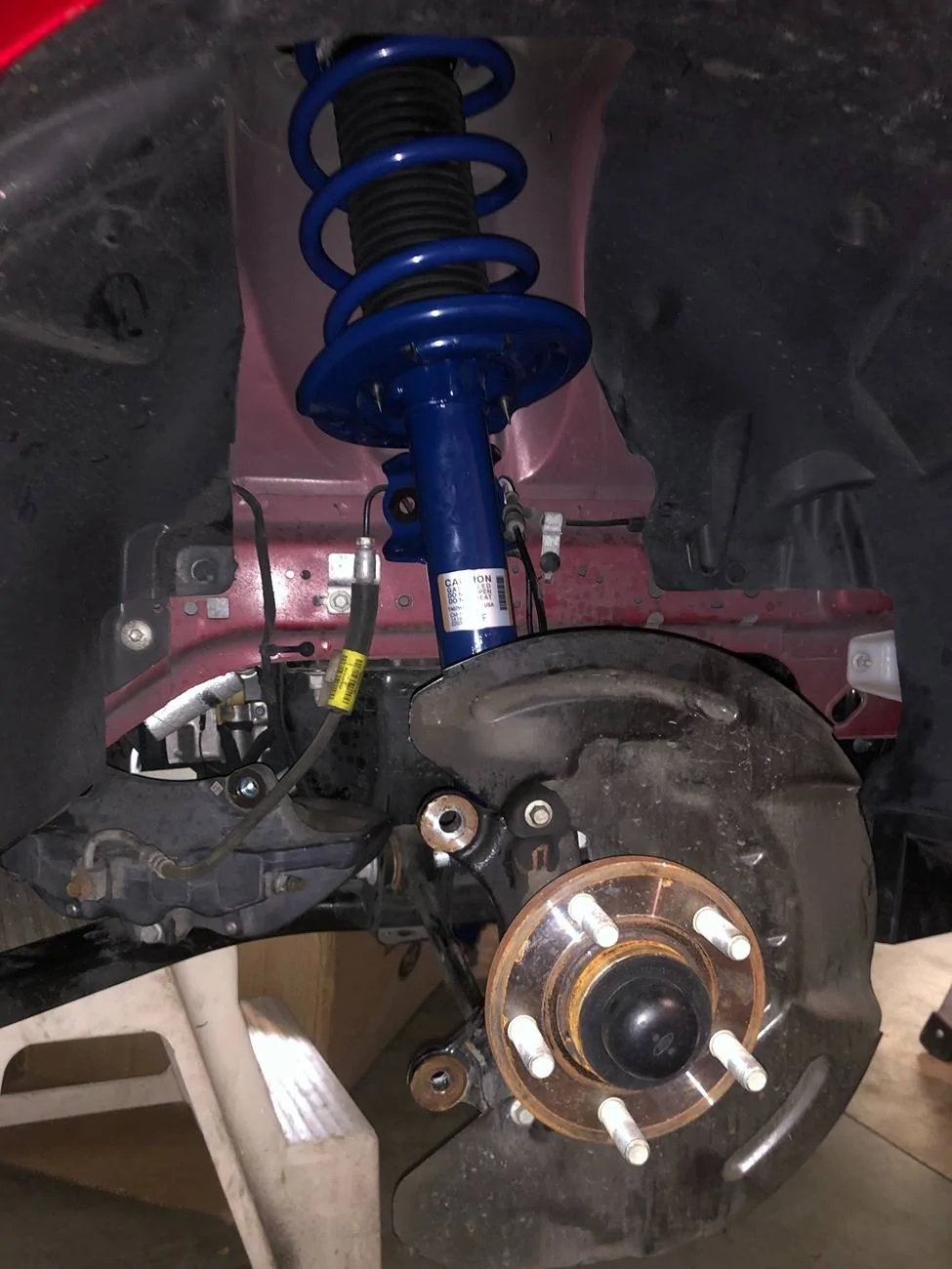

Were you looking for outside before/after pics or something of the suspension specifically? I did post some before/after pics a few posts up, but I can post a few of the suspension on the car.
They are the springs that came with the Ford Performance Track Kit. Springs were already mounted in the struts (no spring compressor needed), sway bars and a few other links.
It did seem to turn flatter after the install, and the shocks work well. Definitely more stiff, but not uncomfortable at all.

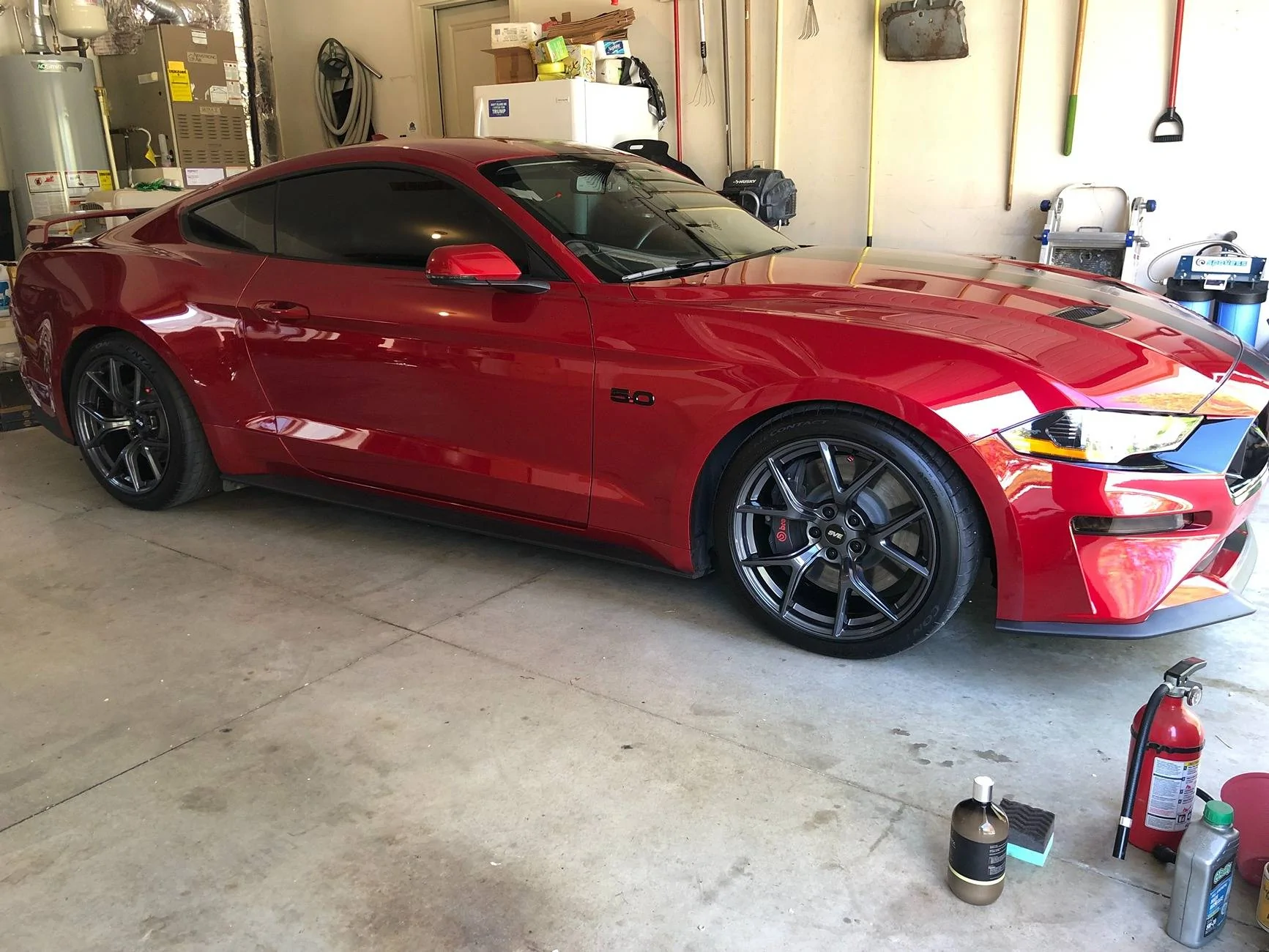

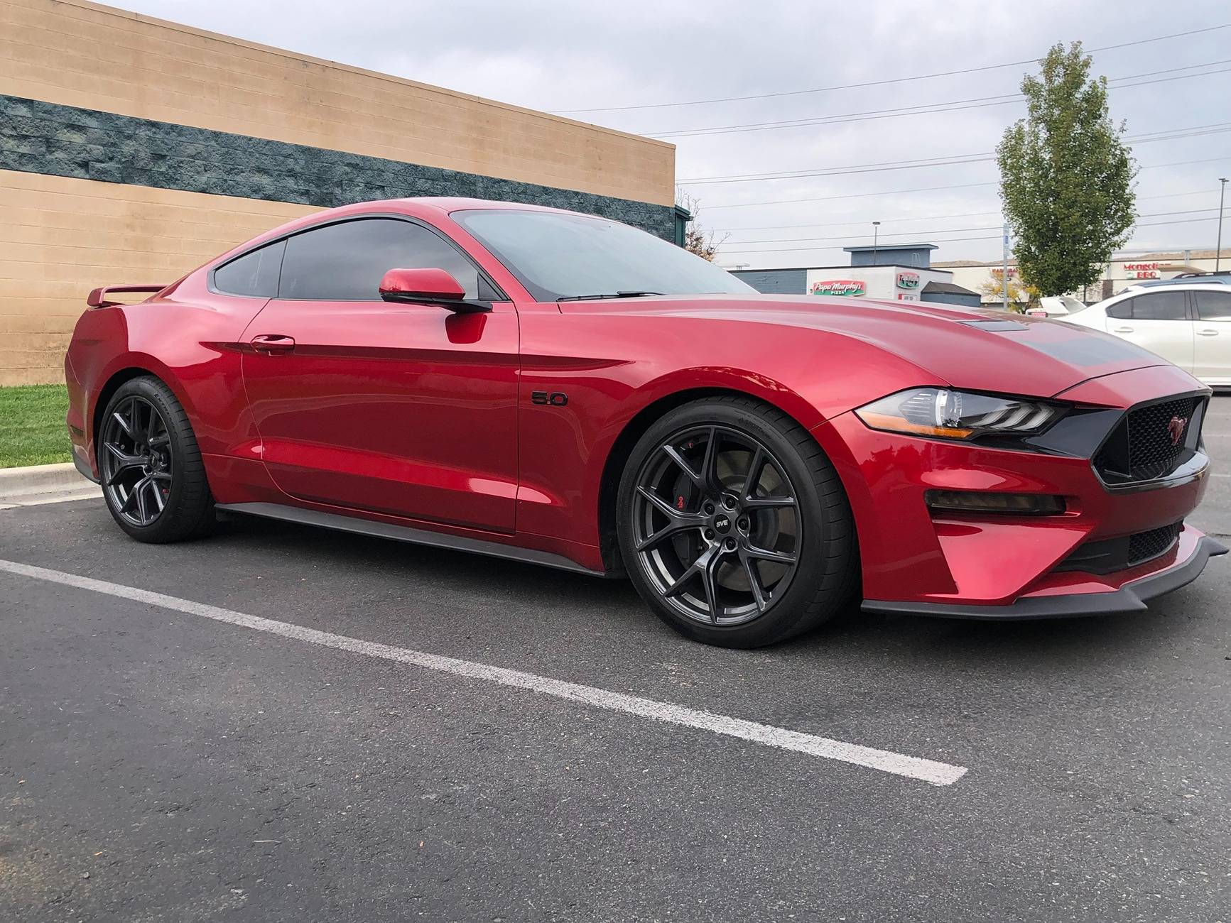

Outside before and after pictures would be great. Thank you.
These are the closest to being the same angle, my above pics are probably harder to tell.
I'm not sure it had completely settled in the second pic, it was just after the install and I was getting an alignment.
First is stock PP1 height, second and third are after.
