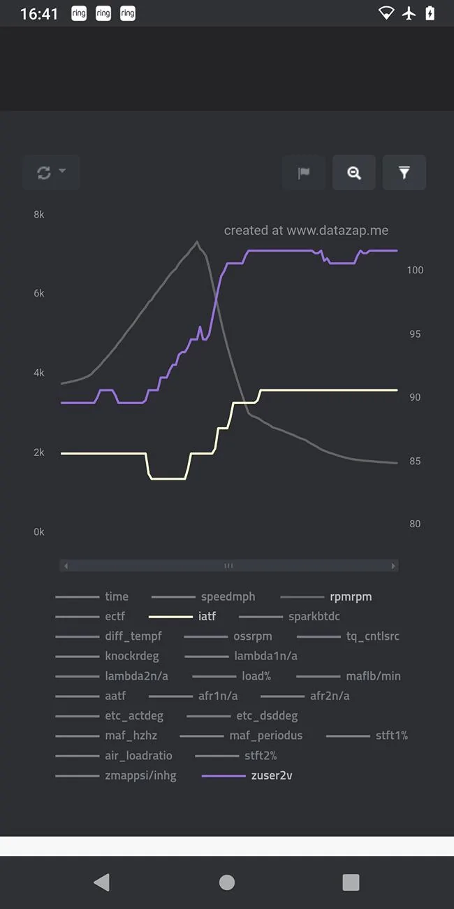

Oh and here's some randos data 🤦🏻, I can't confirm the accuracy but it's evidence that not all is what it seems with mikes data. But read the link above as it gives context.
Whipple guys log between iat2 and his more accurate ZT sensor, notice the data offset and reduced refresh rate?
white is iat2(Whipple manifold)
purple is more accurate sensor also in manifold
grey is rpm.
For starters, you can change the update rate in vcmscanner. Secondly, don't make the mistake of assuming the logger update rate is the same as the PCM logic's internal sample rate.
One other thing is, Dustin Whipple said in an interview on Enginelabs that they use part of fords fi program in their tune and that allows them to introduce a second iat sensor, he says it allows them to use the maf as iat1 and the Mapt as iat2 and minus one from the other to produce the delta. That allows the whipple tune to stay right on the edge for better knock suppression compared to other brands like roush ect, I wonder if that's why you are seeing such large differences with the whipple iat2? maybe iat2 is the delta between 1+2 and not the actual reading from iat2?
Did you miss the part where I tested the sensor in boiling water, an ice bath, and several data points in between to get a calibration curve? I stated this early in the thread and several times since then, and even offered to share the response curves. I actually used vcmscanner to log what the PCM is measuring and cross checked with a thermocouple in addition to the known water temps. It was +/-2 deg from 32 to about 120 deg F IIRC.
