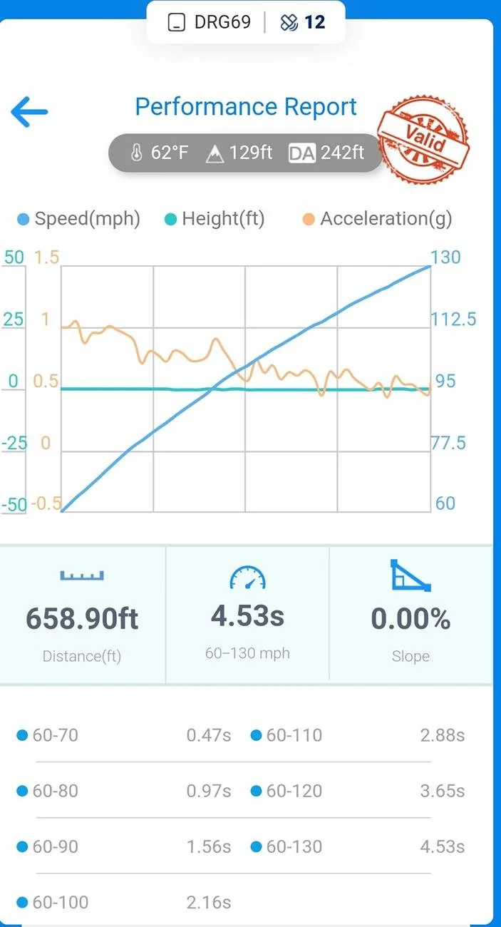

Here are a few videos I found during my SC research. He doesn’t say exactly how much power the GT500 makes (only that it’s close to 1000 rwhp) at the time of the Dragy run.
This one is the same 2019 GT with the ESS SC dyno’ing the 120MM and 110MM pulleys on the stock fuel system with BAP
Finally, the same 2019 GT 60-130 Dragy run.
