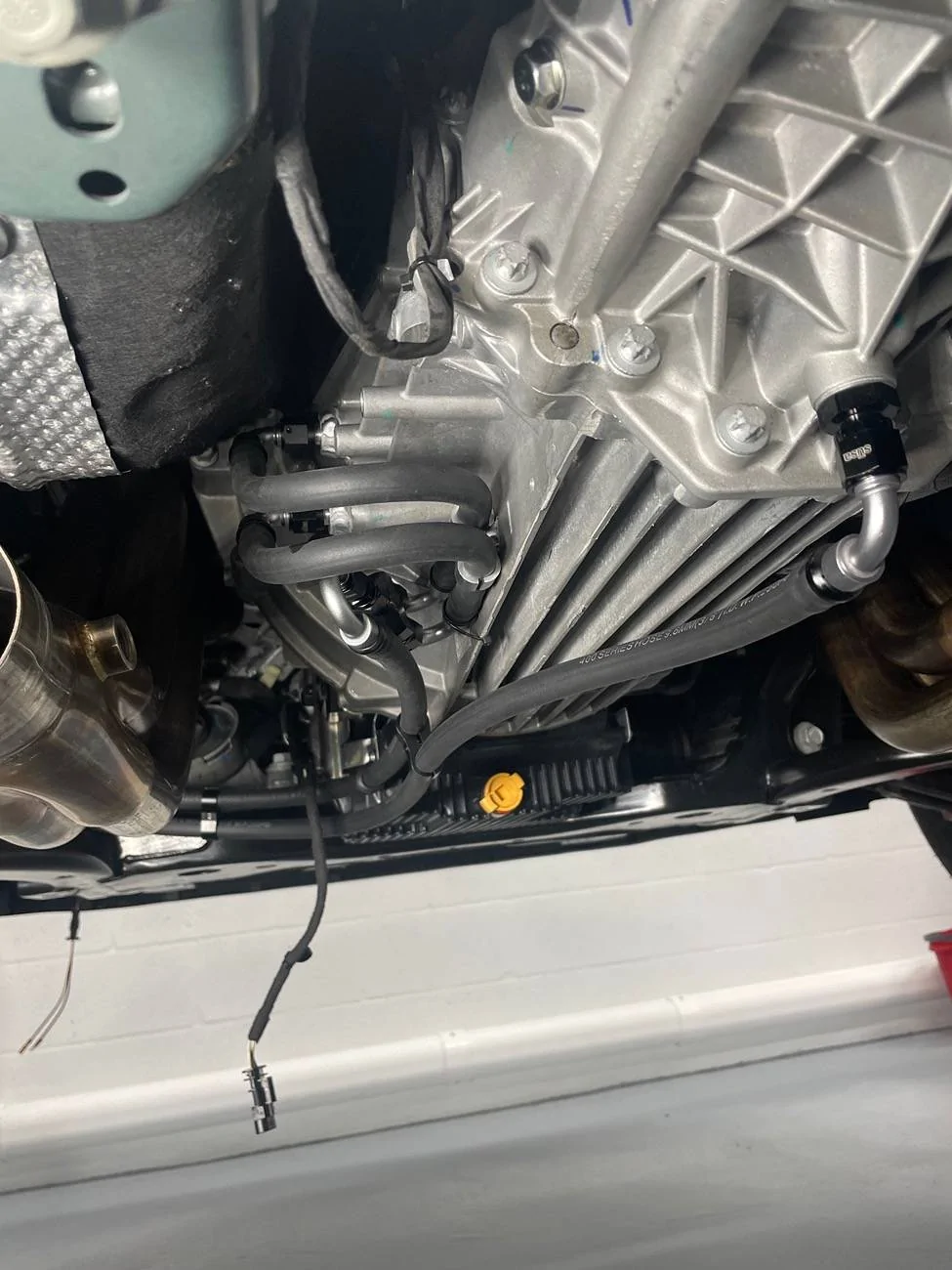

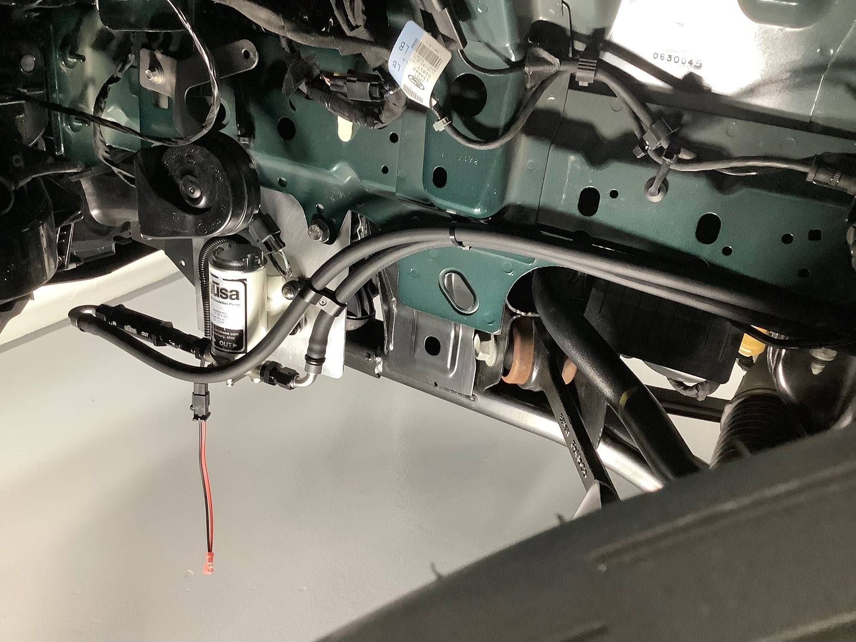

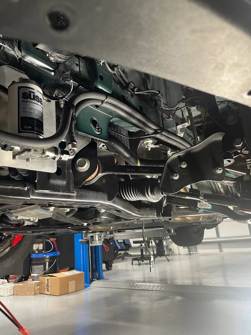

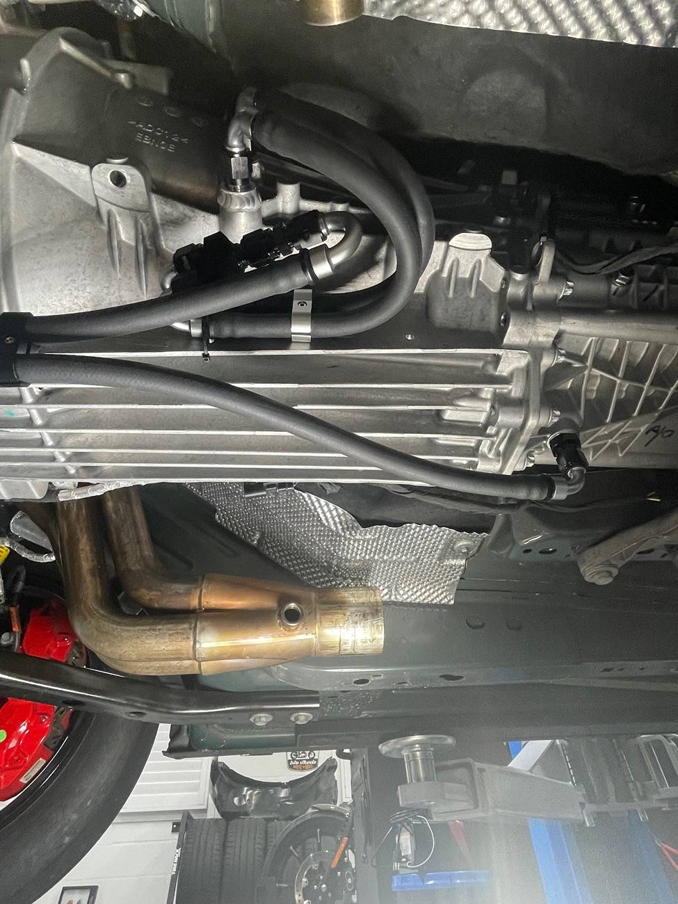

I need to stop reading this thread before I end up with a second power adder on my car.
I talked to ESS about retaining my nitrous system with their kit and they said I would be operating in uncharted territory, but recommended lowering boost a bit (which I was already aware of). If I do this, I would figure on making 700-750 hp on boost, plus the additional 150 hp with nitrous to put me around 900 hp. I should also mention that I am considering twin turbos as well (not sure whether top or bottom mount kit would be best). I like to think things through and do what will provide the most ease regarding maintenance, such as clutch, tranny and exhaust work.
I am really starting to think more about this, but do see some challenges with my current setup that I am not willing to remove or reconfigure. With that being said, I would need all piping etc. to clear these parts.
