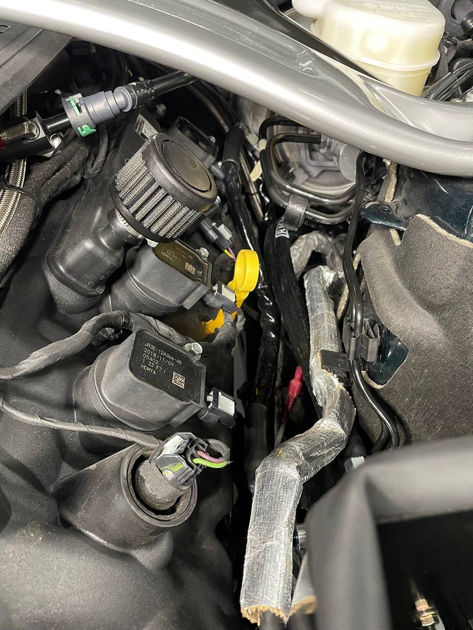

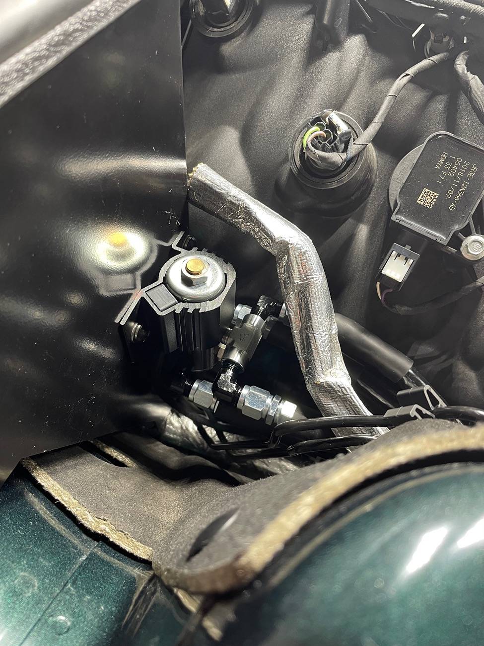

I also forgot to add this pic of my clutch slipper device and the relay mounting location for the external fluid pump. The SC or turbo kit would need to have ample clearance of these components as well.

In terms of clearance purposes or overall level of difficulty?
Both, also less overall maintenance and things to go wrong then with a twin turbo kit. A mechanically inclined person can put an ESS kit on a car in 4 hours by themselves taking their time.
If you wanted to keep the nitrous I'd do that kit on 10 pounds then use the nitrous when you wanted that extra kick. Those 2 power adders could be tuned to work well together and still keep the engine alive. Obviously also on E85.
