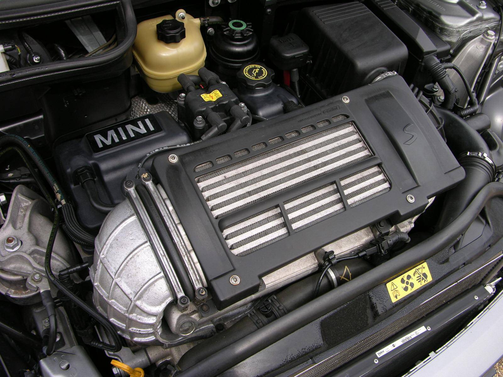

2006 mini cooper s, i own one so i would know, i believe its an eaton supercharger with a top mount air to air intercooler
Okay, so get that to work on the Mustang. There's no room under the hood for that shit and you would need a massive air to air intercooler to do the same job.
One more PD / a2a example and we can consider it a common setup. Post up data logs of that setup so we can quickly dismiss.

How could you even get an air to air system working with a PD supercharger?
That's exactly the point, you are fixed with a water cooler because of the constraints of the pd arrangement. That's why you need a super efficient and heavier method of cooling it down and only a few companies have managed to make it a success, whipple 3.0 and all the top mounted vertical flow pd setups.
Do you understand now what I mean when I say "I chose a setup that didn't have the problem to begin with?" Holy moly this is tiring!!!
Yes it works, does it mean it's the best way, not really!!!!
