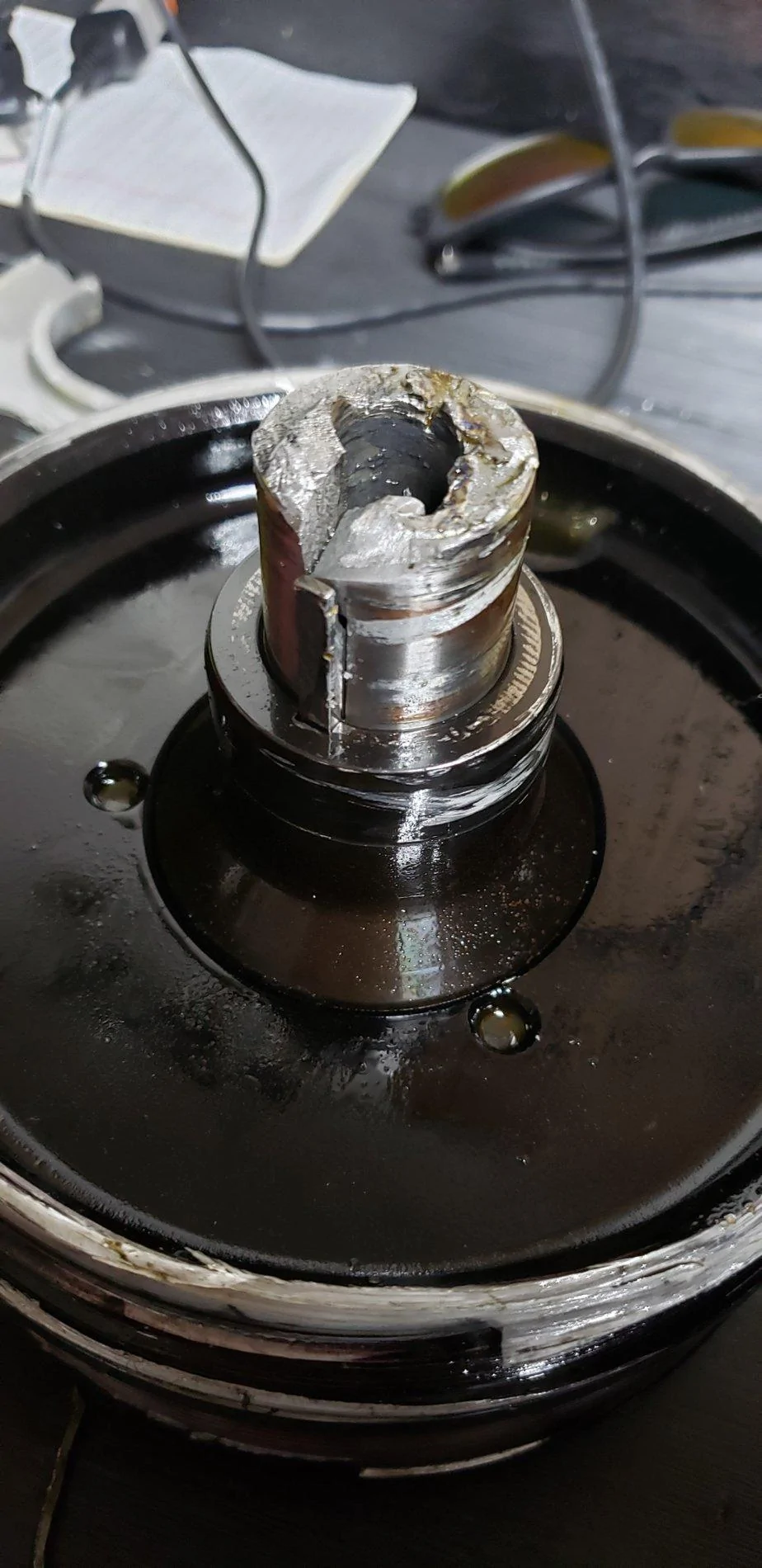

People have snapped snouts with the MMR, ATI and Innovators West balancers. The coyote snout is 1.250 dia and there is no fillet radius as it's undercut, I think most of the problems are due to an installation error. Either the balancer was not bottomed out and seated properly or the bolt broke or backed off, use of an ARP bolt and Loctite are a must. The whole story is never told after a failure then the truth comes out that they re used the factory torque to yield bolt or the bolt backed out.
I think another install issue is that people are not checking for the proper interference fit. Even measuring the fit (8-12 tenths of a thou) takes specific tools (micrometer, snap gauges, and/or small dia bore gauge), and they can't be cheap for this tight of a tolerance (wouldn't trust anything less than the Mitutoyo variety or better). Add to that, experience is needed with these tools to use them repeatably, the average home mechanic ins't going to take them out of the box and be an expert on them, they take a "touch" to measure even +/-0.0002.
Then to accurately hone the damper, you need to find a shop with a Sunnen that knows how to use it down to the tenth.
I would say most installers skip the above steps, leading to "troubles" installing the damper causing people to heat the hub and/or use excessive force to install.

Another typical install issue is the usage of a long bolt to pull on the damper. Not a good method anyway, but the installer also has to stop tightening the bolt at some point before it bottoms out, then switch to the shorter bolt to pull the damper on all the way. I wonder how often they bottom out the bolt, then overtighten it before realizing it has bottomed out, possibly causing damage to the snout from inside where the threads end.

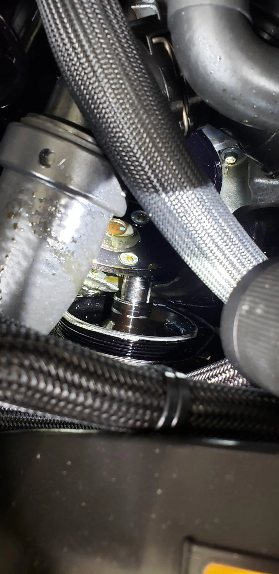

Vanillakuryla
Mar 1, 2019
40
Brentwood CA
Jarod
2016 Mustang GT
I bought my car Monday and snapped the snout off Wednesday. Pretty upset. May end up parting the thing out. The person who owned the car before me had purchased some sort of alternator support bracket because the 10 rib system broke the pulley off the alternator and bent the bracket. I guess the snout was the next weakest link. I'm guessing the dampener wasnt properly honed or installed.
olaosunt
Jan 10, 2015
72
4,291
1,575
Indiana
Guard,base,M6,KB-2.DIB,auto,Hellion TT,2016 GT 350/Gen 3 Whipple ,2018 Mustang GT/Gen 5 Whipple
Oh man !
I am so sorry but can truly say I know how you feel .
What mods on the car ? Whipple with 10 rib upgrade ?
Vanillakuryla
Mar 1, 2019
40
Brentwood CA
Jarod
2016 Mustang GT
Oh man !
Well from what I know, 2.9 Whipple with ported lower manifold, Cams, 10 rib, phasers, billet oil pump gears, stainless works long tubes, non catted Corsa catback, DSS axles and driveshaft, Fore Dual pump fuel system, ID1000's. Thats just the basic stuff I know of under the hood.
