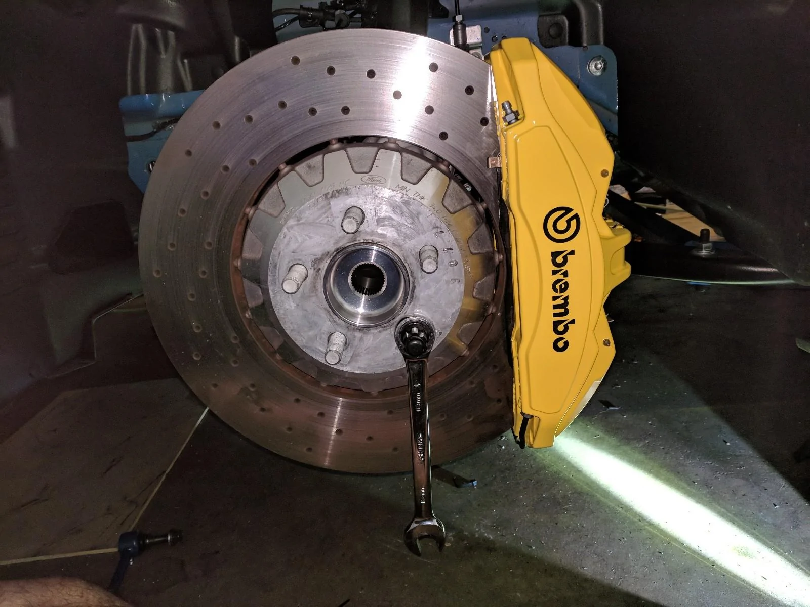

Fronts are in with steeda competition springs. Didn't get a chance to bleed them.

Well my brakes are extremely mushy. I have no idea why. I used 1 gallon to bled the brakes . Might have to bleed the abs again.

Those yellow brakes look great ! I have a LB and was looking to do yellow, when you get a chance and you get the air out of the system, post up some pics.
Are you using something like the motive power bleeder or the "pump the pedal" method?
Ive had great luck with the power bleeder. Much less luck with the ol' pedal pump .

Yes I am using motive bleeder and have been for last 7 years. I bled the abs moduel with my autel 3 times and the pedal now is back to normal. I am sure I got air in the lines from the abs moduel so I have to bleed that out again.
For anyone that is going tk take off the caliper and disconnects the brake line, you must have a scan tool to bleed the abs moduel.
Will do most likely this weekend.
