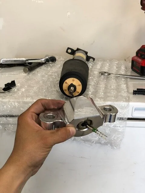

Well... there's a video on the web somewhere that shows how to do this. Depin the connector shell, slide the nut off over the (now loose) wires, swap the upper mount, put the nut back on and then push the pins back into the connector shell. Easy, if you've got the tools and the experience.
The way I remember it, there's something about the aftermarket upper mounts that requires a new nut to hold the shock. I don't remember the details, but this is tricky because the shock is threaded M11x1.0, which is an oddball size that's not so easy to find. IIRC, the guy that posted the video actually took a smaller nut intended for a different shock (M10x1.0 maybe) and reamed it out and re-tapped it to fit the magride shock.
EDIT: I figured out what the video was about - it was installing Steeda upper shock mounts, and they have a combination nut/sleeve to fill the space in the spherical bearing. That's why the nut had to be reamed and re-tapped - it wasn't a nut, it was a special part.
Good stuff, he did a solid job figuring that out.
I made an attempt at de-pinning and decided I didn’t want to damage the connector since these aren’t sold separate. Though that’s obviously the best way going about releasing those wires Lol. Once I found the proper diameter sleeve with the Steeda mount, reusing the factory nut wasn’t an issue.

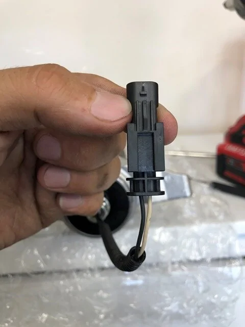

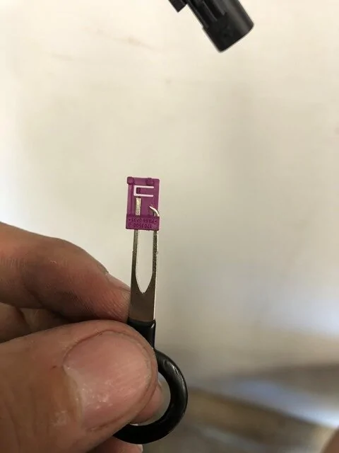

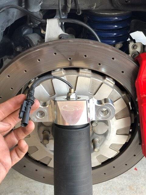

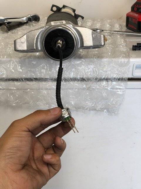

@JAJ @galaxy

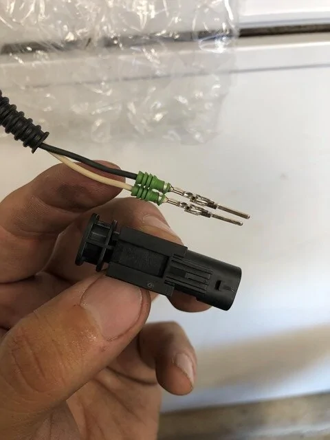

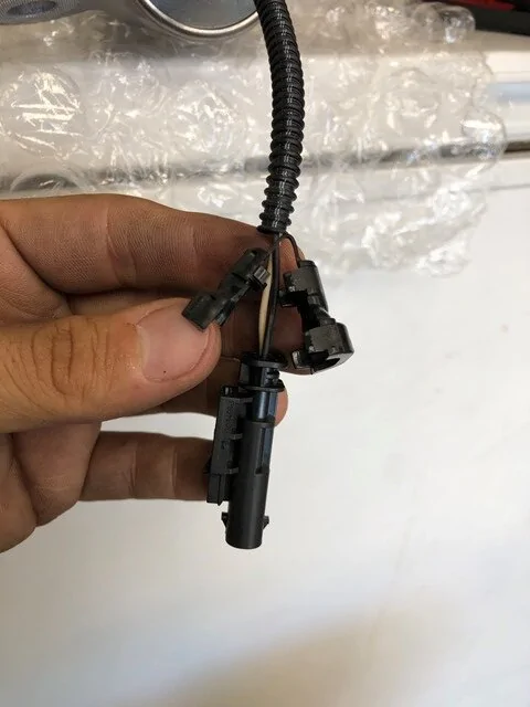

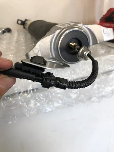

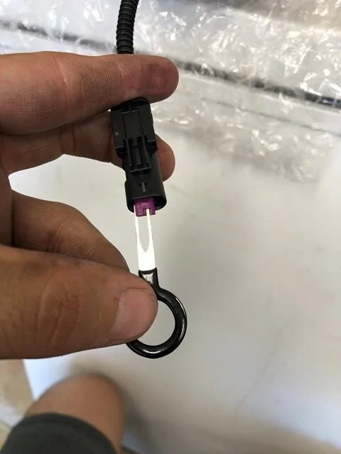

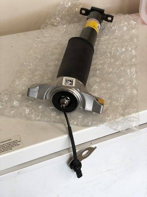

So I had to replace the magneride shocks and struts due to a rear shock leaking. I decided to de-pin the connector this time since JAJ mentioned there was a video out saying it has been done before. Picked up some tools to de-pin and went at the old shock connector with a Dremel to dissect it. I figured out how it comes apart and was able to perform a much cleaner install this time around....

@Kobi Addiction That's Legit man. I had seen that elsewhere also. Only thing I've been holding out for is a for sure, easy solution for the nut, or whatever needs to be done (don't recall what you did about the different nut size)... @tj@steeda
