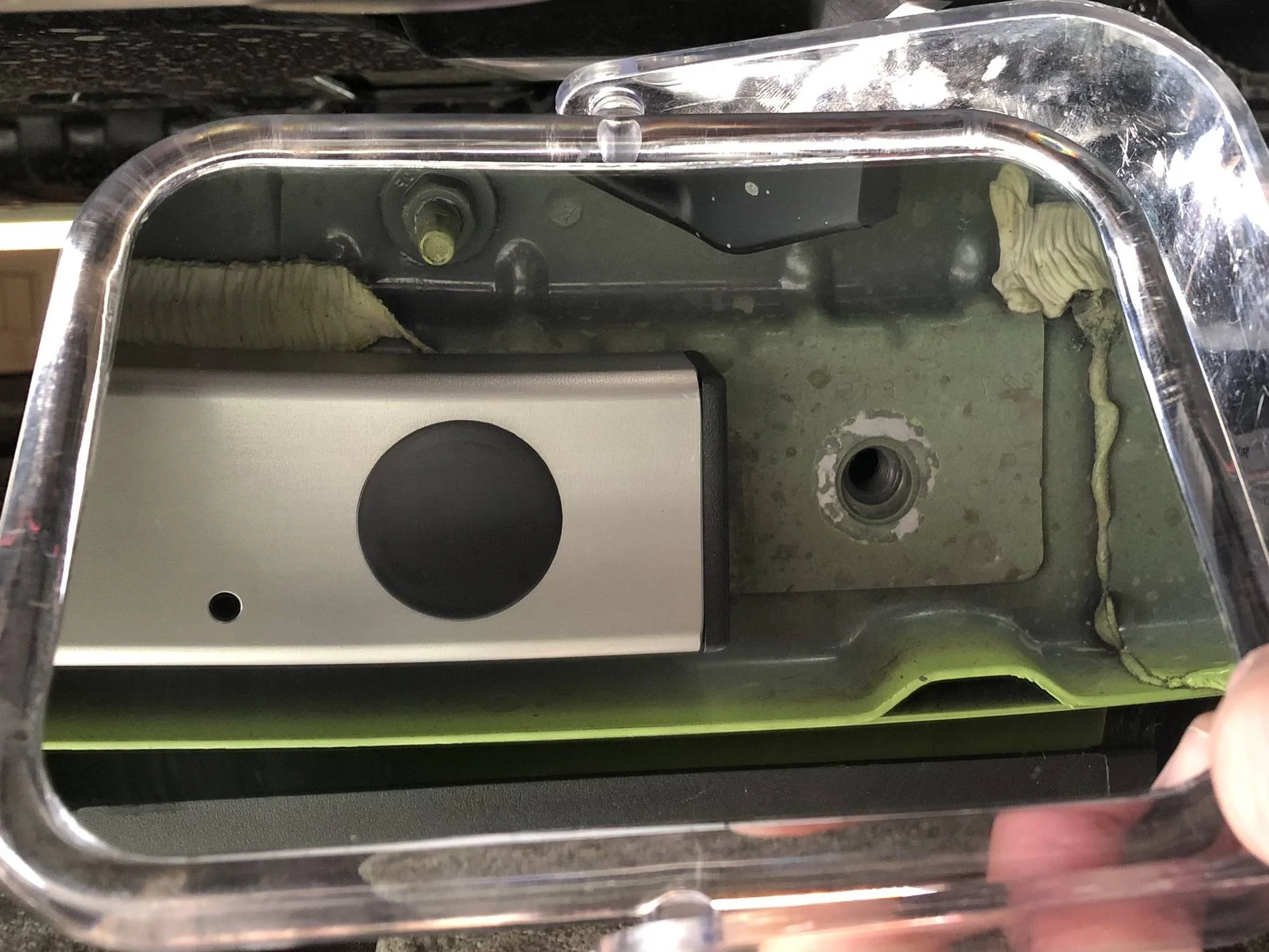

Jacking rails fitted - with a sigh of relief that all the measurements and marking out were OK so I didn’t need to get the die grinder out ... lol
From front to back, the frame rails holes are now used for :
  • 1 to 4 = Jacking rails.
  • 5 & 6 = IRS braces (yet to be fitted).
  • 7 = Spare (supplied empty from ford - now with a OE bolt blanking it off).

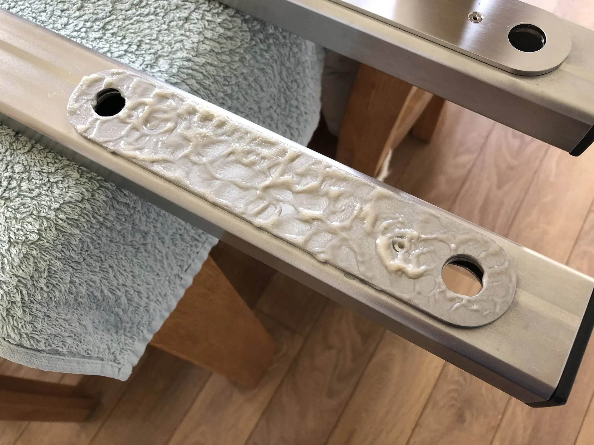

Covered the pads in waxoyl before fitment :

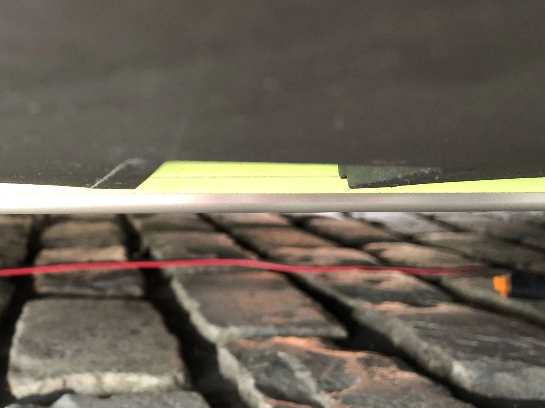

Protection for the pinch welds is about 8mm which is exactly what I was after :
