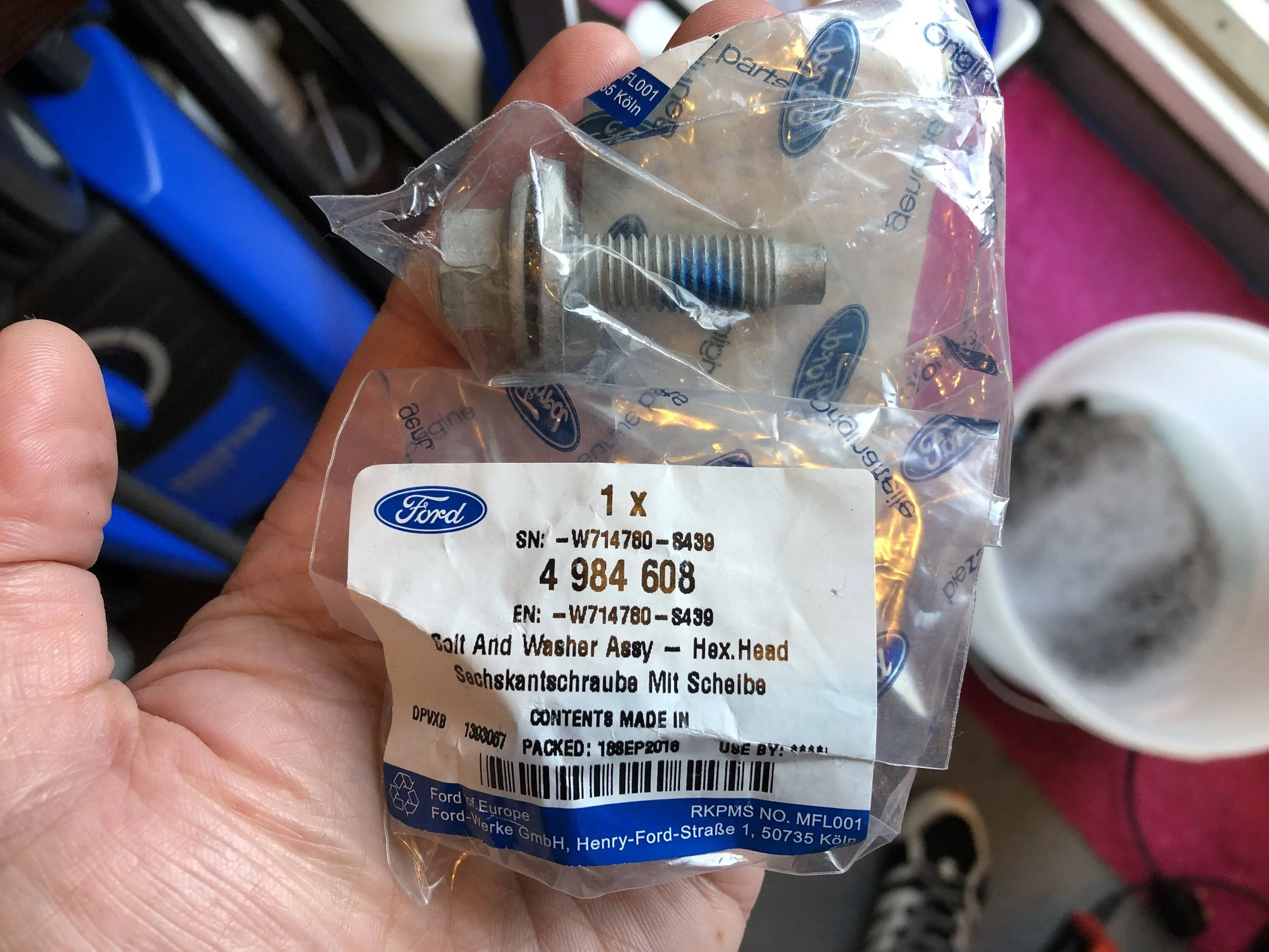

I’m pretty sure they are standard M10 x 1.5, but I can nip to the garage and check if required :like:

along with using the correct supplied bolts from the beginning.
Nothing wrong with the ford bolts, in fact it could be argued they are superior - 10.9 grade, large captive washers, nice plating, pre coat thread lock and ironically, a lead in to try and stop cross threading :like:
