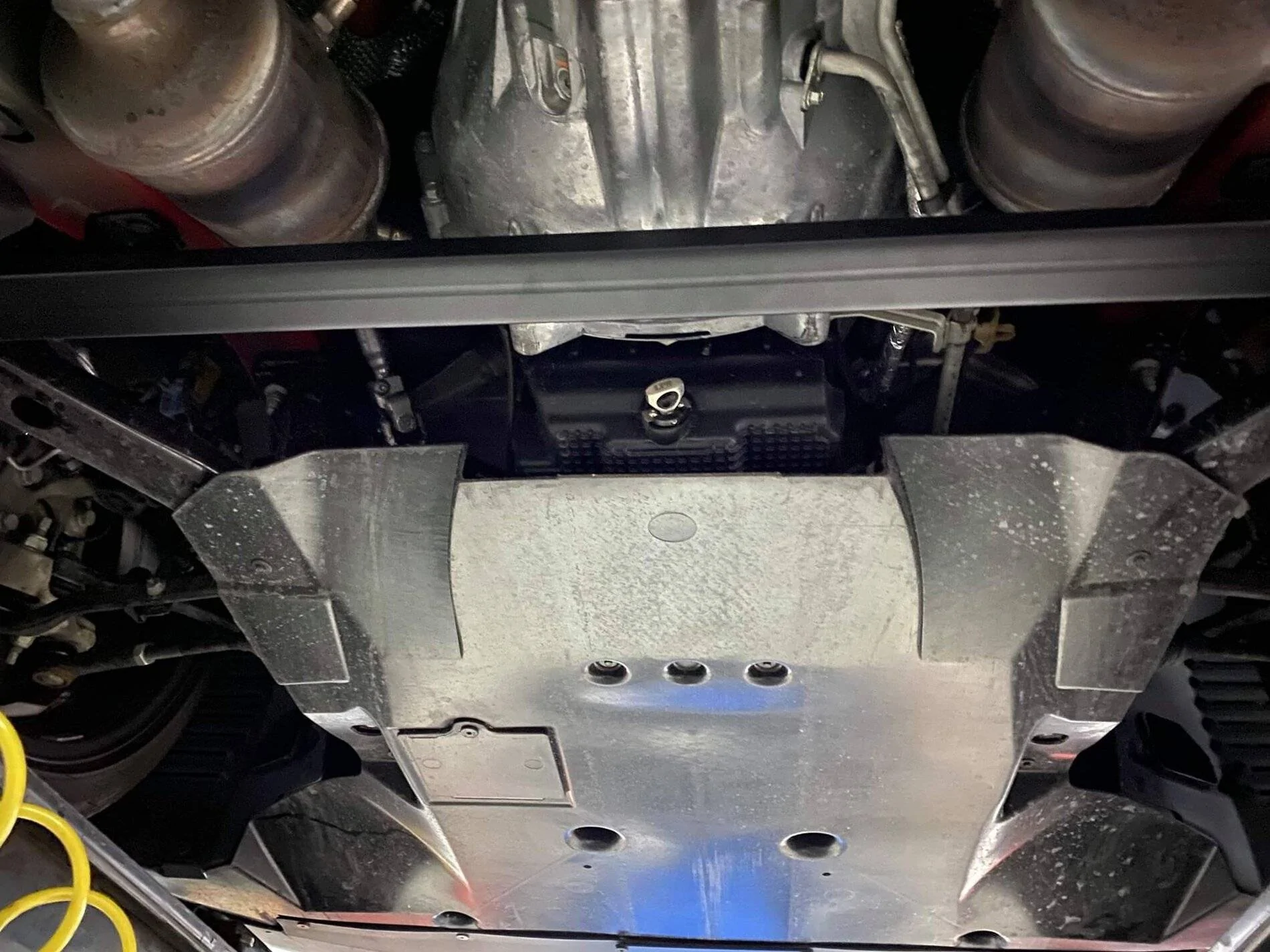

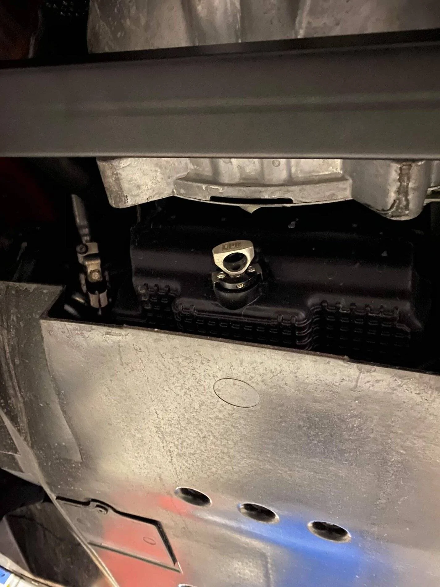

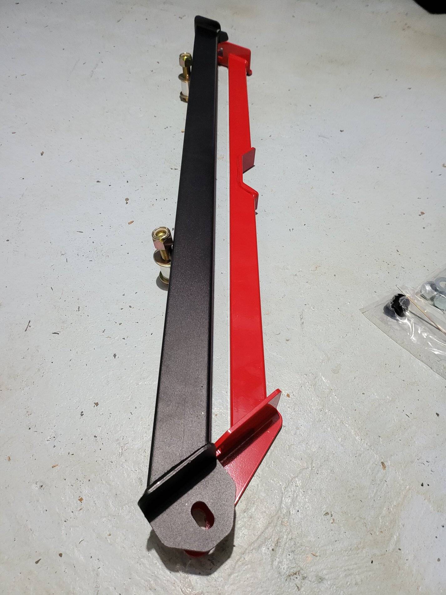

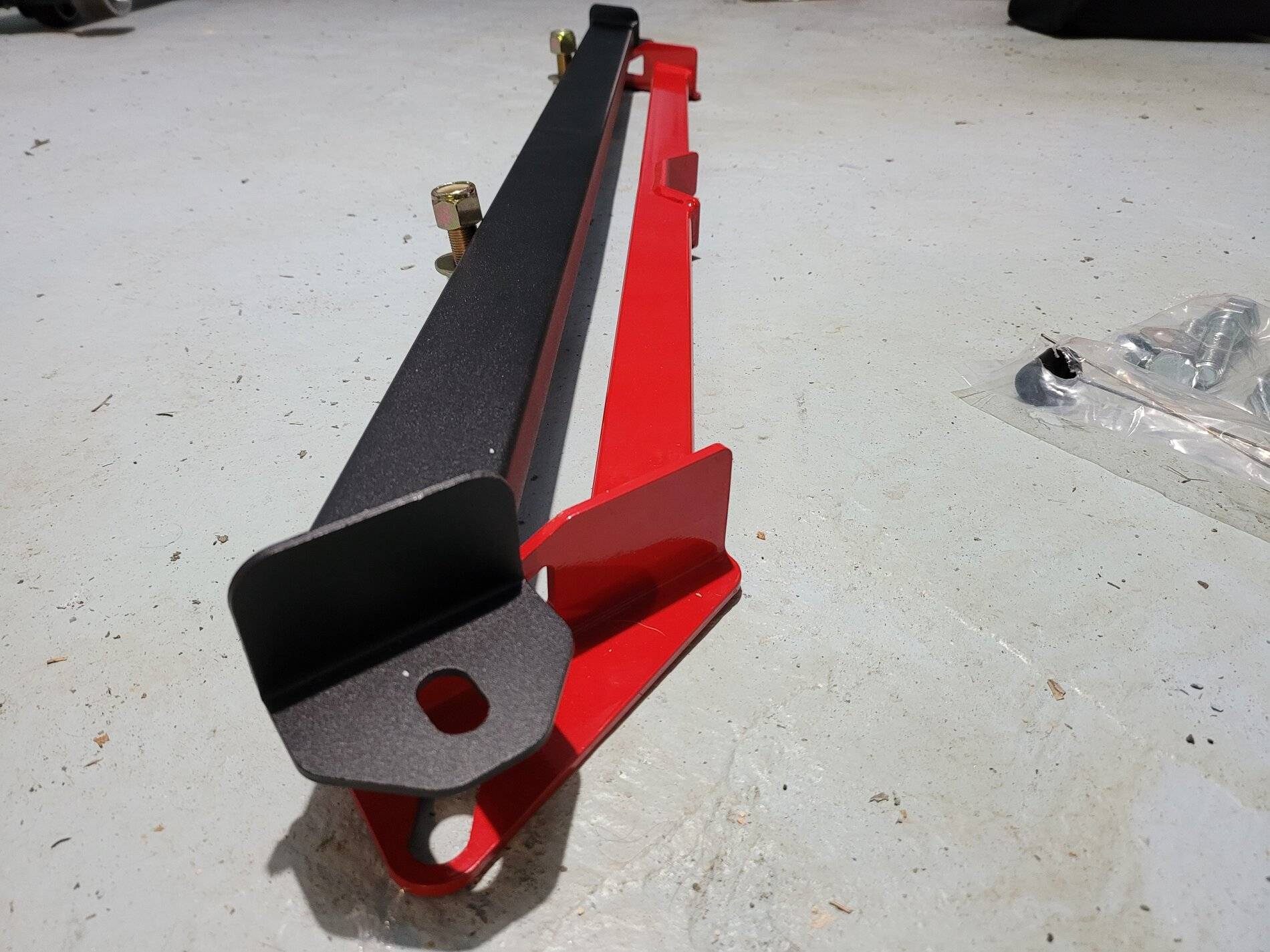

Also, BMR vs. Steeda 2-point front Subframe G Trac brace. The Steeda sits back quite a bit further. In terms of one being better over the other I have no idea. They both were super high quality. BUT, because I have the bigger UPR oil drain plug, I couldn't remove the drain plug with the BMR Brace. No issues at all with the Steeda (see photos: BMR is red, Steeda is black).
No idea if this helps anyone but I couldn't find it anywhere on the forum. (debaiting on making it its own post to help others).

Thanks for the info, I have the same drain plug. I also like that the Steeda center section is one piece.

Thank you for those pics!!!
I was about to purchase the BMR, but it looked way too close to the drain plug.
