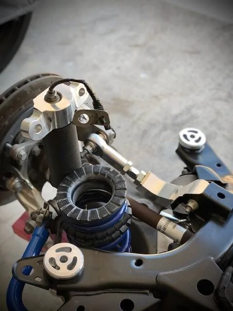

My vehicle is 100% street driven right now, and didn't need a dual rate spring which seems to be more tailored for the track. I still wanted that comfortable ride, but still able to perform when needed. I also liked the idea of a 1" drop. Their dual rate option along with the FP springs, only lowered it .50 - .75".
The reason for the non-magnaride notation is due to the wire and connector coming out of the top of the shock. The only way to install any aftermarket shock mount on a magnaride vehicle is to cut the 2 magnaride wires and splice back together. There is no other way around it, I've tried Lol. I bit the bullet and cut the wires for the installation and I have not had any issues using the suspension modes.

....The only way to install any aftermarket shock mount on a magnaride vehicle is to cut the 2 magnaride wires and splice back together. There is no other way around it, I've tried Lol. I bit the bullet and cut the wires for the installation....
Oohhhhh....gutsiest move I ever saw, Mav! LOL!
Seems like there'd be a plug or something on the non-shock end that one could route through, but apparently not.
True, that was my initial thinking. Then comes the nut that tightens the shock mount to the upper shock. Once you loosen the nut to remove the mount, it won’t fit over the connector for removal.
When the shock is being assembled with the factory shock mount, they must add the connector last. Which is another reason why you can’t purchase a factory shock mount separate, it all comes together with the shock/strut assembly.
Well... there's a video on the web somewhere that shows how to do this. Depin the connector shell, slide the nut off over the (now loose) wires, swap the upper mount, put the nut back on and then push the pins back into the connector shell. Easy, if you've got the tools and the experience.
The way I remember it, there's something about the aftermarket upper mounts that requires a new nut to hold the shock. I don't remember the details, but this is tricky because the shock is threaded M11x1.0, which is an oddball size that's not so easy to find. IIRC, the guy that posted the video actually took a smaller nut intended for a different shock (M10x1.0 maybe) and reamed it out and re-tapped it to fit the magride shock.
EDIT: I figured out what the video was about - it was installing Steeda upper shock mounts, and they have a combination nut/sleeve to fill the space in the spherical bearing. That's why the nut had to be reamed and re-tapped - it wasn't a nut, it was a special part.
