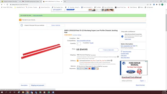

I have the BMR rails and got them specifically because they were longer and parallel to the ground. I love mine. I'm sure the Steeda rails are sufficient and they are cheaper. I just wanted the ability to space jack stands on the rails as far apart as possible.
Exactly the same reasons I bought BMR rails.
wcharon
Sep 23, 2018
684
298
PR
William
Ford Mustang GT 2019 Race Red with Package 301A
Thanks @Nightmonkey .... Seems that we are in sync as i placed the order 10 minutes ago thru eBay as it was free shipping directly from BMR.
Thanks for your help and support.
