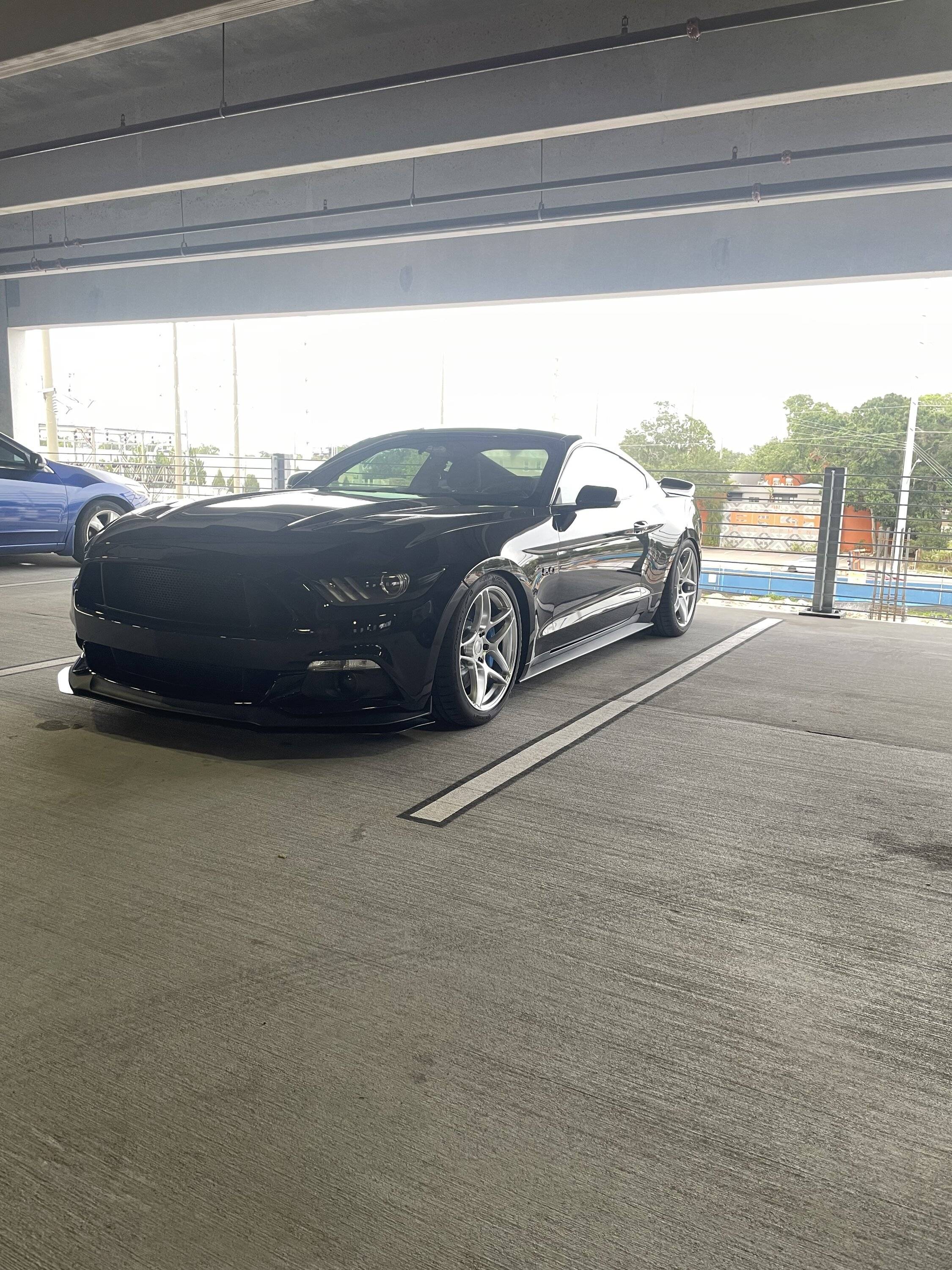

I have a 2017 mustang GT manual, my first performance car, whatever you’d like to call it. Certainly never driven any rear wheel drive car with this much torque. I’ve had it for about 3.5 years, stock, aside from air filter, exhaust, suspension, and tires. Only other mods are cosmetic. It has 52k on it currently. I am almost finished school and now have a garage to keep it, along with the money finally to do something fun to it.
Ideally I’d like to slap a Paxton on it, or TT. At 52k, is it still okay to just throw power at it? Are there any supporting parts or replacement parts I should be replacing before if go this route? Just looking for a starting point and some general advice for a newbie. Thanks 🙏🏼

Your car looks great man.
