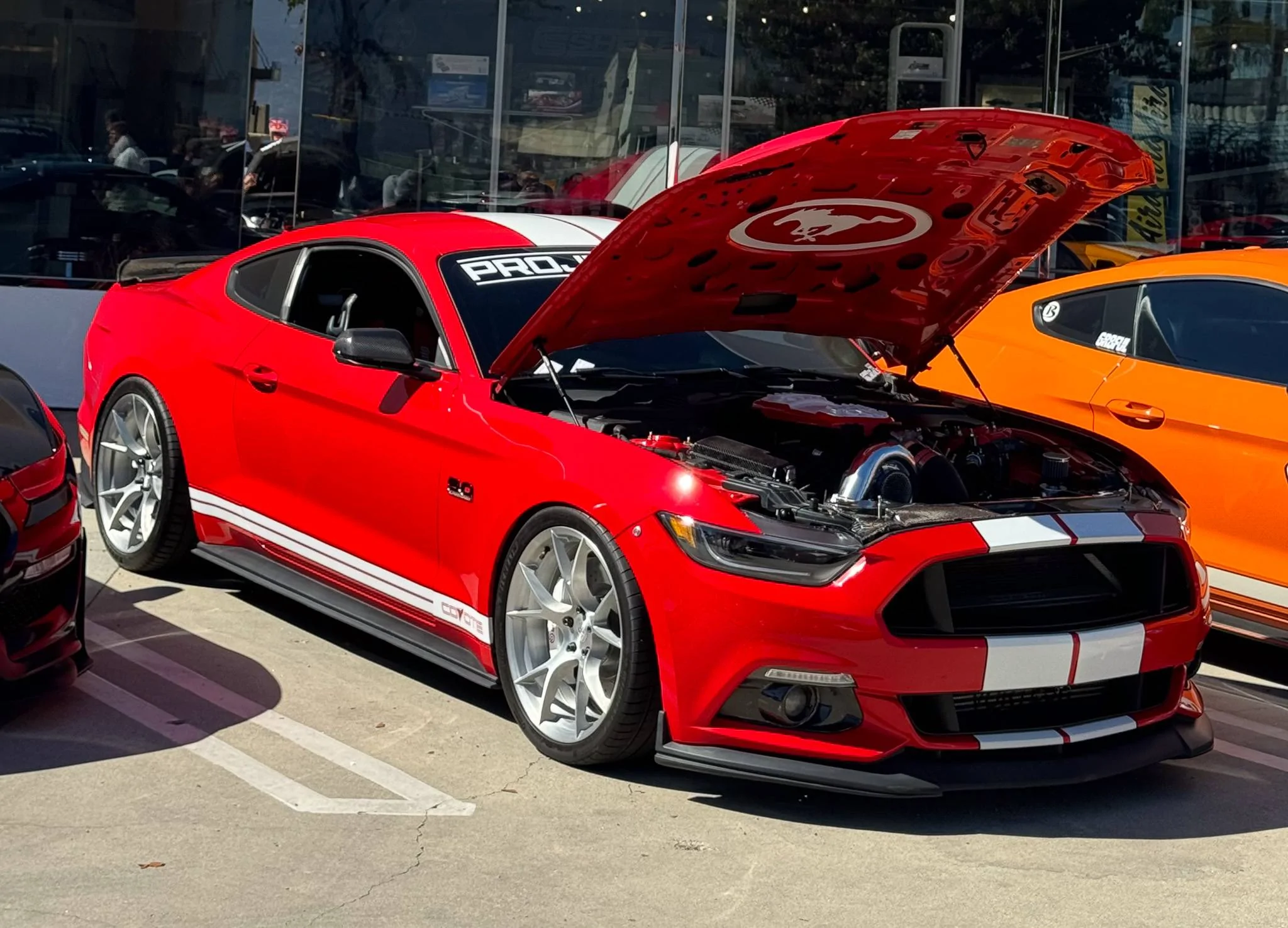

Hey John, this is Junior from N4SM. This is my Vortech Supercharged Mustang on E85, I boosted it at 50k miles and it's been great. Billet oil pump gears are something I highly recommend when going boost. Drag radials are your best friend these cars are tail happy. Since you are fairly new to the RWD V8 power it might be a good idea to setup the car first with bolt ons so it's ready for boost later. I started with intake, tune, headers, gt350 manifold and e85. I most importantly learned the car and enjoyed it at that power level. After I did the vortech on E85 and jumped to 800whp. Big power difference from 450whp bolt ons. The best advice I can give is to learn and feel comfortable with the car first before throwing boost at it.
