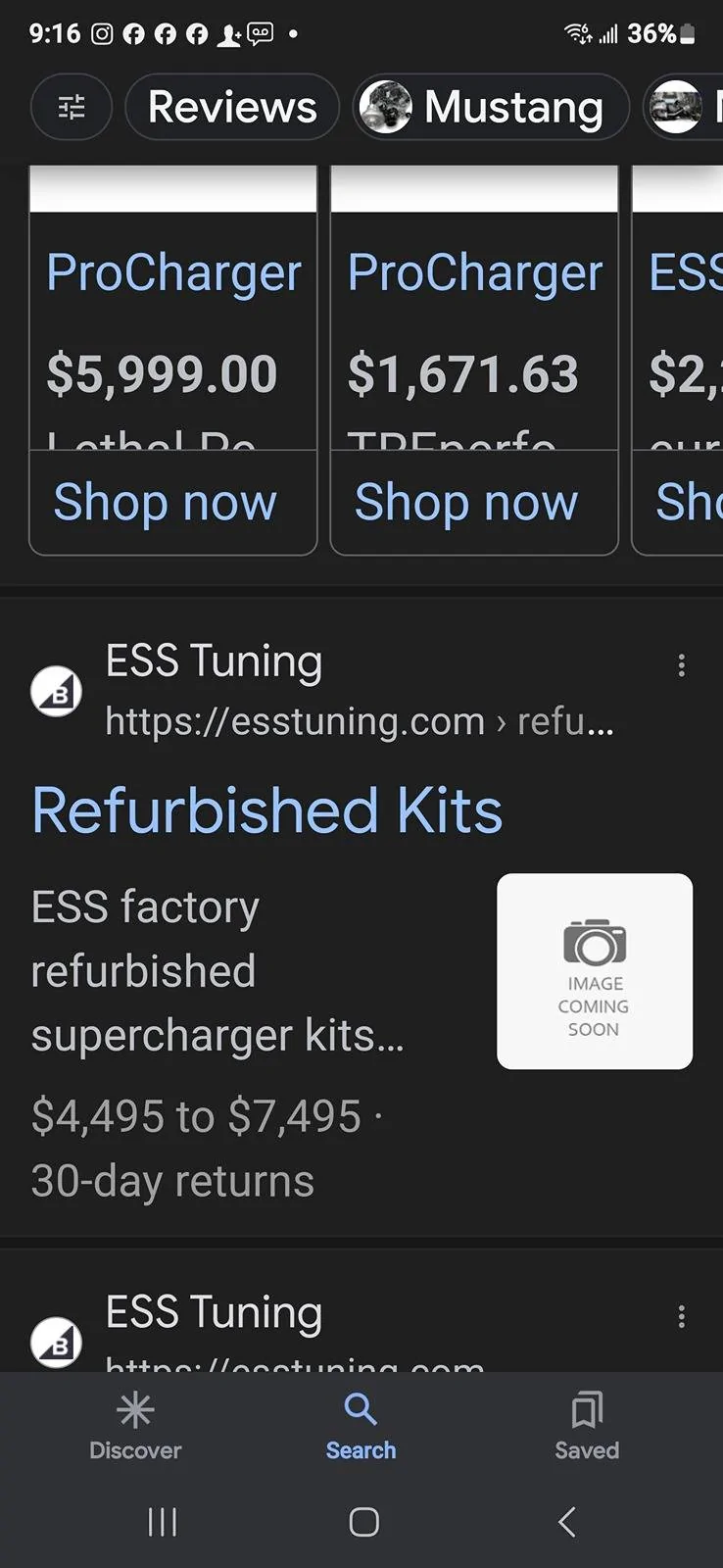

Chek this out it might help you with your decision, you get all new parts with the same warranty as a new on.
