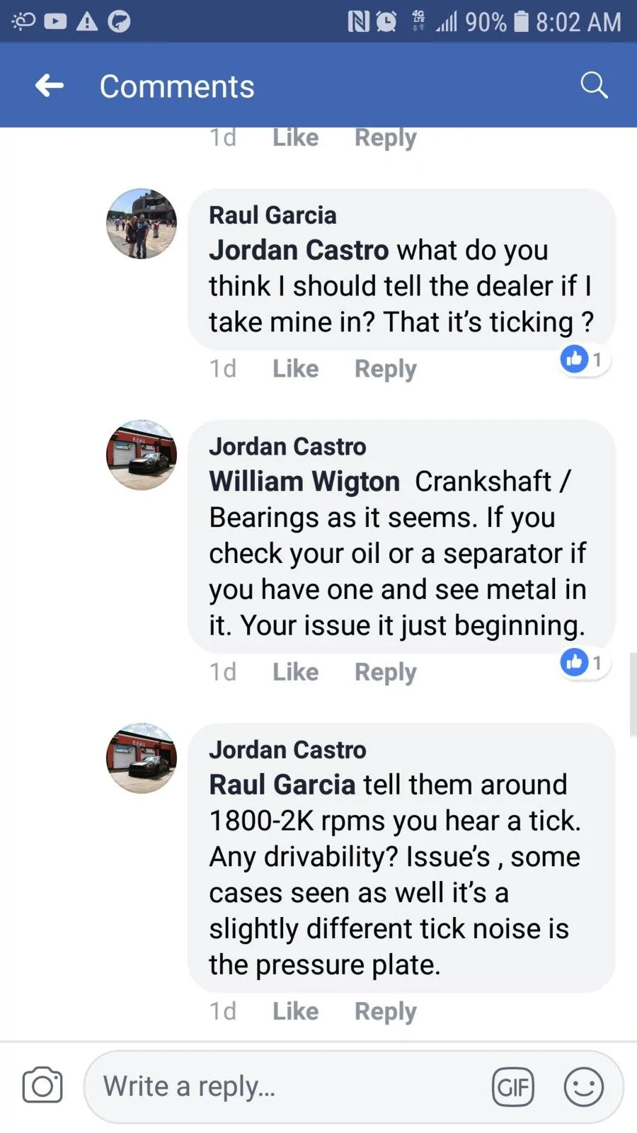

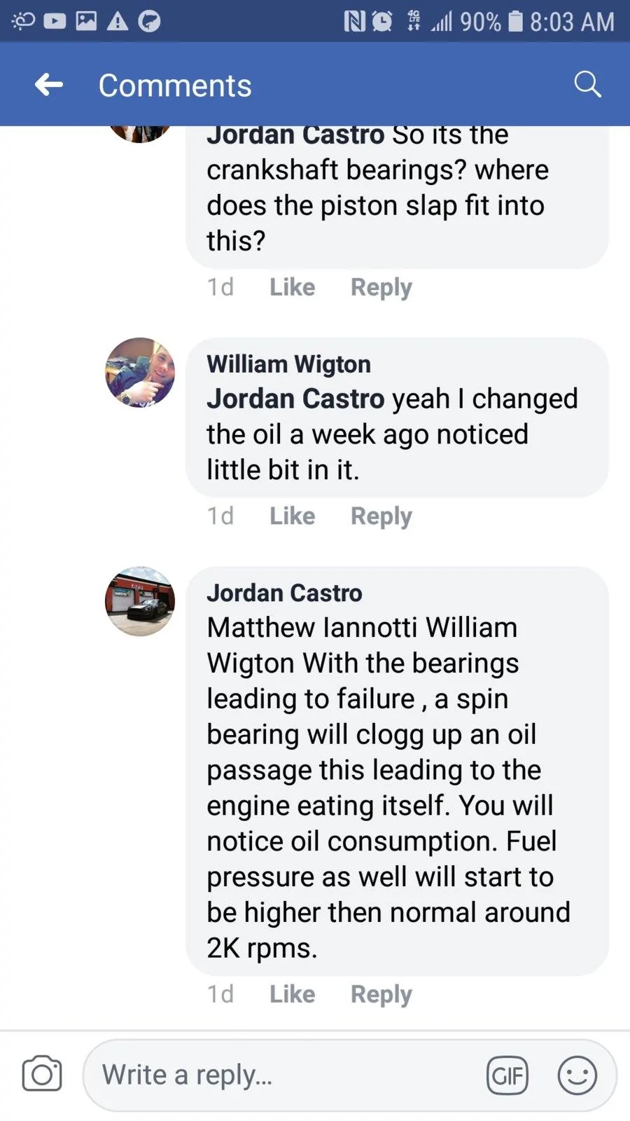

After more investigating, it is indeed a bearing clearance issue on the crankshaft causing what ford calls "typewriter noise".
Is it the journal surface clearance itself, or the side clearance causing the rod base to tap the sides of the crankshaft?

The heavier weight oil is just increasing oil pressure, just masking the real issue by the way.
No links yet.
My car is scheduled to be dropped off, of course dealer tried to say they haven't seen the issue LOL... Until I told them to use the computer and look up how many open issues exist nationwide in the service dept for the same exact problem, yes they can see all the open cases from all other stang owners.
The tapping on cold start is due to lack of lubrication on those bearings.
Condor do not know yet.
No links yet.
How did you come up with this conclusion? I still think its piston slap.
