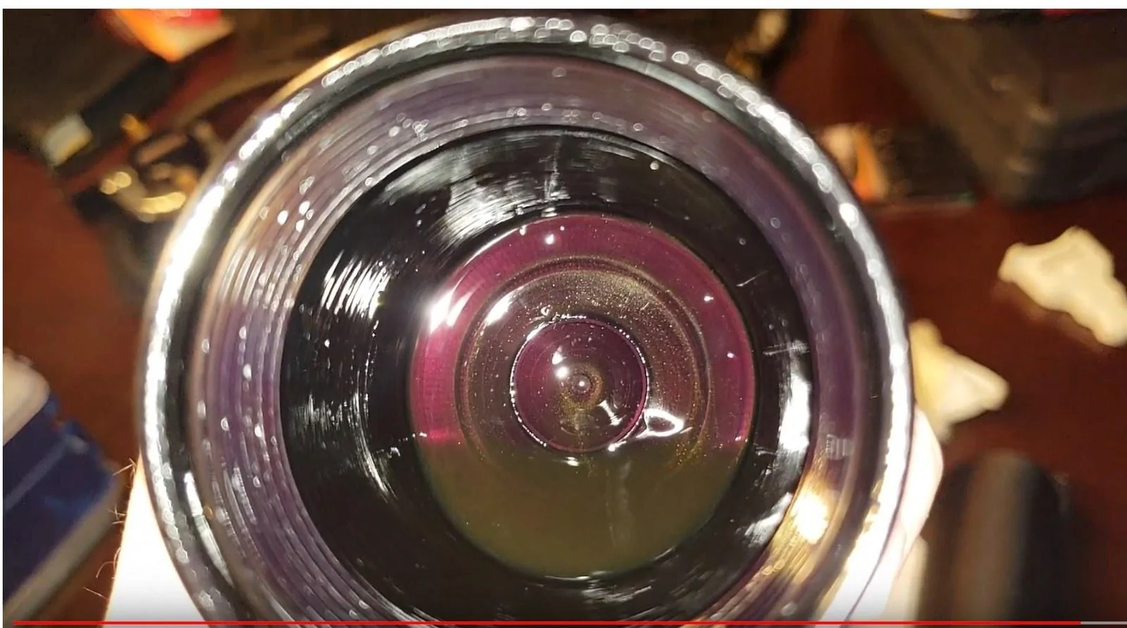

Holy shit I just checked my catch can with a flashlight and wow... :
This is not good. Car is at the dealer, I took the can off before bringing it there so they couldnt try to blame it somehow.. Looked at the can oil after I got back.. I wonder if I should have left it on.
This is with only 700 miles on the oil. I changed out the break in oil at 1175 miles this was at 1850. Drained the can like at like 1600 miles few days ago too but didnt check for metal.
Just tell em you know there is metal in the oil, you pulled a small sample and saw it yourself, wouldn't tell them about the can.

If you search about "glitter" or metal in catch cans you may find it's pretty common (often said to be from the filter element in the can). Allot of responses also seem to say it's difficult for metal to come through the PVC system, so unlikely.... I did allot of reading after seeing the sparkly badness first hand...I'm not the expert but if the internet in general is to believed this isn't the same thing as seeing it in your oil filter or oil drained from the oil pan.
Mine looked like his, with a few slightly larger junks.
Bigger pieces were more shiny, almost like an aluminum.

Everyone with flakes in their catch can, did you clean the threads & can before installing it?
Your late to the party, there were no shavings the prior 4-5 times we emptied them.
Understanstable, only asking because when I received my gen 1 JLT Catch Can it had metal flaking off the threads and at the time I remember seeing someone post about “cleaning your catch can” beacause of manufacturing remnants. When I upgraded to my UPR Catch Can I cleaned a small amount of fine flake off the threads but assumed I’d find some in the Can at some point in the future.
