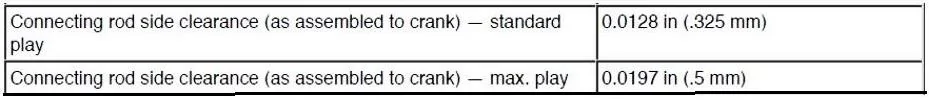

Yes, I checked. The tech told me that standing connecting rod side clearance was .325mm and max was .5mm. He said two of mine were over .8mm and all is the rest were between .5mm and .6mm
You did see this post from @Superchomper2003, right (Post #11). Look at the specs he quoted and compare to the table I posted.

Yes I did see that , but what I was asking is where are you getting the illustrations checking rod ide clearance . I can not find it in the serive manual .
GT Pony
GT Pony
Mar 13, 2015
77
9,402
4,839
Pacific NW
Like I said and you said ... the service manual doesn't show how to check it or to check it. But that doesn't mean it's not important, otherwise they wouldn't even show the clearance specs?
So what if engines are coming out of the factory with excessive side clearance - an obviously there ARE because some guys say their shop measured it and found some rods to be out of factory spec. If nobody ever checks it because the manual doesn't says so then that's crazy IMO. Any engine guy should know about rod side clearance, and if there's a spec listed in the manual he should check it.

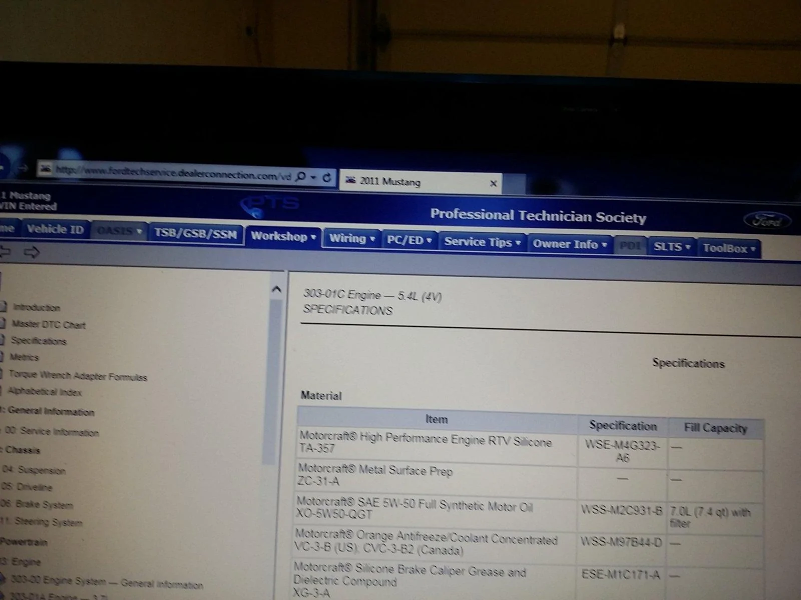

Here you go . Can we agree to disagree ? Oh by the way I have one of these
GT Pony
GT Pony
Mar 13, 2015
77
9,402
4,839
Pacific NW
Looks like you're looking at a 2011 shop manual (top of the screen). And the Section says 5.4L (Shelby GT-500 engine).
Look at a 2015-2017 or a 2018+ ... 5.0L. I'd venture to say all modular Fords will most likely have the same rod side clearance specs.
What's your manual show for the rod side clearance on a 2018+ ?

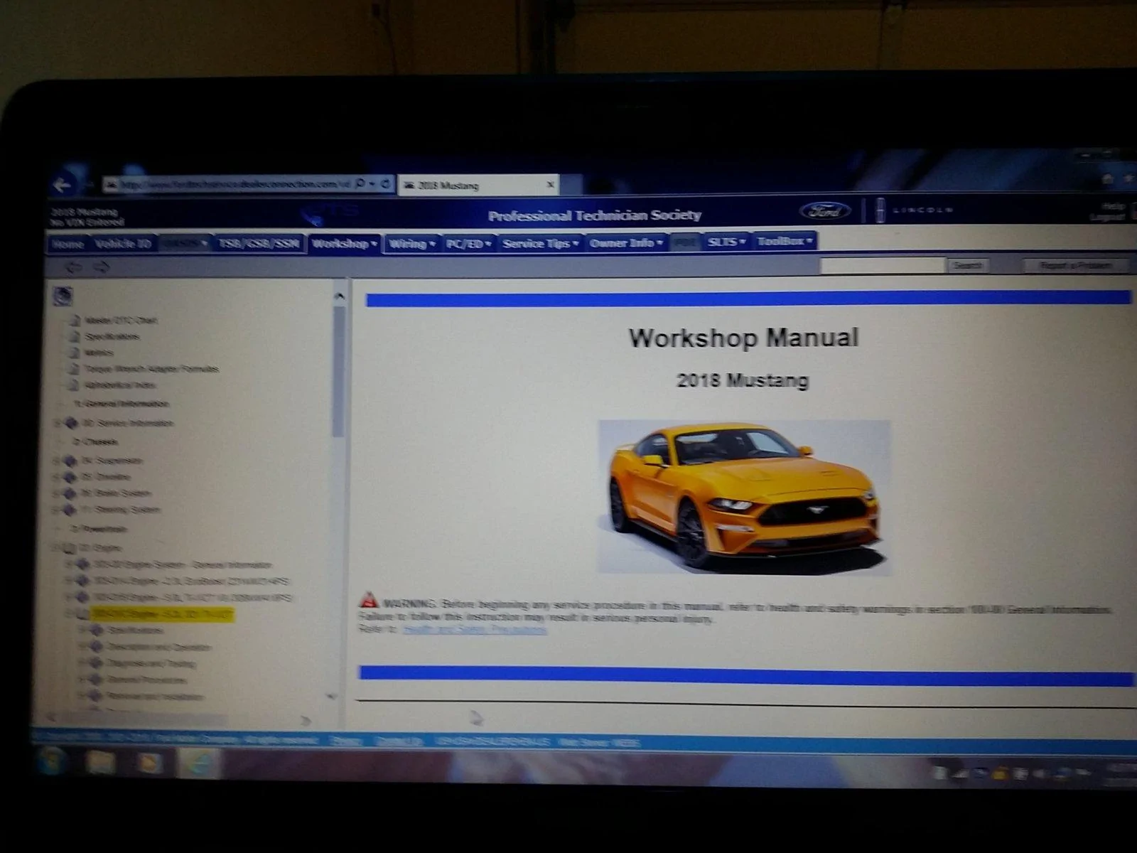

The manual states the same , but ther is no corrective action . Point is when a technician runs it to bid something that is questionable he /she should reach out for an answer . Maybe I am not like most ,but to the op I would like an answer so I can explain why tis is normal .
