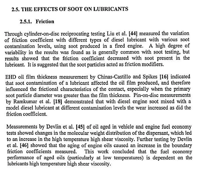

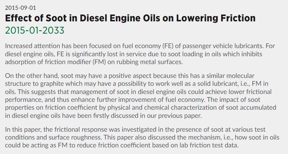

I spent some time looking for technical papers (SAE and similar) that talked about nano particles such as soot or carbon black, etc changing the cavitation sensitivity of oil in journal bearings, and found absolutely nothing associated with that. If you have links to technical information verifying the claim then I'd like to see the information. Otherwise, it's just a statement made with no backup technical information to backup the claim.
I did however find some technical information that said that nano particles such as soot, ceramic, carbon black (used in XL-17), etc act as friction modifiers. So seems once again that the engine ticking coming and going is more related to the oil friction level than oil cavitation. As we've mentioned before, it could also be a combination of parts clearances sensitive to oil friction level and oil cavitation.
I also found a study that talked about ticking and oil cavitation in the cam bearings of a diesel engine. Cam bearings are not loaded nearly as much as a connecting rod via compression ratio and combustion, so it shows that it's possible to have bearing cavitation simply from the bearing design, operating conditions and oil supply pressure (which was a big factor in that study).

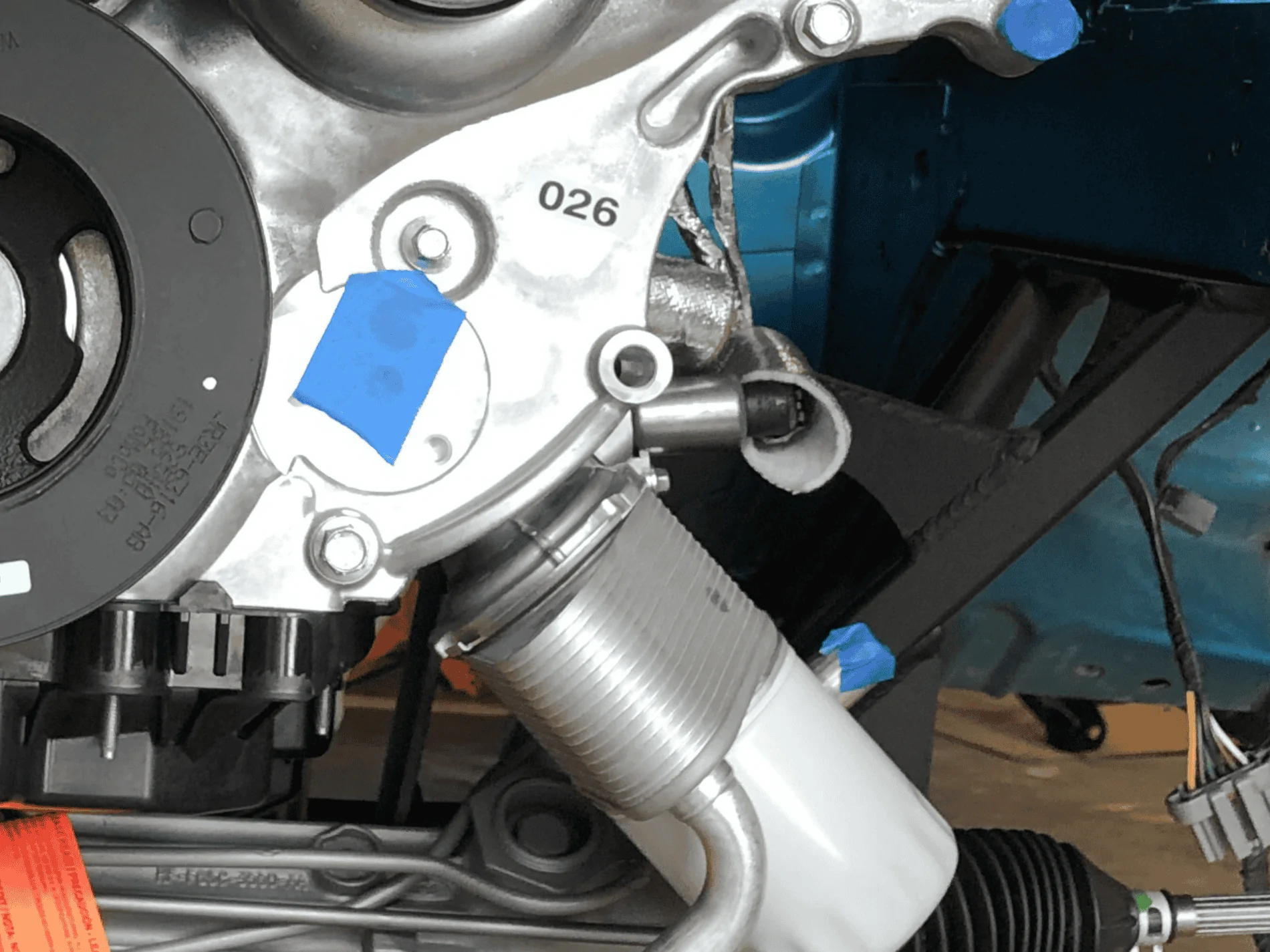

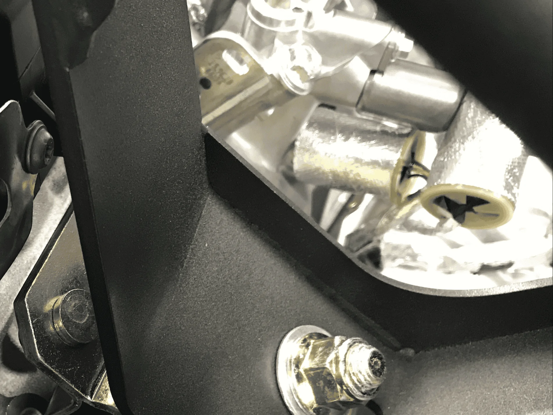

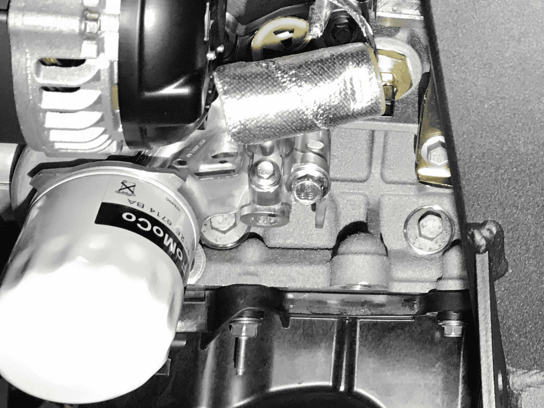

Can anyone confirm there's a pressure control signal or solenoid in the block? Surely the oil source causing this tick wouldn't be driving through an external line.
Even if the solenoid operates in reverse "close if fail" terrible logic then we can still just remove it and cap the hole.
Hivel
Jan 2, 2018
249
105
NorCal
Mustang GT
IF there's a valve there has a to be some indication of control on a schematic in the FSM. I haven't dropped the $130 bucks for that yet but thinking about it just to check this.
Confirmed. Here’s a few images of it.
