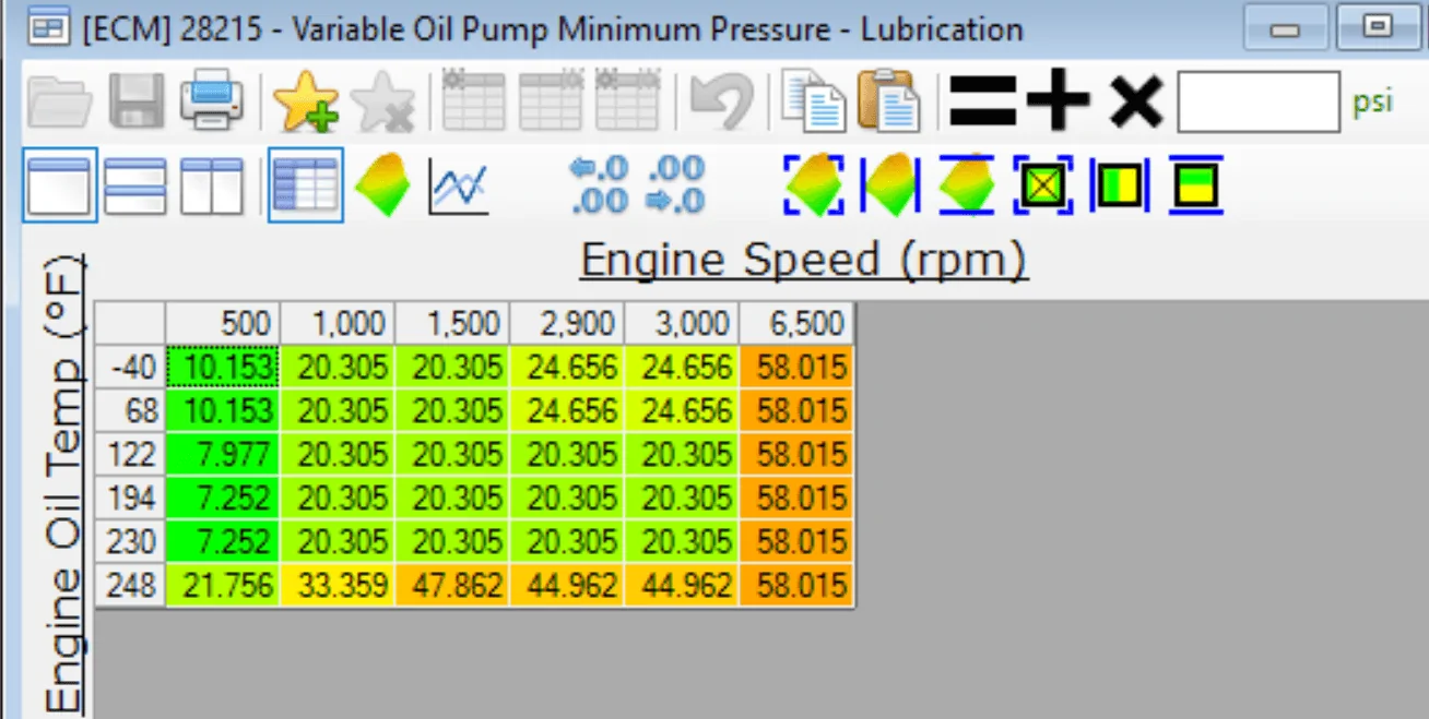

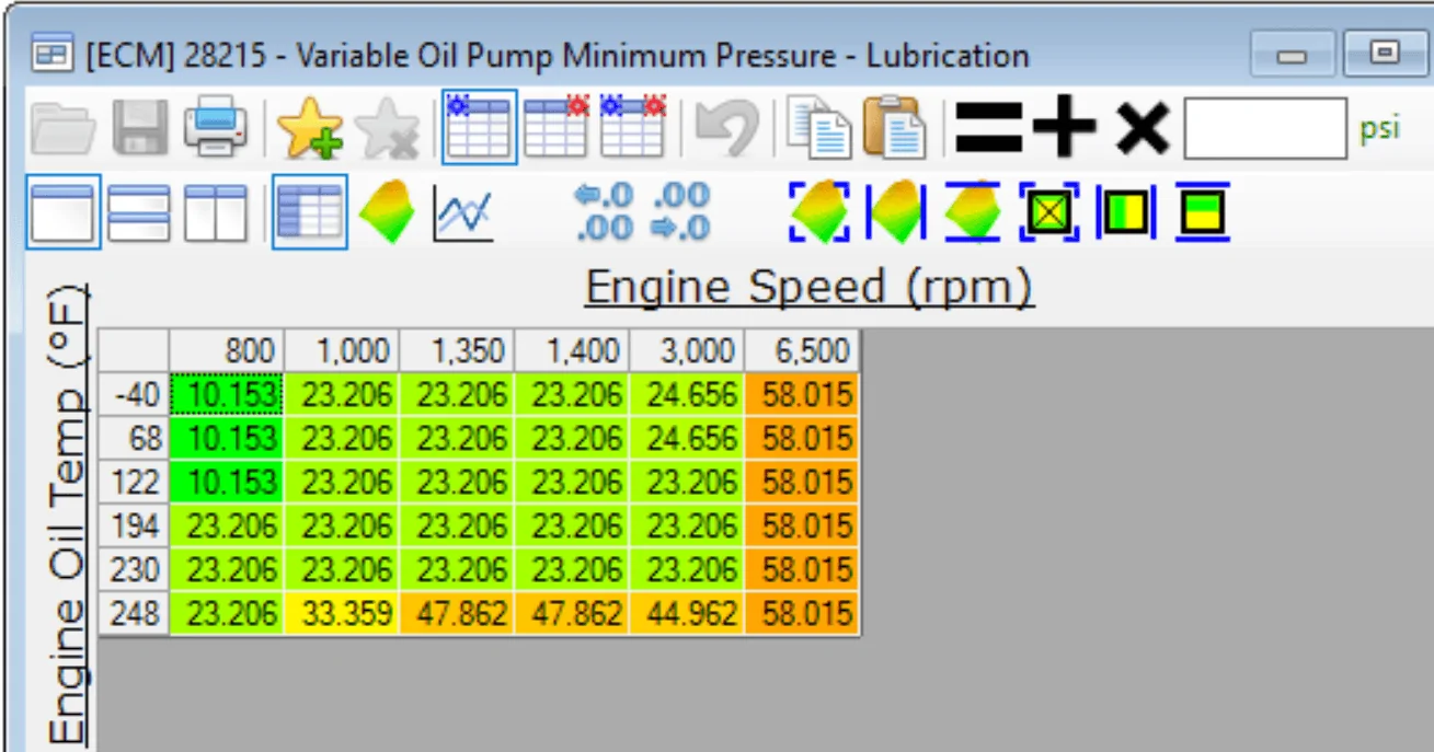

According to the map a few posts up, it should be 8 psi till it warms up then it switches to 20-23.
Never seen 8 on my gauge
Ever under any condition
Think I have a bad gauge?
