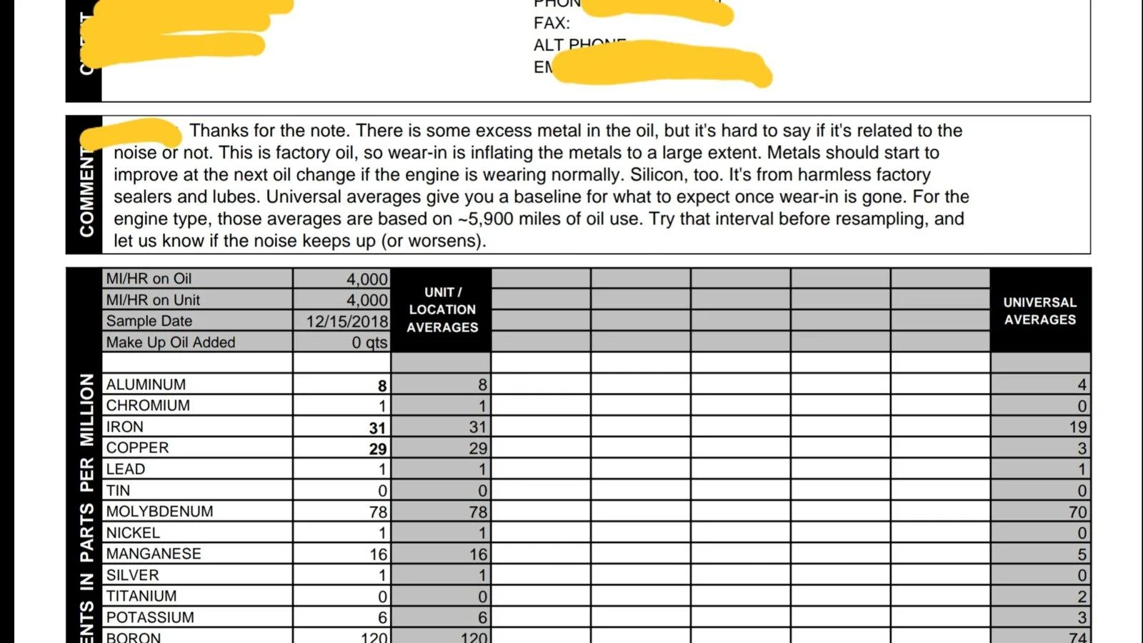

These were the results of my first oil change and test at 4k miles with both the tick and the 2k rattle. At 6k now and havent heard the rattle but really haven't been listening too hard either.
The iron and copper in my factory oil were at 23 and 24, respectively. This was at ~1500 miles. By 7000 miles the cam caps and main caps were shot. Hopefully the excess metals in your oil are indeed from wear-in.
Did you get another test done after the first one to see a difference? Planning on siphoning some out soon to get another test done in between changes.
I didn't. Took it in before the next oil change and the dealer confirmed there was metal throughout the motor.
