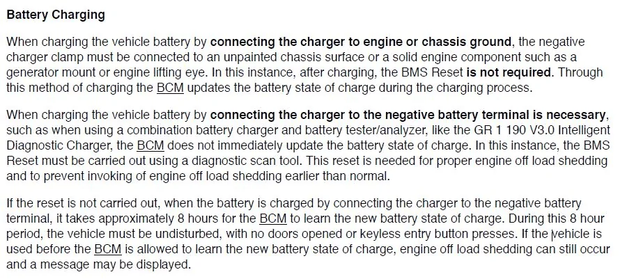

There is a thread here somewhere on the subject...You need to take the neg from the strut tower to bypass the cars intelligent battery software per the owners manual supplement.

Any reason you don't want to hook the battery charger to the positive of the fuse box and negative to the shock/strut tower ground?

I then connected the Ground Wire to an existing Ground Post located the Passenger's Side Shock Tower. Any chassis, body or block ground will do as long as it keep the Battery Management System in the loop. My Ring Connectors included a pigtail connector which is easily disconnected from the CTEK whenever I car to drive. Look for the orange connector at the lower left of the photo.

Yes, this was concerning. I pondered my CTEK Installation and researched for afar. I determined that the car the Battery Management System (BMS) will place the car into a battery preservation mode (Deep Sleep) when either the car has not been started for two weeks or the battery drops to less than 9.5v. What is Deep Sleep? My Ford Pass Application Message simply states that "Connectivetivity Is Temporarily Unavailable". This meaning my Ford Pass Application.
Now here is the good part... Five weeks later, I needed to confirm what was happening. I disconnected the CTEK (which was in full Pulse Mode at the time) and tested the battery with a DVOM to find a full 14.8v! I hopped inside and went to ACC mode to find NO MESSAGES and ALL FUNCTIONS and MEMORY INTACT.
Clearly my car was maintaining more than 9.5v, but no it had not been started for more than two weeks. My guess was that using the fuse panel 12v+ and body 12v- that I had not bypassed the voltage monitoring system and simply had not started my car for the designated period of time. If I had connected straight to the battery, my guess is that the BSM would have shut down more systems and triggered dash panel messages.
In summary, I think the only thing I am encountering is a lack of starting cycles when out of town. The BMS is doing it's thing by participating in the charging/monitoring process and I am convinced that the CTEK is the smartest charger/maintainer that I have ever used.

Here's how I did mine https://www.mustang6g.com/forums/th...to-your-s550-mustang-today.11109/post-3087711 but I have my + connected to the recessed terminal (closest to the battery). Seems to work just fine. Which one is correct? EDIT: From other posts I have read, the recessed terminal is the one the computer reads to determine battery charge. This line has a current sensor on it. So it may take up to 8 hours for the BCM to determine the battery charge level if another connection method is done.
