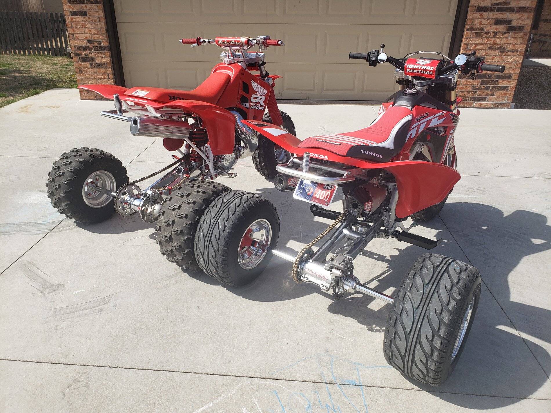

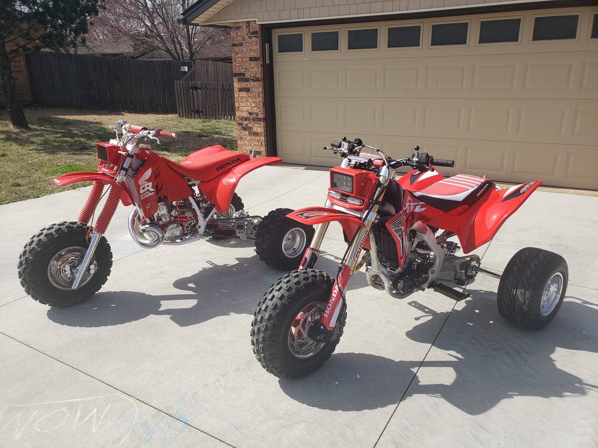

Well I started my passion on ATC's in the early 80's as a kid and got Stupid crazy into them in the 90s during hay days. Have had several of them in magazines. Attached is my current build (finished in spring) and my build i did 20 years ago. You either know how special these are or you don't really 'know' ATC's. The one i built in 2000 was a laeger CR500 conversion, and the one i just finished is a BVC 2020 CRF450L conversion......STREET LEGAL! The ATC250R in the previous pic is my almost complete 'resto-mod', basically an 1982 ATC250r with 86 front clip and 2020 rear-end/shock. Always wanted an air-cooled 1st gen and this one is nothing short of amazing, love how it turned out.

Drool.
As you're in OK, I assume you take them to Little Sahara?

Yes We go to little sahara several times a year and try and get to Glamis, CA every once in a while. While we started with ATC's and quads we got older and ride UTV's and sandrails now, but still kick a leg over the old bikes every now and then.
