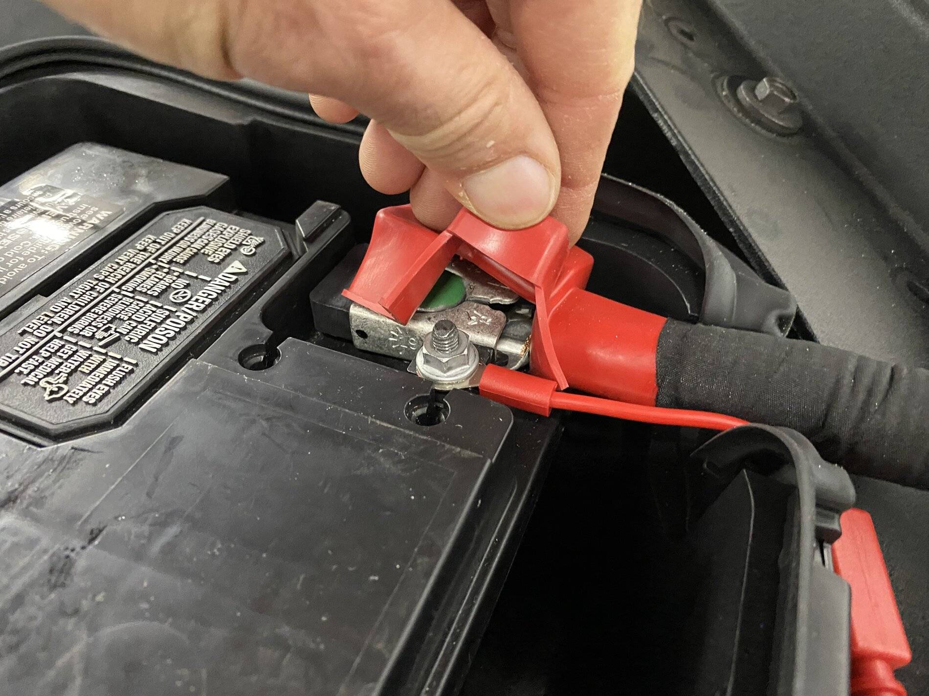

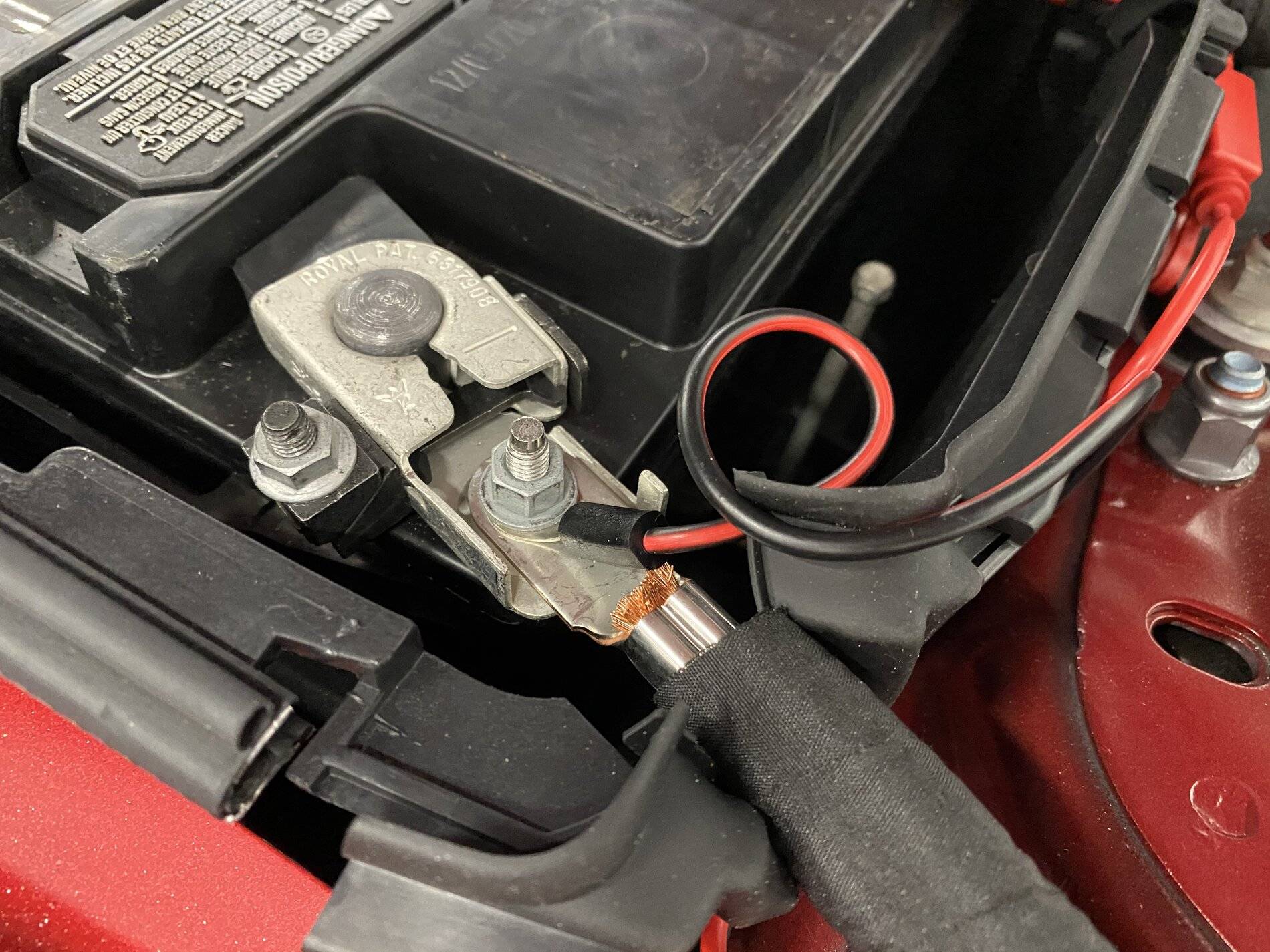

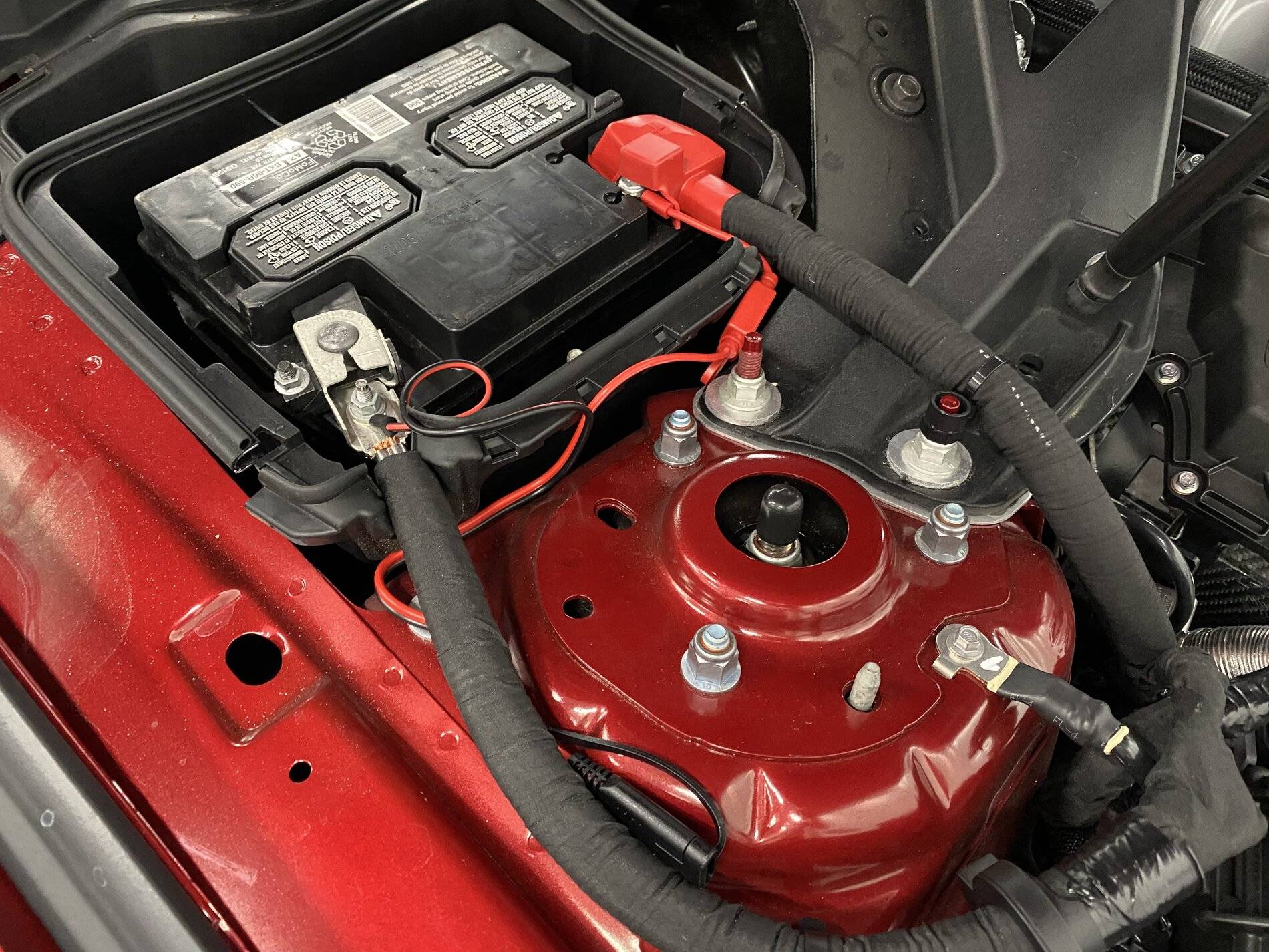

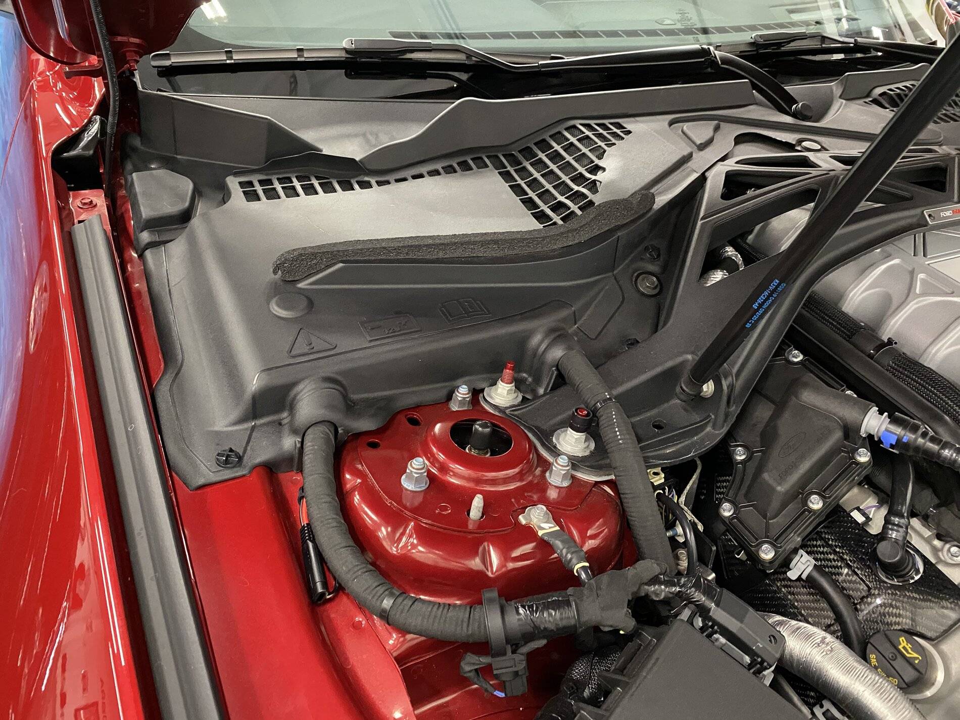

FYI, I permanently installed a tender lead many months ago and have used it every time the car is parked. I went the easy route and hooked it up directly to the battery. There have been zero issues... works great, lasts a long time. So what if it takes the computer time to see the new charge. The car is sitting/charging for awhile anyway.
I went with a 1.5 Amp tender to be safe, wonder if I should change it to this (4 amp).
Did you just cut off the alligator clips and then wire it directly to the terminals?
Most chargers include the tail/whip to connect directly like that. They were included with my CTEK MXS 5.0 and they’re an optional accessory for Battery Tender. F those alligator clips unless the battery is out of the car.
As mentioned above, the tenders that I bought have a connecting plug with two end leads for options. One has the spring clips and the other has posts holes for bolts. It allows me to leave the leads in place as well as the battery cover.

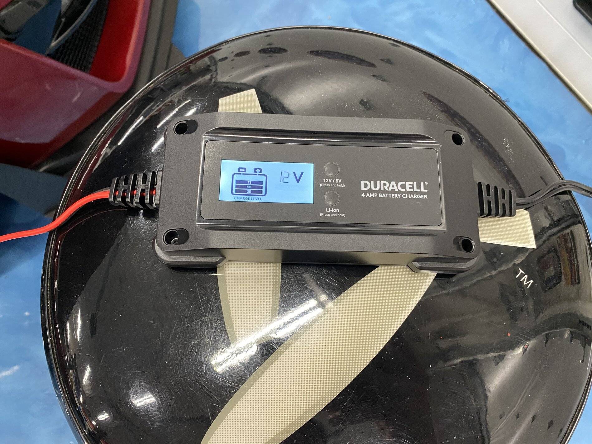

I have 11 of the ones I pictured above. They work great... no complaints.
Just bit the bullet and got it from Bestbuy for $39.00 Going to switch it out, Thanks for posting Tim, much appreciated.
