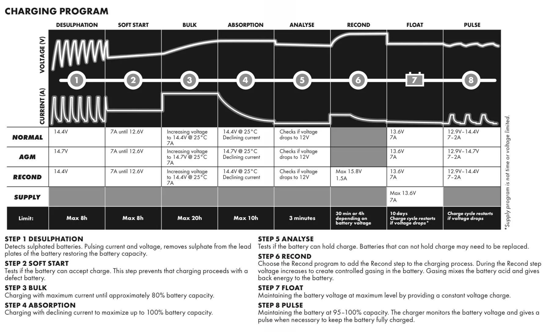

I just now placed the order on Amazon for the CTEK 40-206 MXS 5.0 BATTERY CHARGER. I have a question for you it says it has "different modes". What mode would you use when I store my car for the winter and it doesn't get driven or started for almost 4 months at a time???

Normal mode. Connect the positive to the battery, negative to a body ground that way the battery management system won’t be affected. Then plug it in and forget it. It will default to normal mode when you plug it in.
Mine stays on from November to mid April usually.
