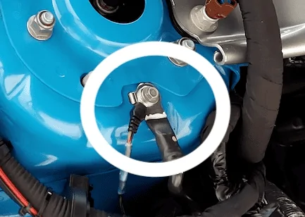

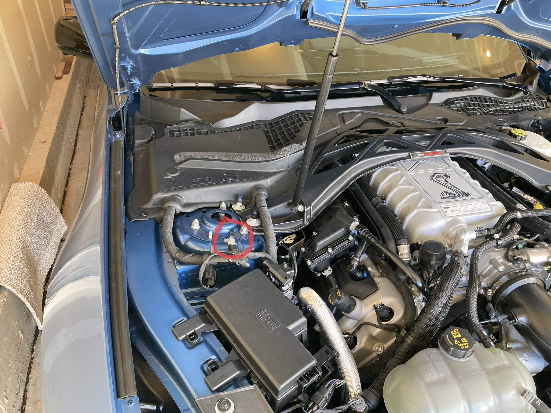

Can you post a photo of where you connect the negative black connection please???
It goes to the bolt where the battery ground is routed to on the forward side of the front passenger shock mount. Follow the negative cable from the battery and you’ll run right into it. The wire passes through a donut shaped “Hall effect” sensor.

I have a disconnect, available from CTEK, installed. You can see where I connected the negative.
I just got my CTEK MXS 5.0 Battery Charger today from Amazon. Now I'm ready to go!!! Just one last question. As long as I find a piece of "steel" close to the battery just hook up the Black Negative to that--correct??? I assume it doesn't have to be that exact piece. Lets just say I hooked it up to that bolt just to the upper left of that. The reason Iam asking if the length of the cords are not all that long. Sorry, for being so anal about it. I want you to know I appreciate your input and everybody's for that matter. I ended up going with a Ford Performance battery as when I called the Ford Dealership thats all they had. I live here in Omaha.
That will be fine.
