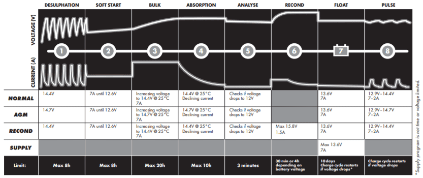

I have a MXS7.0 and although I cant say I have ever heard it buzz, it will make a cyclic ticking noise after its been connected for a while.
Looking at the charge profile :
And considering the time I have heard it, the tick most likely coincides with step 8 when it is pulsing current.
It's not a loud noise, you really have to listen for it (I would hazard a guess that my misses would tell me its silent and the noise is in my head ... :cwl: ).

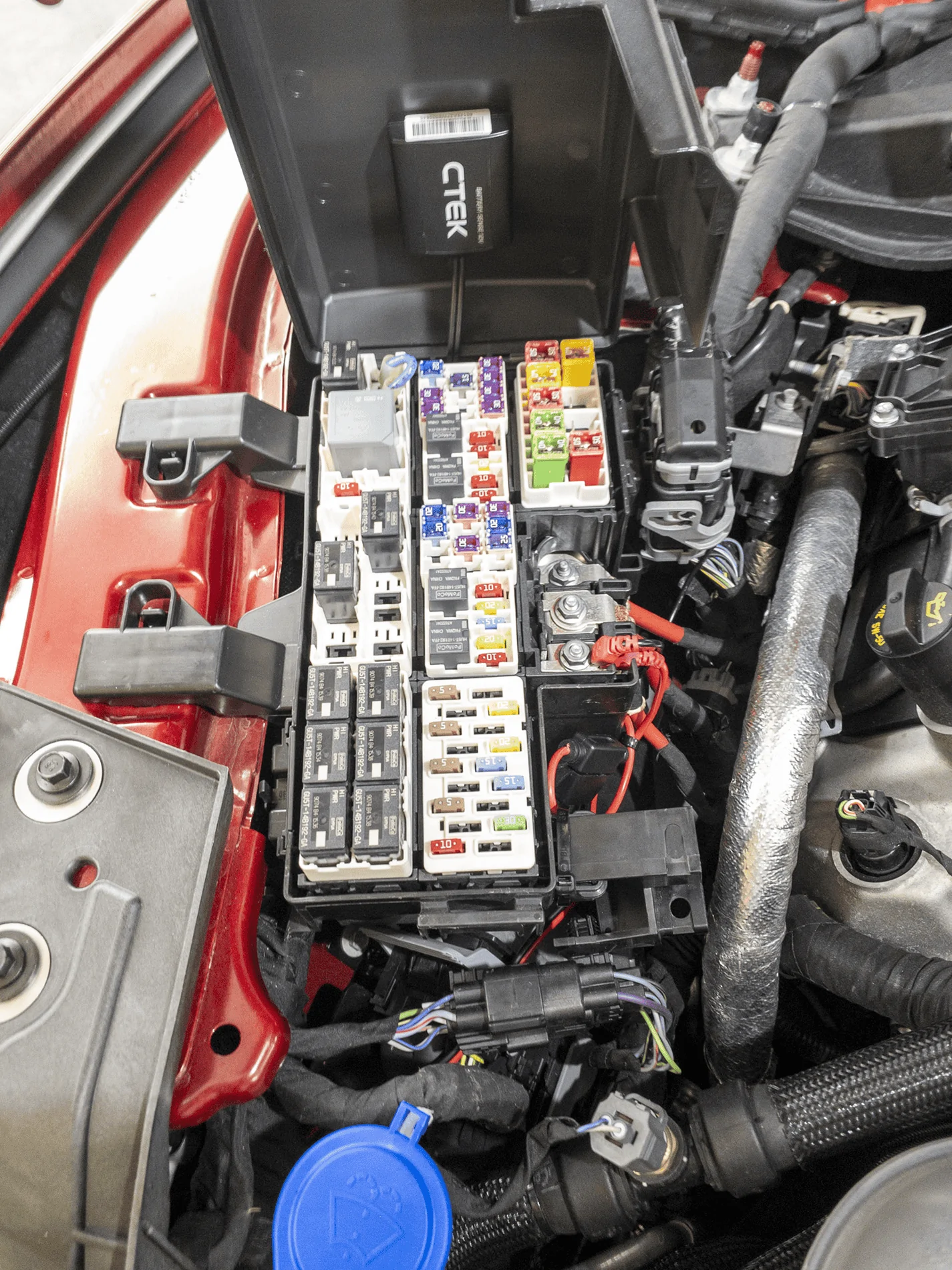

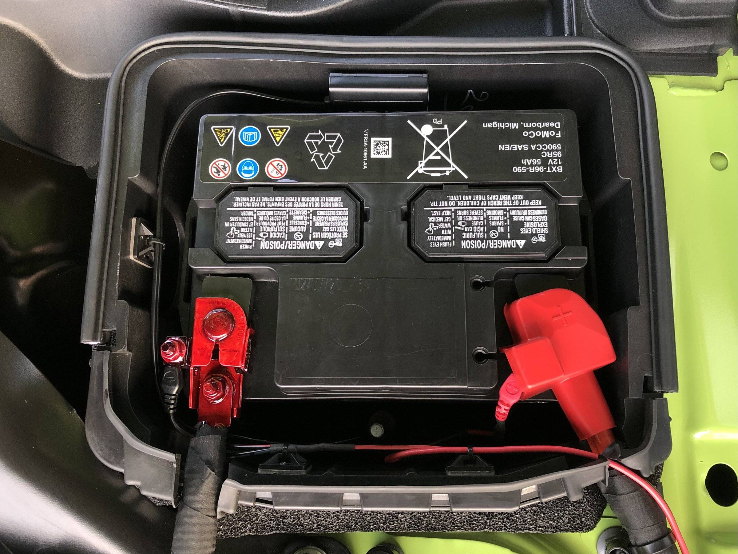

WD: There are undoubtedly very few mods that are as easy as the CTEK, including the Batt Sense module. That got taped to the inside of the fuse box lid.
Obviously, the battery tending is the Prime Directive and it does that extremely well. The bonus stuff is nice, like BT, but I rarely look at the BT data as it's always at a hundred percent.
Yes, I have an iPhone and no, I don't leave the app open. When I need to look, it just works.
Here are a couple photos...and I did use the negative at the fuse box, not the battery.

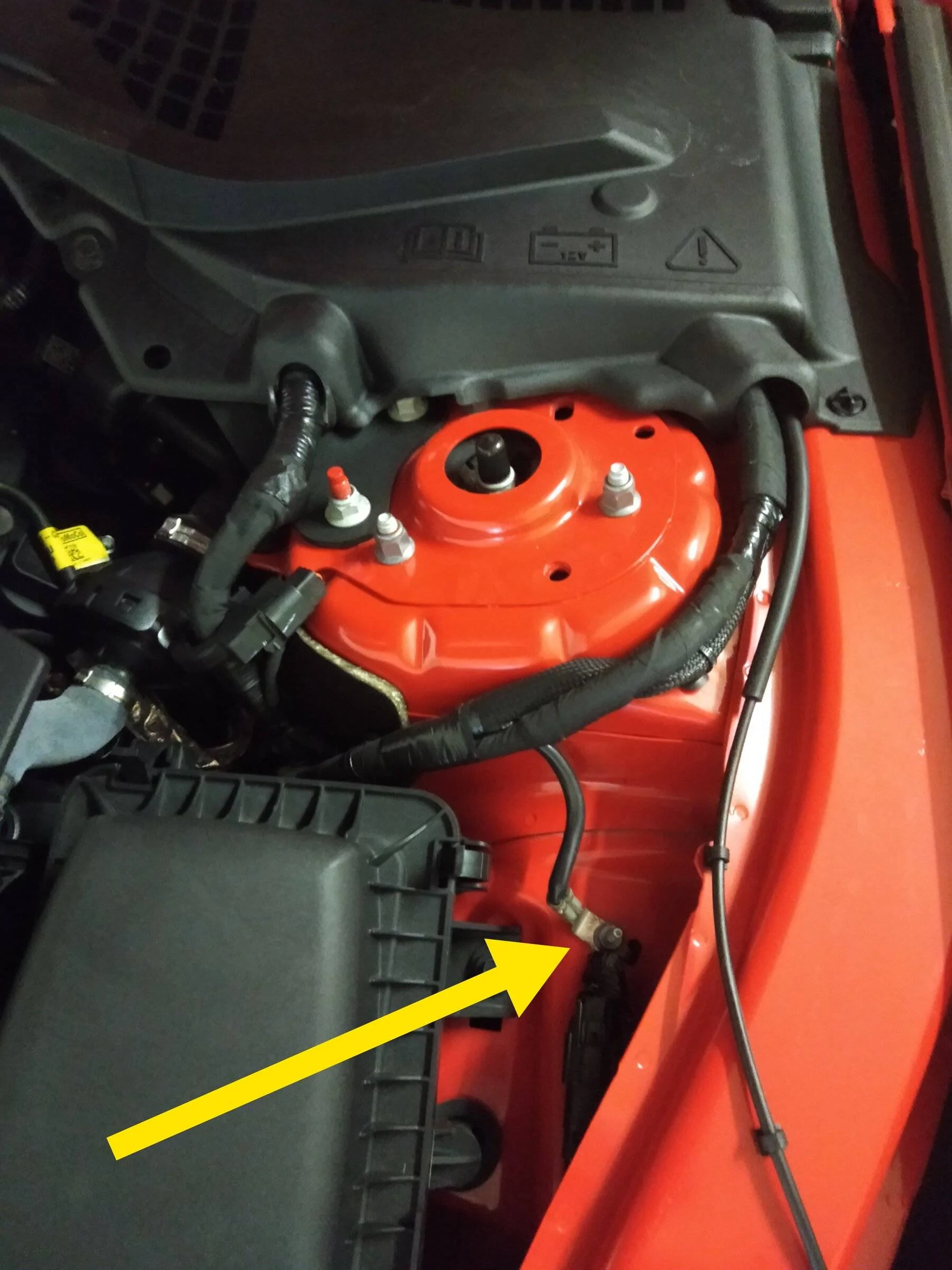

Quick question from Down Under (Australia). Our battery is located on the Right-Hand-Side of the engine bay due to the steering conversion.
Is the best place to connect the battery charger Negative (-) to the following? (See Picture).
I believe this is an Engine Ground. Please correct me if I'm wrong?
Was planning to connect my CTEK MXS 5.0 charger to the positive battery terminal and the negative to this Engine Ground.
Will this impact the BMS? Thoughts?

Those would be the correct connection points for right hand drive cars. :thumbsup:
Thanks @StangTime, I really appreciate the fast reply! I also confirmed the following;
"When charging the vehicle battery by connecting the charger to engine or chassis ground, the BMS Reset is not required."

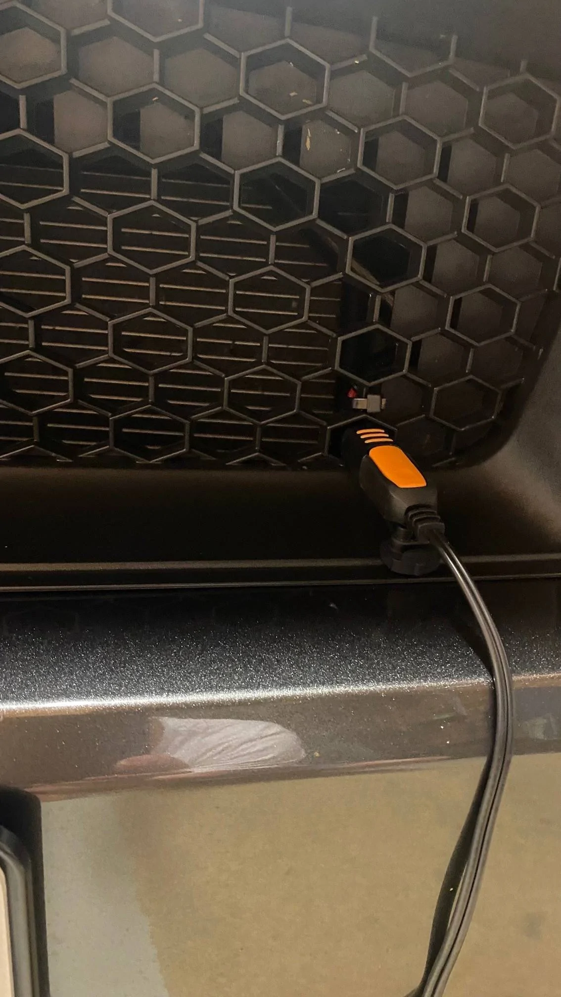

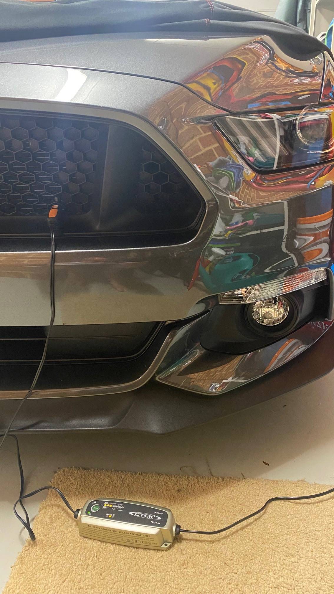

Just to throw another idea in the mix.... I've taken the CTEK quick connect out the front. When the charger is disconnected the quick connect has a rubber cover that neatly covers the connector to make it water tight.
I've also attached directly to the battery. The Load CT's are generally only interested in what's going out of the battery for checking battery health and load checking. If I was connecting any new devices or loads then I would make +ve connections at the Fuse box and not direct to battery and ground direct to chassis.
A battery charger is just fine sitting direct at battery terminals as it only increasing the state of charge direct at the source and holding a float charge. Not on when car is running and not drawing a load that the BMS needs to monitor.
The Negative connection point I've taken direct to the connection bolt on the negative cable and the positive I've taken to the bolt exactly as per Goose17 has done. I did however sand/file the black paint off the shims the bolt goes through as I wanted to ensure a better electrical connection

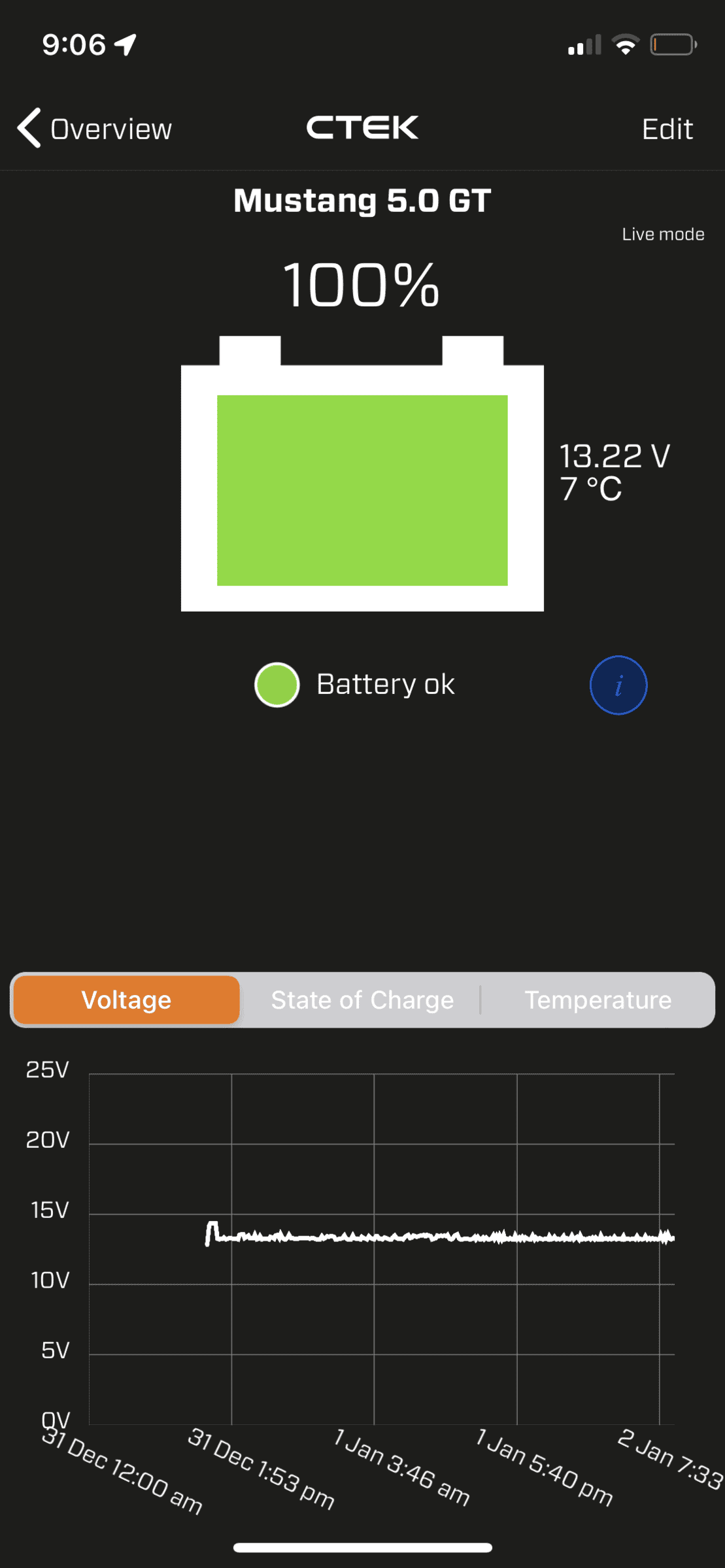

Just updated my installation to include the Sense unit :

But seven Celsius is a bit chilly, WD. MOF, the temp dropped thirty degrees here last night and at the moment, it's 7 Celsius. :-) But we'll be back up in the twenties in a couple days. Meanwhile..
You'll love that CTEK rig although I find that I never use the BT capability. But, I don't have to hangar my girl for the winter so she's never on it for more than a week or so. I've only seen the last light, whatever it's called, once.
