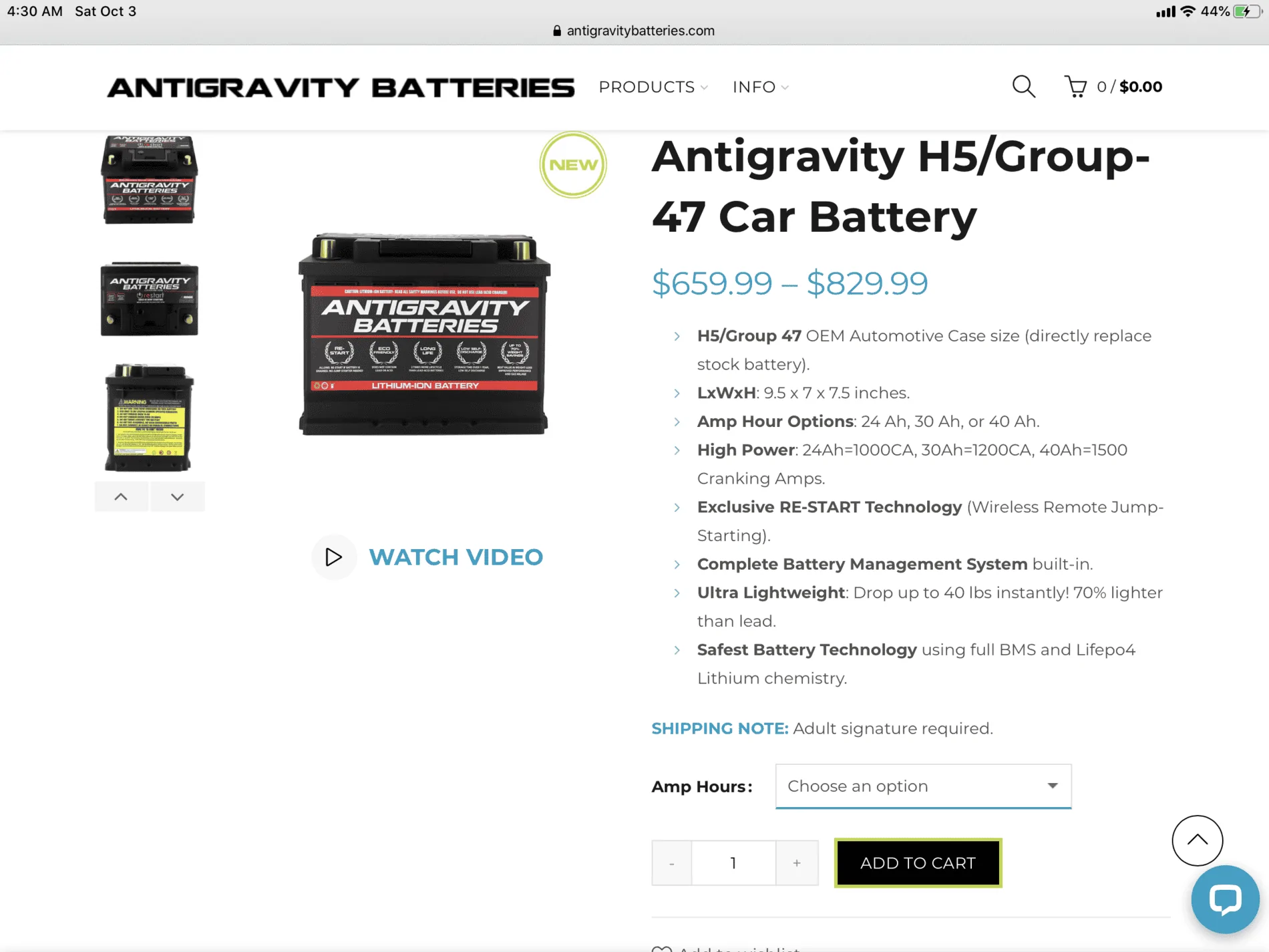

I have used antigravity batteries for years in motorcycles with no issues I have called the before the engineer recommended the H5
Which you would not have to battery tender the more ampree hr is for your cold starts the battery also comes with a emergency restart if u ever needed a jump the weight savings is about 40 pounds. this savings is great considering your reducing the enter of gravity of the 500 which is better for handling
How much does the battery weigh? It doesn't say. I know how much the 500 battery weighs. I dont think you are saving 40#.
Also, the restart technology was a problem with the GT350 electrical system. I dont think the 500 system is different. Antigravity thinks they might have corrected the restart feature so it works with our cars. I felt so strongly that the ATX-20 did such a good job and that restart was not needed that I opted not test.
Anyway, get back to me on the weight of that battery when you can.

I just did a little more digging on the antigravity site. They say the H5 can weigh between 8.5 to 16.5 pounds.
The oem battery weighs 27 pounds. If you opted for the H5 40 amp hour battery, that would be a weight savings of about 10 pounds. If you went with the lightest 24 amp hour battery, that would be a savings of 18 pounds.
The ATX 20 HD weighs about 5 pounds. Weight savings is about 22 pounds.
I't too tall to fit correctly under the cover!!!

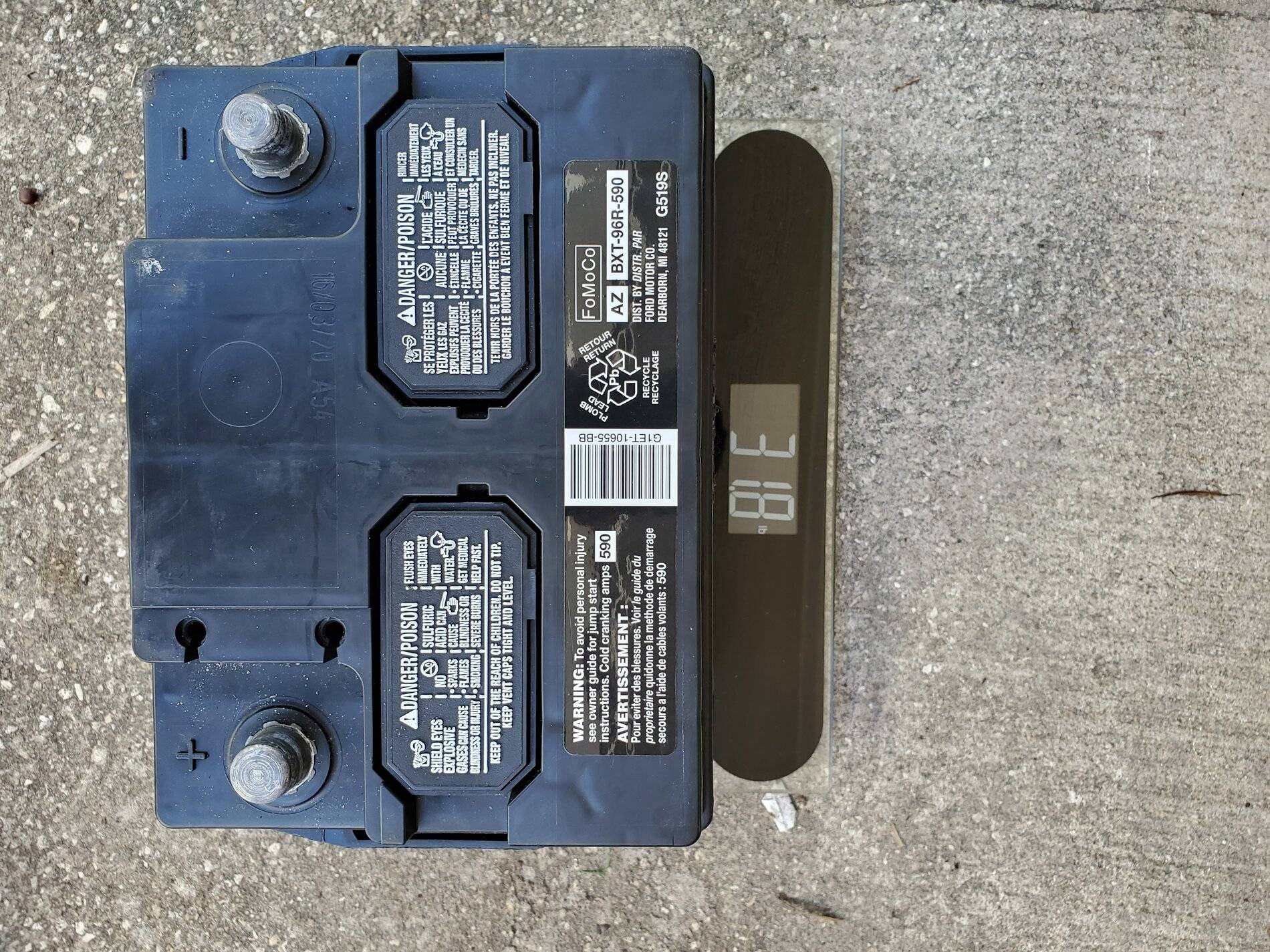

Just to be clear and correct....Gt500 stock Oem battery weighs exactly 32lbs
I weighed it. I think it was 27.
I stand corrected, 31.8. More of a weight savings I guess.
