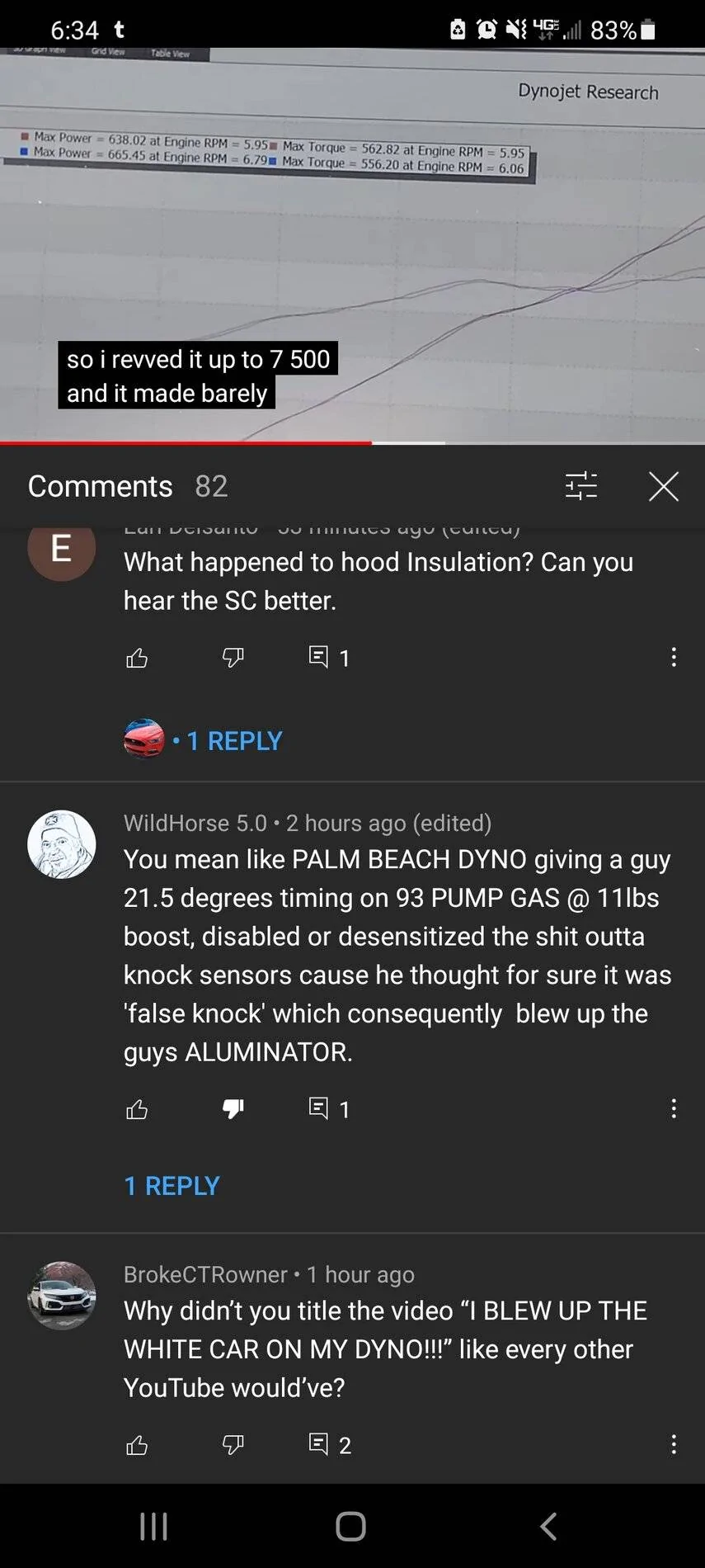

Going after me on YouTube now lol.

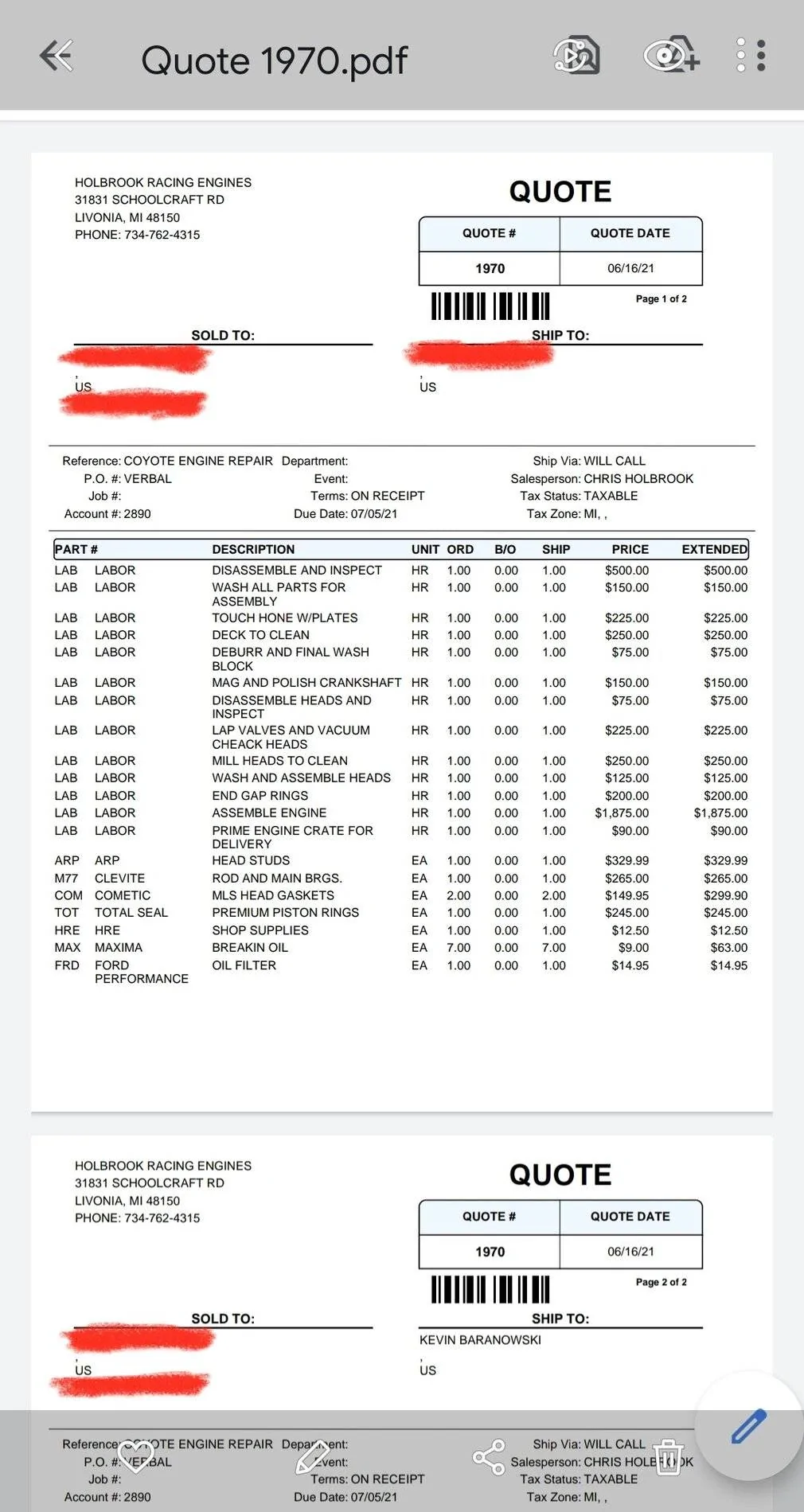

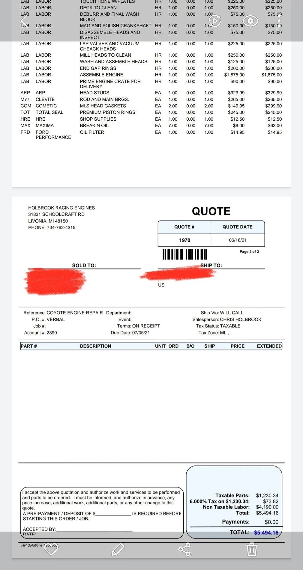

Just received the quote today on repairs. It is what it is.
