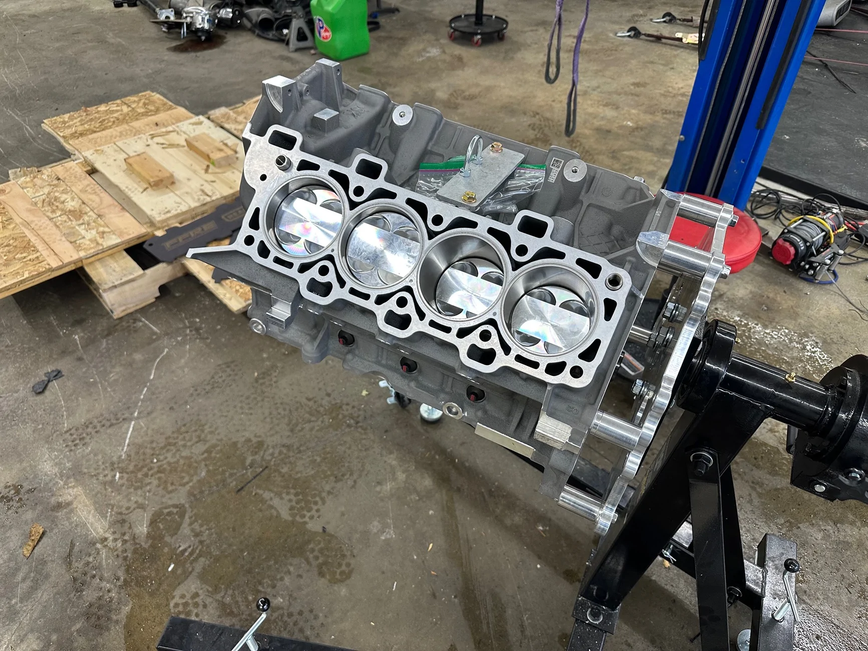

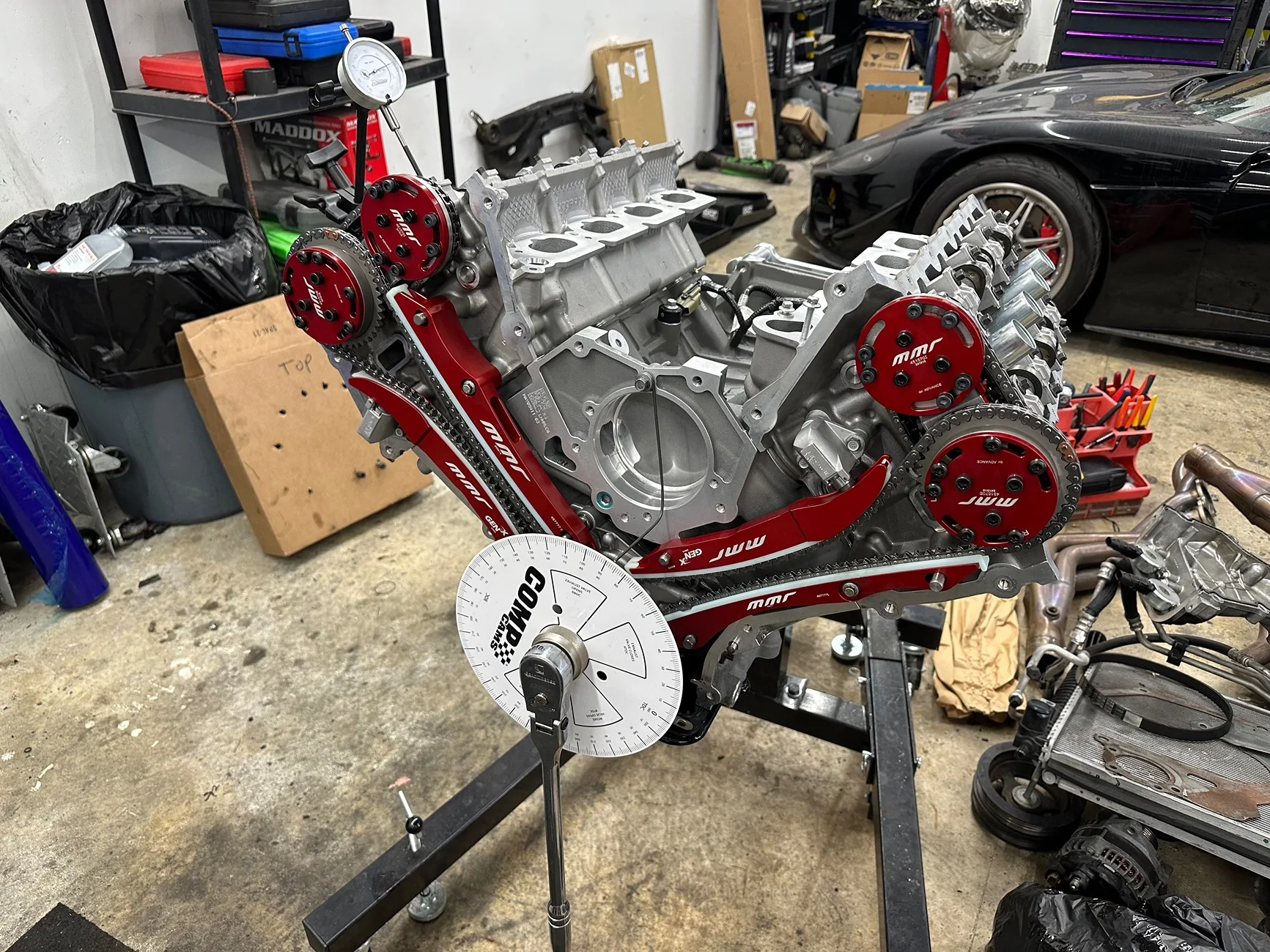

FFRE stage 3 short block - all buttoned up with MMR Timing - redid the gen 2 heads with Ferrea valves - PBH 6r80 1000hp kit - billet planetary - Vortech V7 YSI. Went all out on this one..
